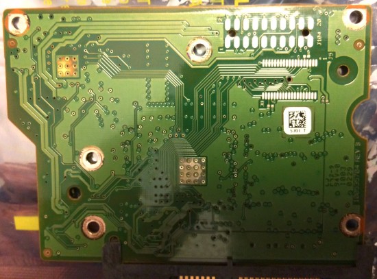

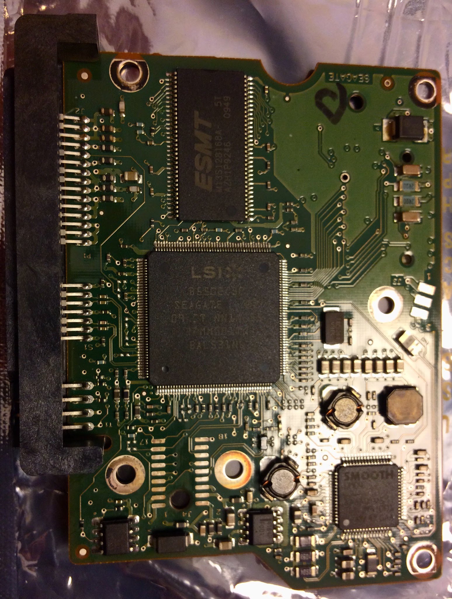

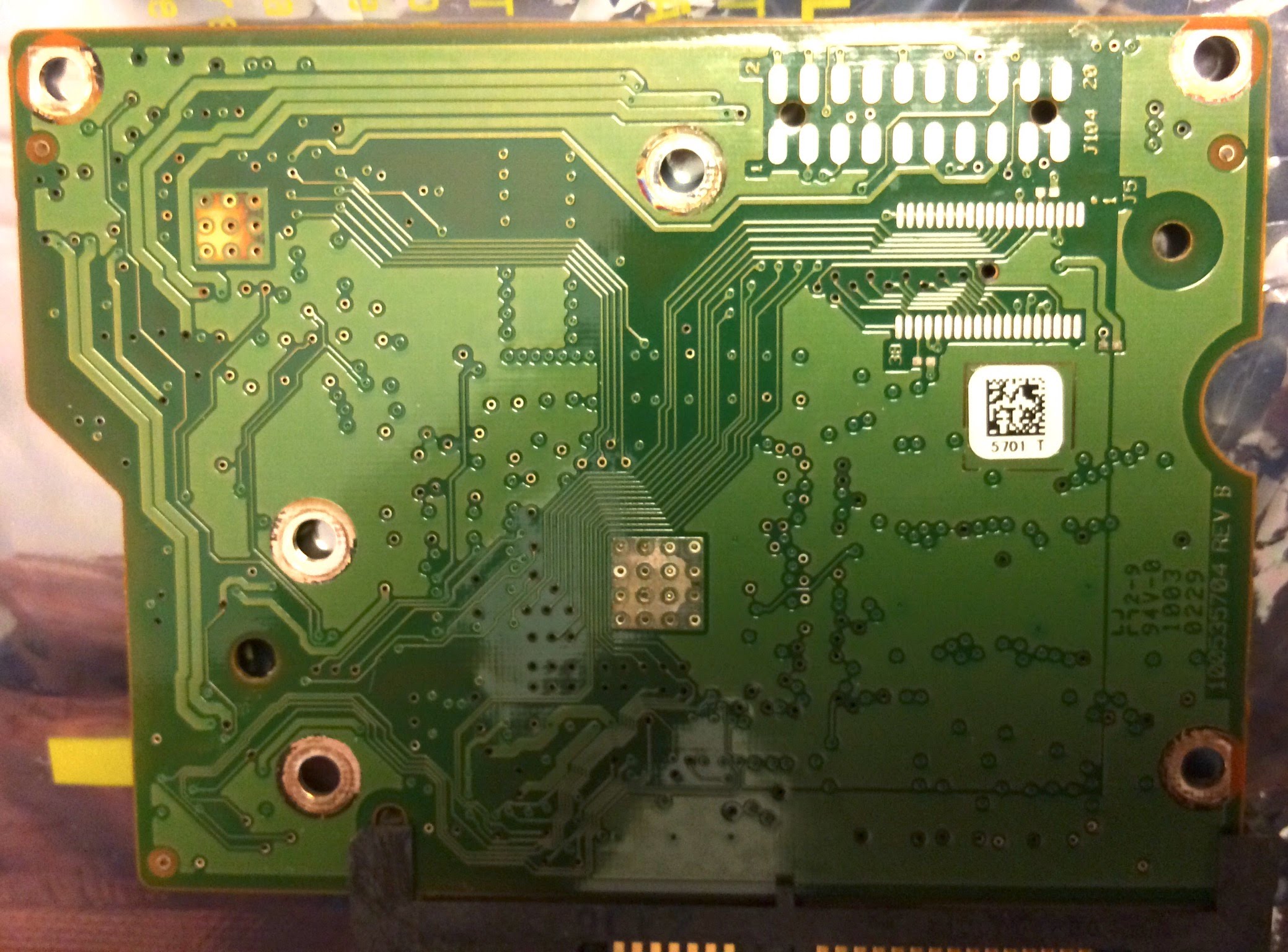

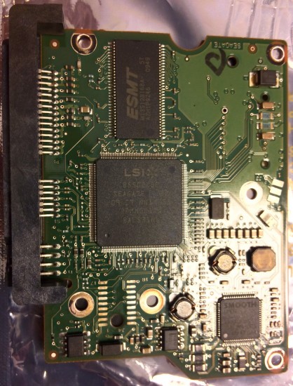

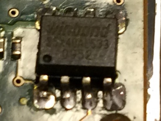

Original board shown. I didn't see a point in showing the replacement which has the same p/n & Rev. despite some different components and a mfr. name (Dynamic) and p/n.
Can't really read all p/n's in cellphone photos so just note that the only discoloration is tarnished silver plating. I only cleaned (white Staedtler drafting eraser) the areas that mate with the motor contacts and the DIL connector on the hard drive chassis...potential ESD source but I couldn't see another way to do it...

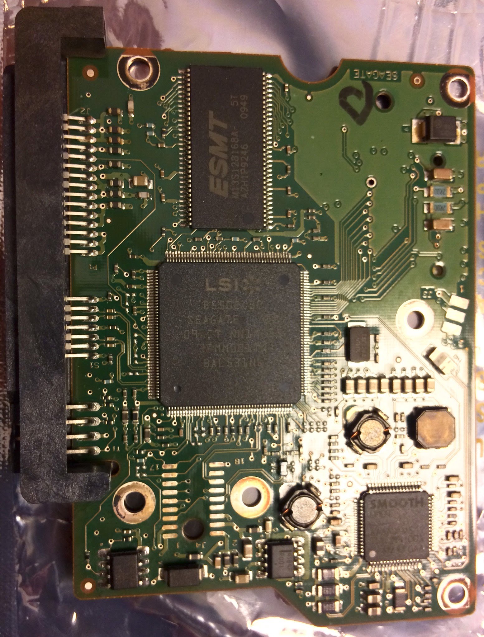

slightly different illumination

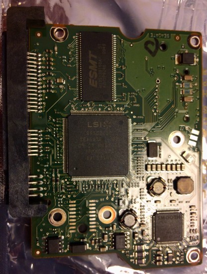

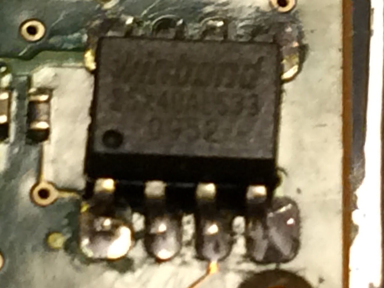

The "O" written on the board is for 'Original' (how original!). "R" on the "Replacement".
Can't read memory marking but it is "25X40ALS33".
That's lousy soldering for me, but it's good enough.
Hopefully power up Monday night.
