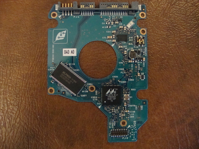

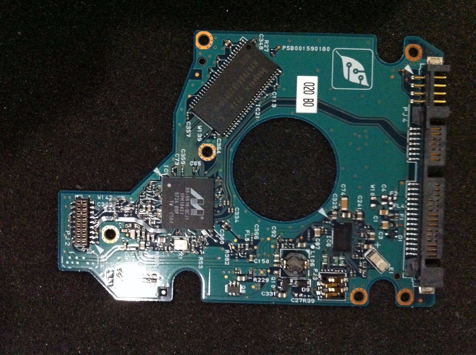

the pcb for this hard drive is expensive and this way its not so expensive
would you be able to identify alternative points by looking at an image pls
uploaded images taken from google
 Post subject: Re: mk1032gsx pcb alternative solder points for POWER and DA
PostPosted: December 4th, 2017, 12:05
Nothing in those pictures suggests damaged solder pads, it looks perfectly fine. I'm pretty sure you're just misdiagnosing what's going on here.

this is not my board
my board has pads missing
i upload this photo from google so that someone can give me alternative points

PostPosted: December 4th, 2017, 17:12
Posts: 17324
http://pinoutguide.com/visual/gen/serialATA.jpg
http://pinouts.ru/visual/gen/sata-power.jpg
PostPosted: December 4th, 2017, 18:07
Posts: 713
Location: Brazil
The sata pins you solder to those curvy traces that go around the hole in the center.
The power pins you solder to places near D1, F1, etc.
Really, if this post is not a joke, we need pics of your board, not of someone´s. There are not "alternate points", but to direct you to a place to solder, we need to see what is damaged and what isn´t.
