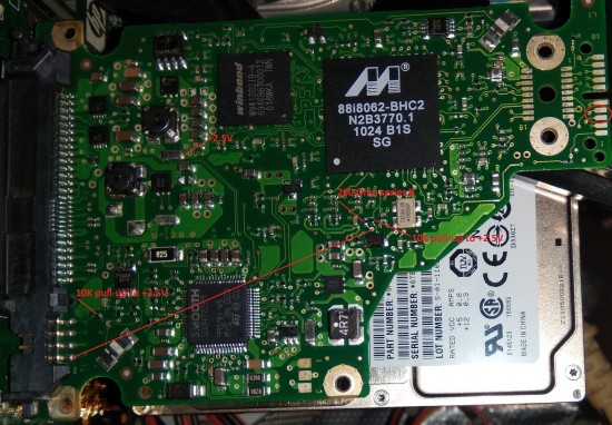

Does it makes a sense to replace the PCB on this drive (both drives have the same boards, so I know where I can get one working PCB :) )?
Basing on a photo I found on the Internet, there are Marvell 88i8062-BHC2 controller and 4Mbit SPI flash on the PCB.
Is it enough to replace only SPI flash chip from the old PCB, or this Marvell controller has its own flash?
Both drives are running the same firmware, but I'm concerning about adaptives and other unique stuff.

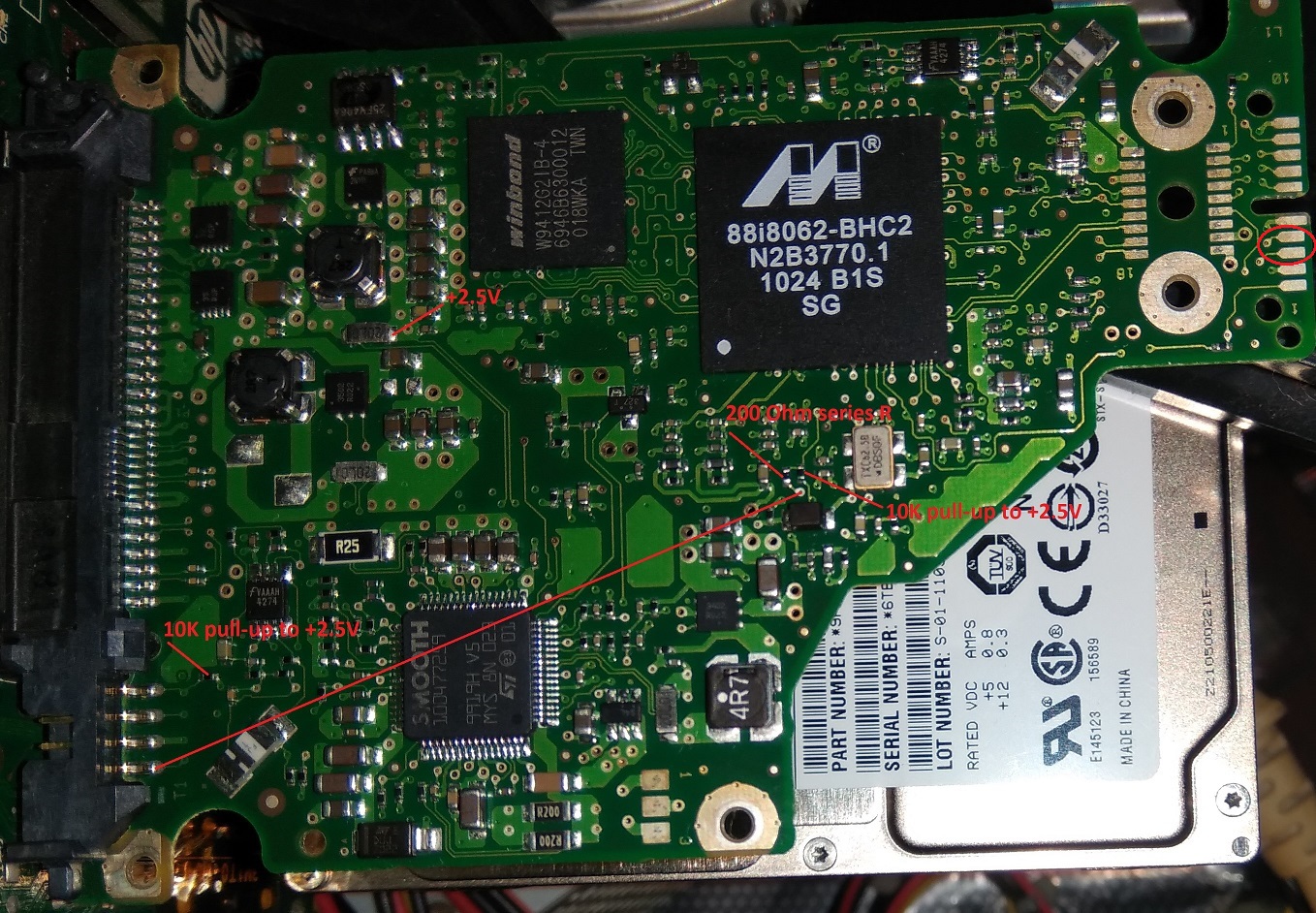

There is a 4-pin connector similar to those on Seagate SATA.
All pins are routed on the PCB and supposed pinout is the following (I started to count pins from SAS data connector):
1 - routed to the main (probably) chip, have a 10K pull-up to +2.5V. Only low-side clamp diode is present, so this pin is supposed to be 3.3 or 5-volt tolerant RX. Also it is connected to pin 4 of the 10-pin board edge connector (that one with a notch in the middle, near the heads connector).
2 - routed directly to the main chip, no pull-up and only low-side clamp diode is present. Supposed to be 2.5V UART TX. Also connected to pin 3 of the board edge connector.
3 - GND
4 - routed to the main chip through a 200 Ohm series resistor, have a 10K pull-up to +2.5V. Similar to other pins, no high-side clamp diode for this input (?) inside the main chip. Maybe I should short this pin to GND and see what changes. But I didn't tried this yet.
I monitored pin #2 (as well as other 2 pins) and it is always high. No activity at all.
Looks like UART is physically present, but terminal commands are either disabled or not implemented in the firmware.
I'll try to add a jumper between the pin 4 and GND, but maybe no earlier than this weekend.

Posts: 17097
You could invalidate the flash memory (by shorting an appropriate pin), and then see whether an error message appears at the UART port.
