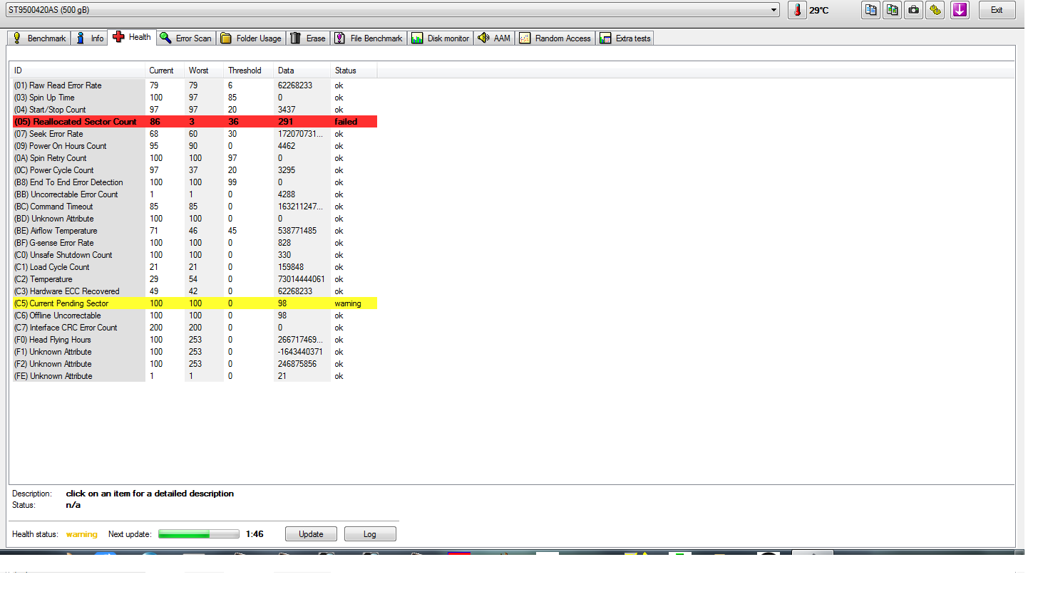

I have St9500420as which is detecting in bios and in disk management as raw.The smart is indicating GOOD.but there are bad block in 0.well i need data, i tried to image the sad hdd but it was imaging in bytes some time in kb.i tried this

only F"MediaCacheControl",00,22 doesnot apply it me an error.Can u Gurus guide me Please?

What tool are you using for imaging?
Have you tried to read from different areas?
Have you tried to image head-by-head?

Have you tried backward copy for instance?

Attach the log from hddsuperclone. I can analyze it and perhaps give some insight on what is happening. I prefer a log that was started from scratch with hddsuperclone, as importing a ddrescue log can make it much more difficult to analyze.
