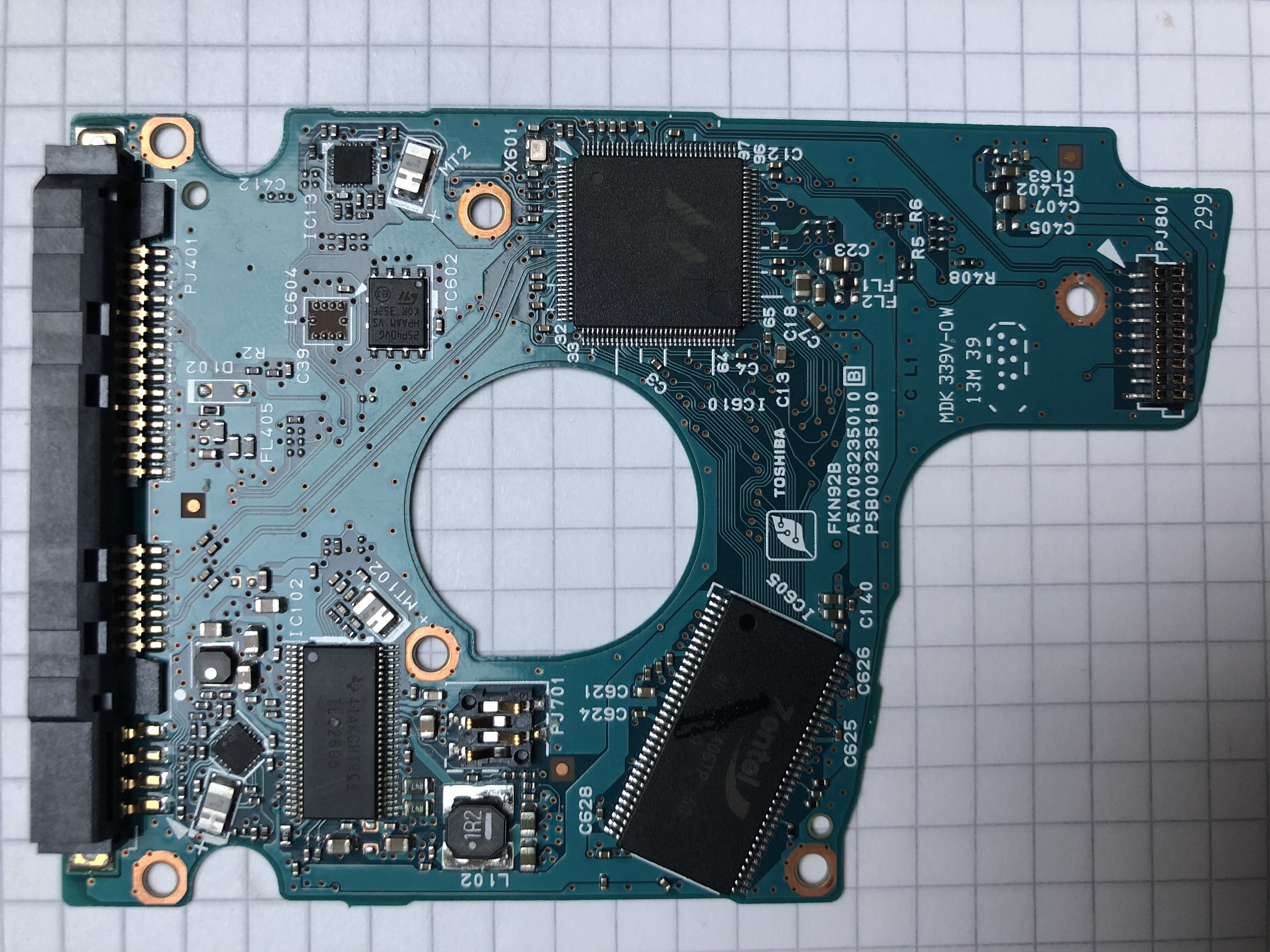

I have a Toshiba HDD that wont spin correct. There are no clicking-sounds, the Drive just Spins up a Little Bit and then spins down immediately. I have checked the Voltage at PJ801. 5v and ground.
The PCB itself looks fine, no burnt spots or missing components. Can anybody give me a tip to bring this drive back to live? Soldering is no problem. Do i have to order a Donor-PCB or is there a chance to get around ordering one? It would be fine to Recover the data from this HDD.
Hope to get some help...
Menz

Buy new board and resolder ROM (IC602).

If the drive spins up and spins down is a clear sign the issue is the heads (even media damage already) and nothing wrong with the pcb, contact a real DR company will be the only chance to recover your data

I have seen these with dodgy PCB’s that cause erratic spinup and spin down.

What is that fleck over the "S" in the "TLS2605" marking on the motor controller (IC102)?
 Post subject: Re: Toshiba MQ01ABF050 Questions
PostPosted: December 19th, 2017, 15:46
Looks like a scorch mark to me

If 602 was burnt out, drive would be dead
Edit: ah 102 lol

Isn't the circuit above burned as well...or is it just glitch in the picture?

Are you referring to the 16-pin shock sensor amplifier (BD3851)?

The thing in IC102 looks a hole to me, also.
Maybe a piece of dust, or glue residue ?

There is a little Particle on TLS2605, nothing to worry about.
Any further tips? I can assure you that nothing is burnt or missing.

As stated, you need a board same model number, and transfer IC602 to the bad board to the new one.
Or, if data is important, send the drive to some specialized

The bottom motor pins look strange..cold solder joint?

Motor Pins checked, no cold solder joints.

Data recovery should start from simplest work. Replacing the PCB is simple. If it do not help then You need to find DR company.
