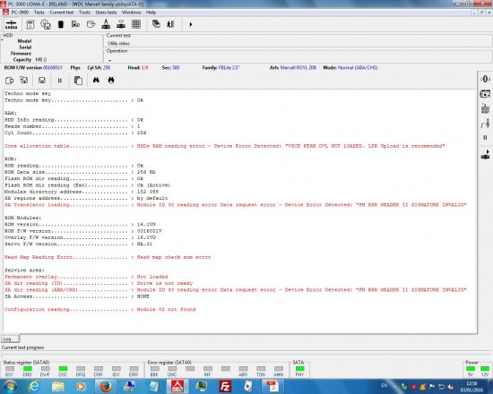

looking for the model name on this drive ... its not auto identifying in ace 3000
western digital blue WD10JPVX-22JC3T0
DCX 771933
DCM: EBKT2BB
date: jul 14
I'm suspecting FBlite as the utility is opening with that option?..
screen print of readout attached
 Post subject: Re: WD10JPVX-22JC3T0 - actual model?
PostPosted: January 3rd, 2018, 10:02
Posts: 849
16.1VG - FBLITE
PostPosted: January 3rd, 2018, 13:29
Posts: 428
You have erased ROM, adaptives, sa translator, writed from module 0109 propably.
PostPosted: January 3rd, 2018, 14:47
Posts: 17231
Could this drive be SED locked? If so, then see Ace's blog on the subject.
The ROM errors may be a bug. PC3K sometimes incorrectly identifies the active directory module (0x20B, 0x0B). If you upload your ROM, I could parse it for you.
PostPosted: January 3rd, 2018, 16:13
Posts: 849
computek2 wrote:
now to figure out what is actually wrong with it
most likely - "slow responding" due to a physically damaged area or a bad head.
PostPosted: January 4th, 2018, 3:48
Is the drive actually spinning?
I suspect it’s not, or it’s the wrong PCB.
