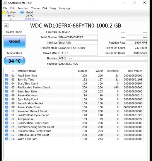

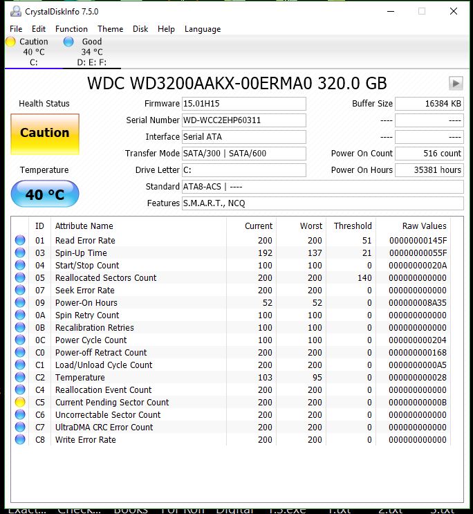

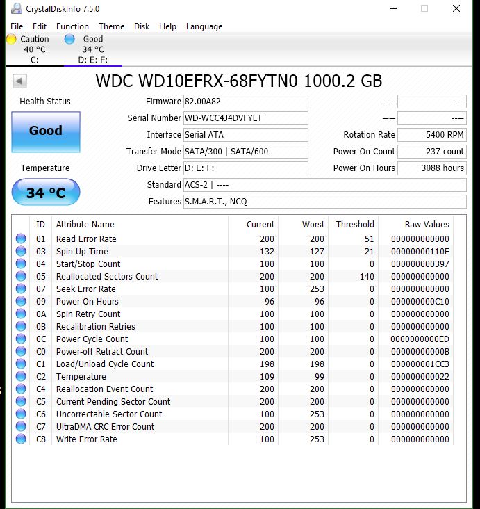

There are often high-pitched and screeching noises coming from the system block, and the system often shows errors. Can someone explain what the following figures mean?

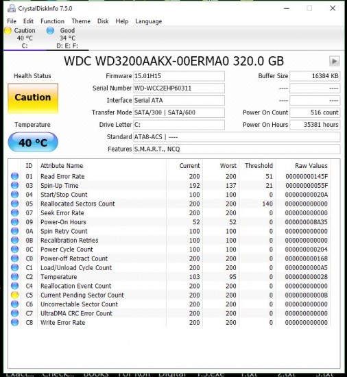

The 1TB is fine, the 320GB one has 11 sectors ("B" in hexadecimal) identified as bad (unreadable or readable with abnormal difficulty).
It's still a low figure (especially considering the high Power On Hours number), it can stay that way for a long time but it's recommanded that you clone it or transfer everything of value to another storage unit and use it for non-critical data from now on.

Thank you for the information. The age of the drive was shown in one software to be about 1,400 days. Perhaps that figure refers to the combined total amount of hours the drive has been in use. Since the drive is very old and did not load again, I have installed a newer disk.
