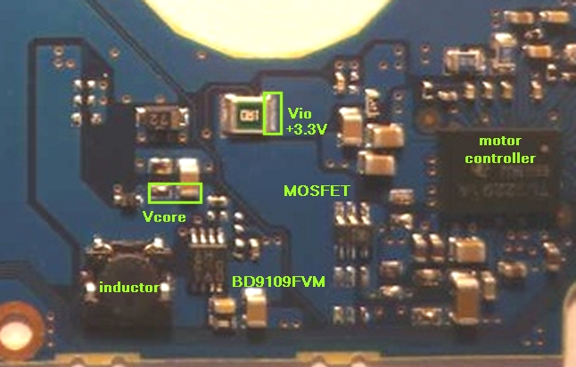

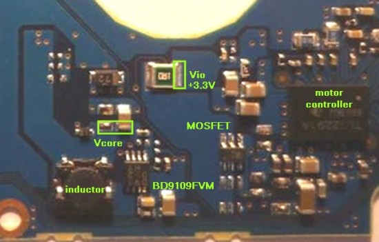

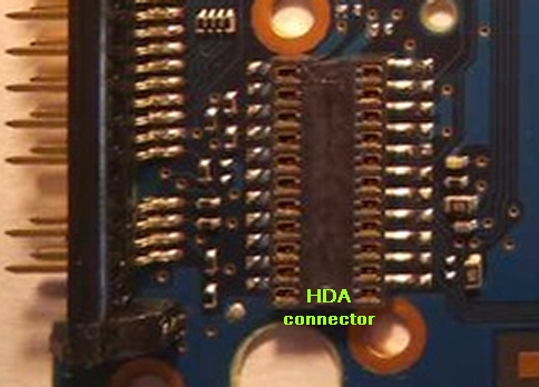

I would try to confirm whether the preamp may have been damaged. To this end I would start by measuring the Vcore and Vio voltages on both PCBs.
I would then determine if there is any continuity between the pins of the HDA connector and Vio and +5Vin. This will tell us the power supply requirements of the preamp on the headstack (either +5V or +3.3V, or both). If the preamp gets a positive supply directly from the external +5V input (via the fuse), then it has probably been damaged.
I would compare the resistance between the relevant supply and ground of each of the donor and patient HDAs (by mounting the donor's PCB on each HDD). This will enable us to compare the resistances of the donor and patient preamps.
BD9109FVM, Rohm, 4.5V - 5.5V, 0.8A, 1ch Buck converter:
http://rohmfs.rohm.com/en/products/data ... 6fvm-e.pdf

I would measure the resistance between ground and each of Vcore and Vio, and then compare the readings against the donor's. An excessively low reading for Vcore would confirm that the MCU is dead.
 Post subject: Re: Fujitsu MHV2100AH: head fails
PostPosted: January 12th, 2018, 8:37
Posts: 17326
repfanatic wrote:
Various posts here say that without (working) preamp, the disk woul'nt spin up. In my case, it IS spinning up with the good PCB: so in this case the preamp should be OK.
A typical failure mode of some preamps is a short between supply and ground. This will prevent the PCB from powering up.
Some drives need to detect a preamp before they will spin up, others don't. I'm not a data recovery professional, so I don't know how your model should behave. However, you could try to isolate the HDA contacts on you donor drive with a business card, assuming that the motor contacts are still able to make solid contact.

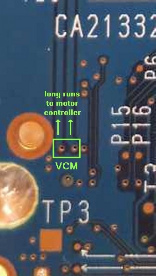

repfanatic wrote:

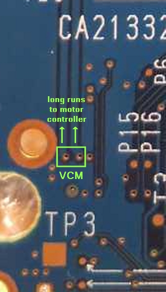

BUT as the heads do'nt make any noise at all, something would be failing in the servo actuator.
If you wish to rule out this possibility, measure the resistance between the VCM pins with the PCB on and off the HDA.

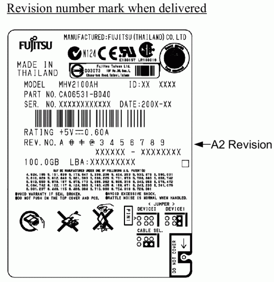

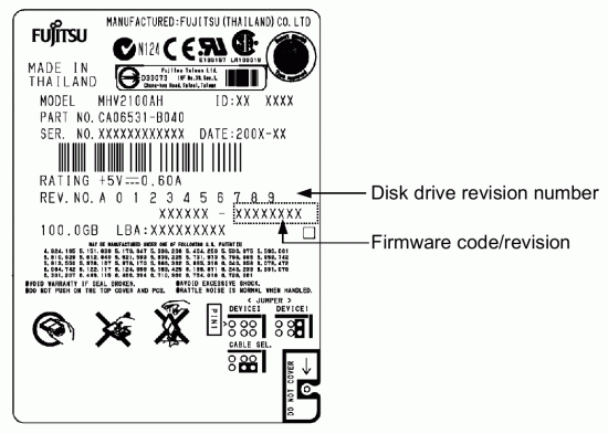

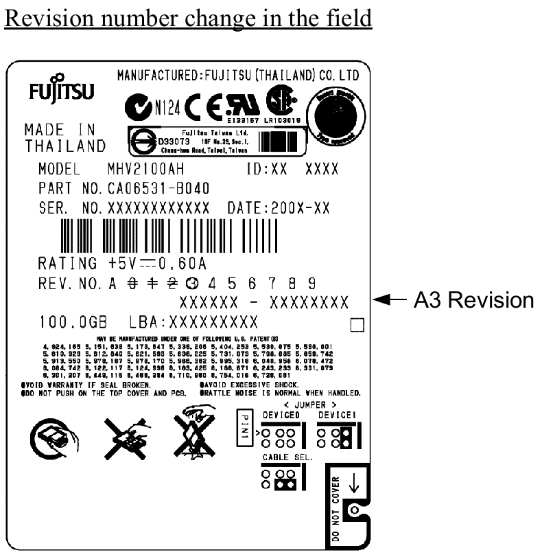

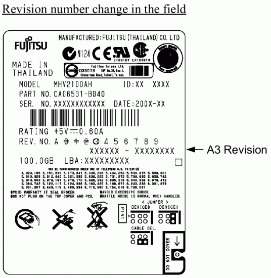

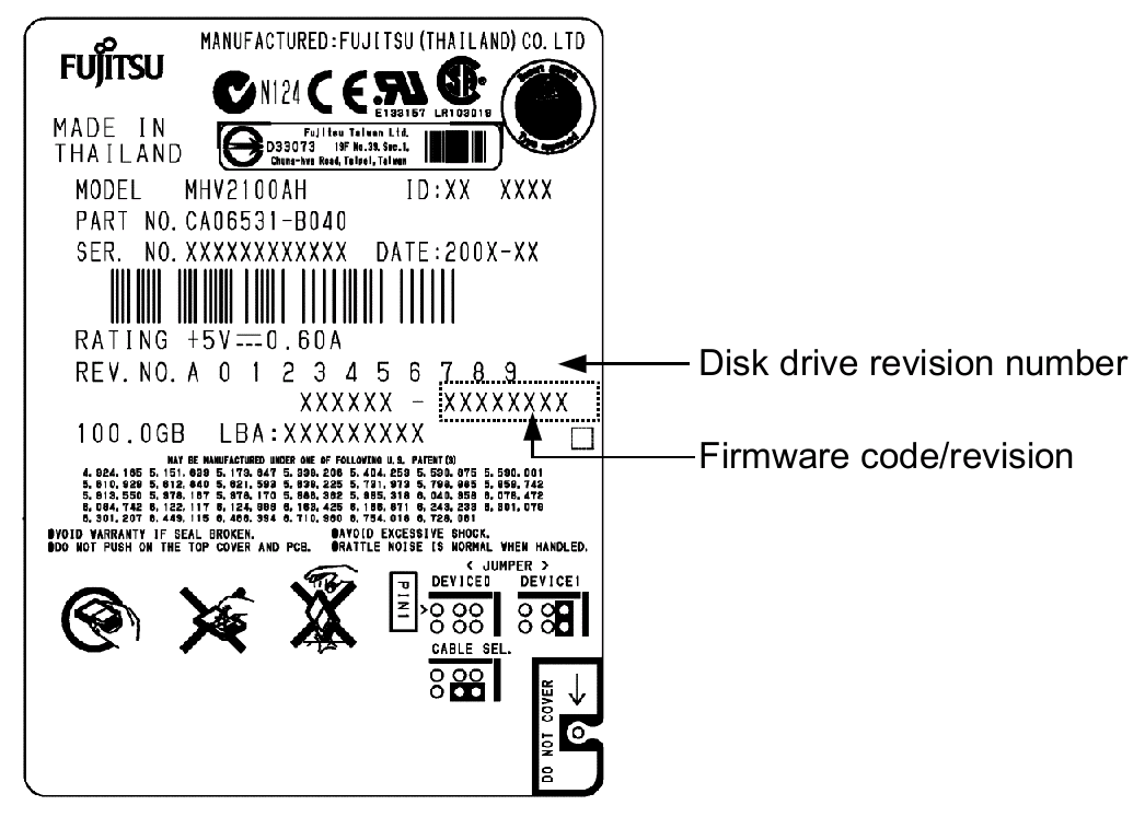

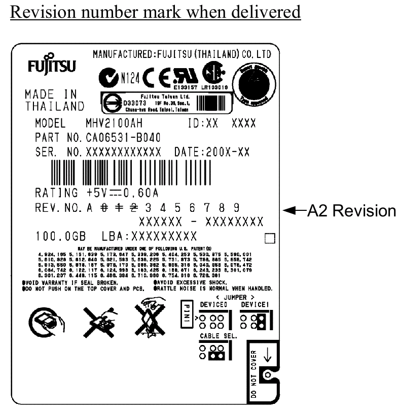

From the manual ...
http://www.fujitsu.com/downloads/COMP/fcpa/hdd/mhv2xxxah_maint-manual.pdf

So, this is what I measured:
Vio on both PCBs: 3.3V (connected or not to drive)
Resistance from Vio to gnd:
- donor PCB: 5.33k not connected, 4.9k connected to drive
- failing PCB:5.25K
No continuity from Vio to HDA pins.
Vcore on donor PCB: 1.24V, failing PCB: 3.44V (connected or not to bad drive) .
Not a BD9109FVM regulator I think, but has matching pinout.
Resistance from Vcore to gnd:
- donor PCB: 166ohm does'nt change connected or not to drive
- failing PCB: was first 98ohm, 48.5ohm after powering a few seconds to read voltages, then 15.3 ohm after powering another time ( :shock: sign of melting MCU?)
No continuity neither from Vcore to HDA pins.
There is 6.6ohm between VCM pins on both drives. On both disconnected PCBs, its near 160k, so servo winding should be OK.
Interesting thing: good drive spins up even when HDA disconnected -> it does'nt need to detect preamp.
My deducing is: failing core voltage regulator -> dead MCU + dead preamp, servo winding OK (does'nt help much...) :arrow: Head stack replacement needed :(

Sorry, the hires scan identifies the Vcore regulator as a BD9102FVM.
BD9102FVM, Rohm, Synchronous Buck Converter with Integrated FET, 4.0V - 5.5V, MSOP8, Vout = 1.24V:

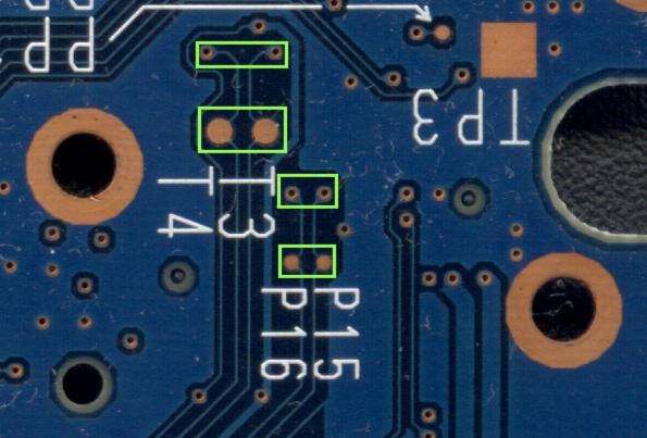

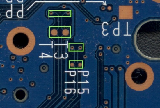

You might also like to measure the Read/Write Channel test point voltages (T3/T4 & P15/P16) on the donor PCB when mounted on each of the donor and patient HDAs.
Preamp Block Diagrams:
http://www.hddoracle.com/viewtopic.php?f=59&t=229
