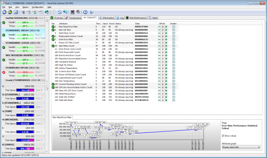

Is this SMART normal for a new portable disk.
Crystal disk info
HD tune
HD sentinel
HD tune read test
I am worried about that raw red error rate 65 - 84, that ok?
I run Seatools long and short generic test, test passes without problem.
Seagate Drive Settings program won`t detect anything in Win10 so I can`t check with that.

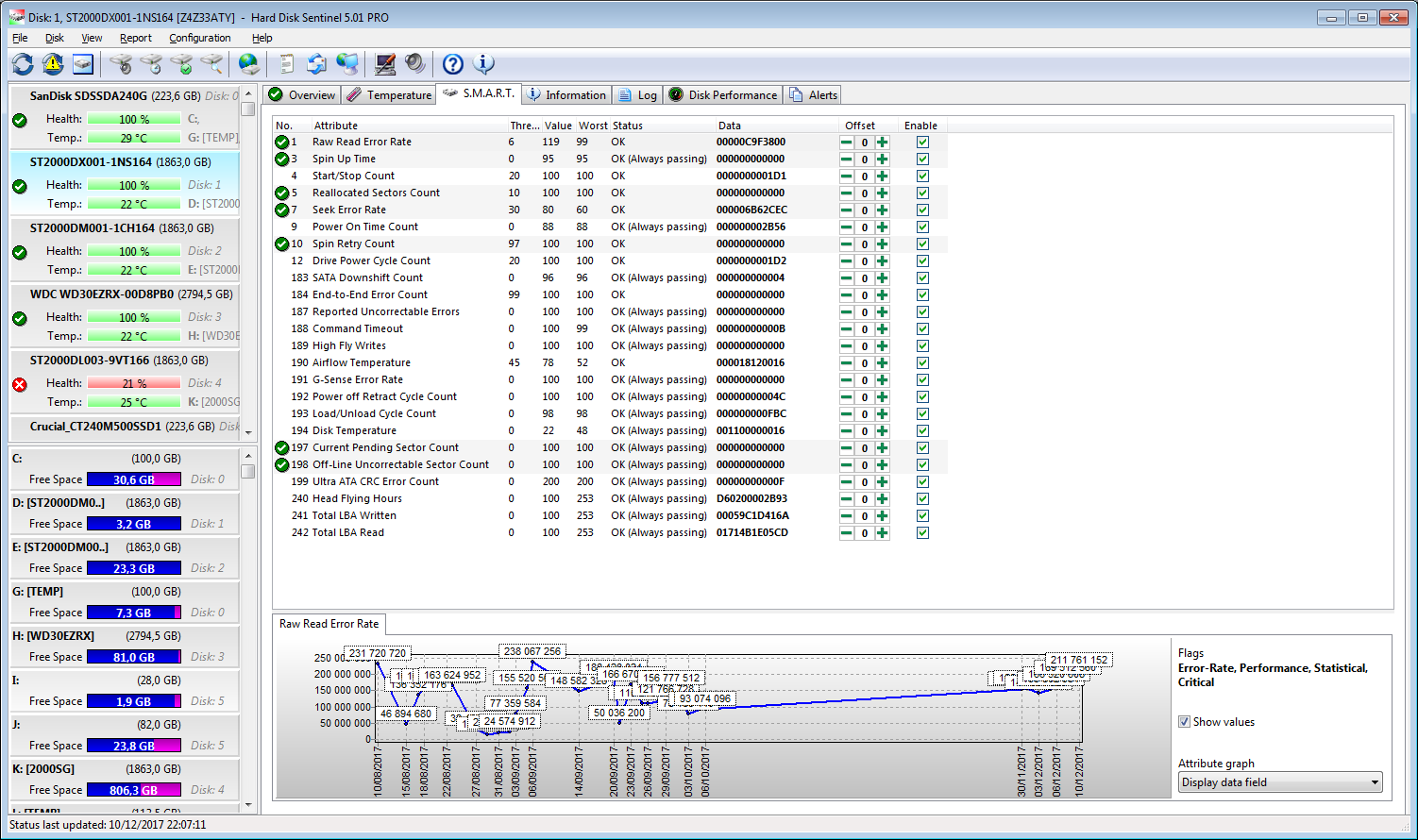

– People here will most probably tell you (if they're in the mood, or if you insist a bit) that Seagate HDDs are crap (it almost seems like it's insulting to even ask if it can be safe to use one ! :shock: ).
– Otherwise, I would say that if three reputed softwares report that particular unit as healthy, then it can be considered healthy. All my Seagate HDDs have crazy numbers in the “Raw read error rate” field (see attached image), I don't know why but it doesn't seem to be of particular concern. It may or may not be related to that statement I read on this forum recently :
The flying height of today's drives must be a lot lower than in those older models, and today's higher track density would be placing much greater demands on the servo system and on the motor bearing. To get an idea of the progression in technology, it might be worth following the changes in the Hardware ECC Recovered SMART attribute in Seagate's models. AFAICT, the normalised value for this attribute has steadily declined with newer models, to the point that Seagate no longer appears to report it. ISTM that HDDs are nowadays digging data out of noise.
File comment: (healthy) Seagate ST2000DX001
