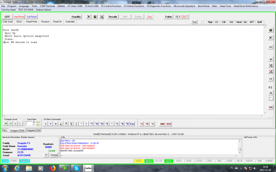

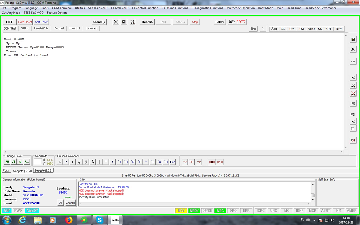

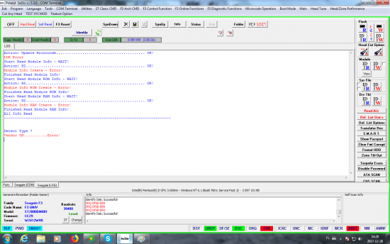

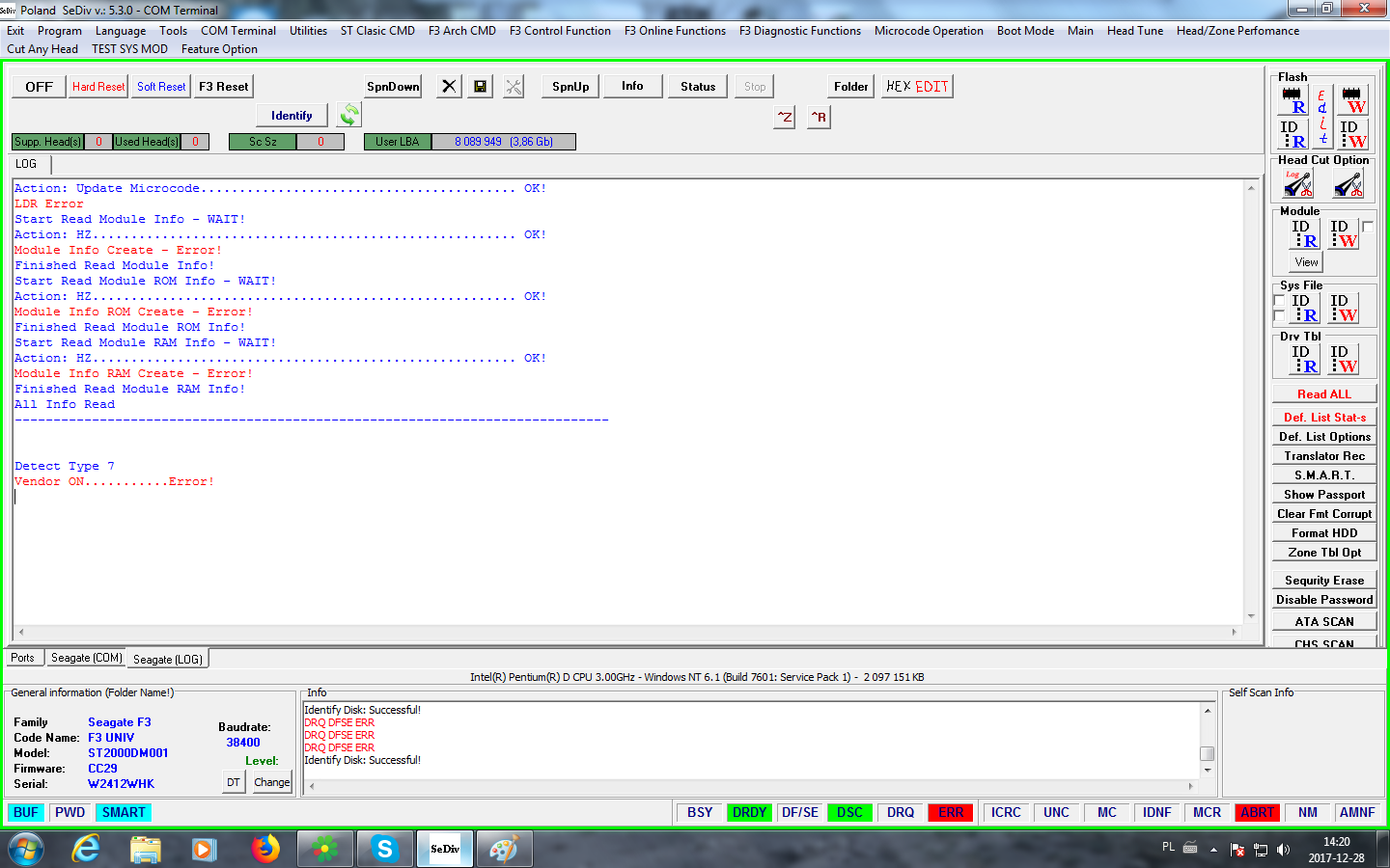

Hi, long time no write post, but the time has come for a serious case.
Patient is Seagate ST2000DM001- 1ch164 FW CC24 upgraded to CC29 from Seagate site(ISO file)
by accident rewrite sysmodules from other FW from Oryginal backup CC24
Disk calibrated ok, no clicking noises, and at this moment nothing work
Terminal not access, and disk cant initialize SA.
I have oryginal backup From CC24(Modules, Sys modules, and ROM, RAM, and ROM IDs, LDR), everything comes from my disk(Oryginal SA before update to CC29)
I used legal sediv in latest version.
Attach logs
is chance gain access terminal, and format SA? and write back oryginal SA?
at this moment disk read from ROM, and only i write sys modules from oryginal SA backup(CC24)
btw, short read channel not work, isolate head stack also not work, trying load LDR by ata also nothing happend.
Remember! My disk is my and is not for resale, and is empty!
