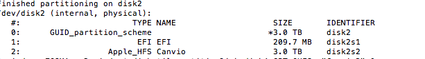

I accidentally repartitioned my main storage hard drive, by using the following terminal command on it:
diskutil partitionDisk disk2 GPT JHFS+ "Canvio" 0g
To make matters worse I just realized the drive might have also been encrypted with firevault2. Not 100% sure but 95% sure. I have included screenshots of the terminal window before and after making my blunder. anyway to tell if the disk is encrypted from this?
the hard drive has about 3 TB of data on it. it has everything that I need. is there any way to get this data back by just simply re-creating the partitions? Meaning will software out there restore the partition table?
If the hard drive is not encrypted:
I have the following software: Disk Drill and Stellar Phoenix Mac data recovery. I could scan the whole hard drive for its content copy that to a new hard drive and copy it back, but I was wondering if there is any other easier way of doing this, where the partitions can just be re-created on the same hard drive.
however if the hard drive is encrypted ( I know the key)
is there any way to get the data back?
I am running 10.12.6
thanks for the help!!

I do not recommend to play anymore directly on your drive, i mean that you shouldn't re-create or modify partitions on your drive.
Do not work anymore on it in writing mode or you will do things worse.
I suggest to clone the drive, then work on clone.
Once you have cloned it, you could try to decrypt filevault2 on clone drive by following this guide:
https://derflounder.wordpress.com/2011/ ... oot-drive/
also, you might find interesting the following thread:
https://forum.hddguru.com/viewtopic.php ... 89#p249089
After it gets decrypted, if you still can't get access into it, you might try to recover data with R-Studio or UFS Explorer.
Extract data on a third drive.

rimmi2002 wrote:
i,
No
Filevault2 relies on CoreStorage
CoreStorage (CS) has several chunks of metadata
First chunk is CS Volume Header, it is located at the beginning and at the end of a volume. CS Volume Header has UNIQUE ENCRYPTION KEY that encrypts other chunks of metadata. Recreating partitions won't re-create the encryption key. Without the key you cannot decrypt CS metadata and without metadata you cannot decrypt the volume. Meaning you are in really bad situation.
There is a very high chance that the first copy of CS Voluem Header is re-written with new partition. However the second copy might be alive because from what I see you've had slightly different partition schema before re-format.
You need a professional who really knows how to work with FileVault2 to recover this data. I suggest you to find one.
