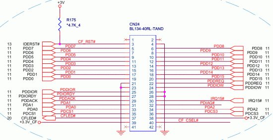

The following threads talk about replacing the CF card in an Acer Aspire One A110 netbook with either a Samsung HS030GB or HS06THB PATA/ZIF 1.8" HDD:

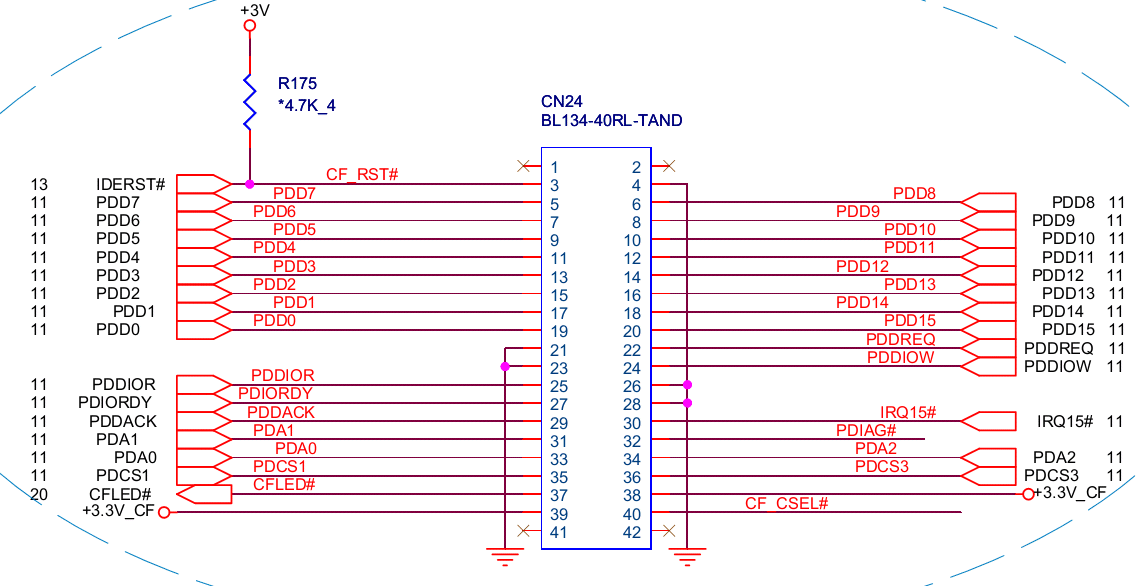

Here are the circuit diagrams for the netbook's motherboard:
ACER ASPIRE ONE A110 A150 QUANTA ZG5 REV 1A SCH:
https://elektrotanya.com/acer_aspire_one_a110_a150_quanta_zg5_rev_1a_sch.pdf/download.html
http://monitor.espec.ws/files/aspire0nemb__rexonavn.com__361.pdf
The connector pinout seems to match the Toshiba's (except for pins 41 & 42 which are probably an error in the drawing).

Hey again,
So, the pinout provided by Frank was correct.
Imaging the drive now with MRT.
