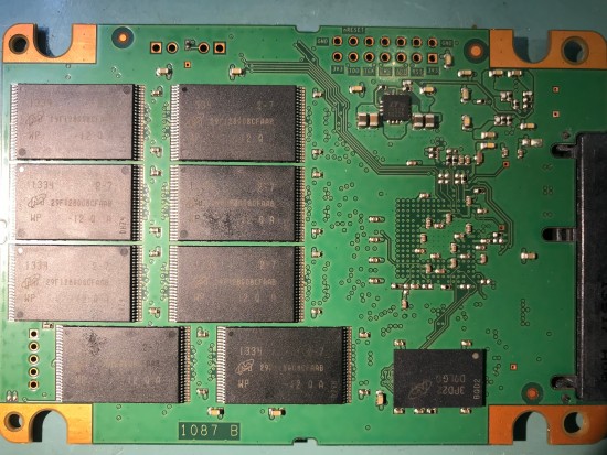

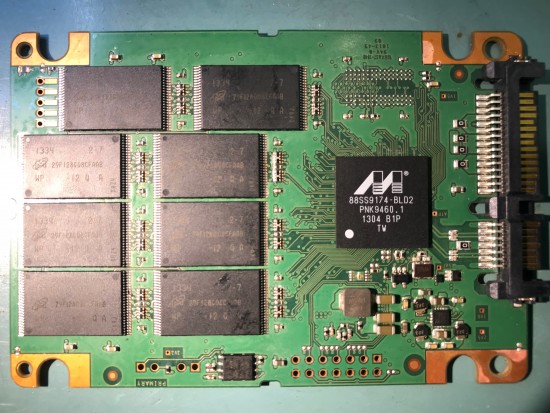

Hi Guys
I have a Micron RealSSD C400 , it has no power at all, anyone worked on this before? i think it uses electronic fuse ? Any feedback much appreciated, thanks.

I suspect that the controller and SDRAM would require 1.0V, 1.5V and perhaps 2.5V, while the NAND array would run off 3.3V/3.3V or 3.3V/1.8V. The serial flash might be a 3.3V or 2.5V device. If all these voltages are present at their respective test points, then the board is correctly powered.
I would measure the 5VF test point adjacent to the supervisor IC.
Next I would confirm whether the crystal is oscillating.
The following thread may be of some help to you.
Need help with a Crucial SSD, short circuit in 5v line:
viewtopic.php?f=10&t=29757

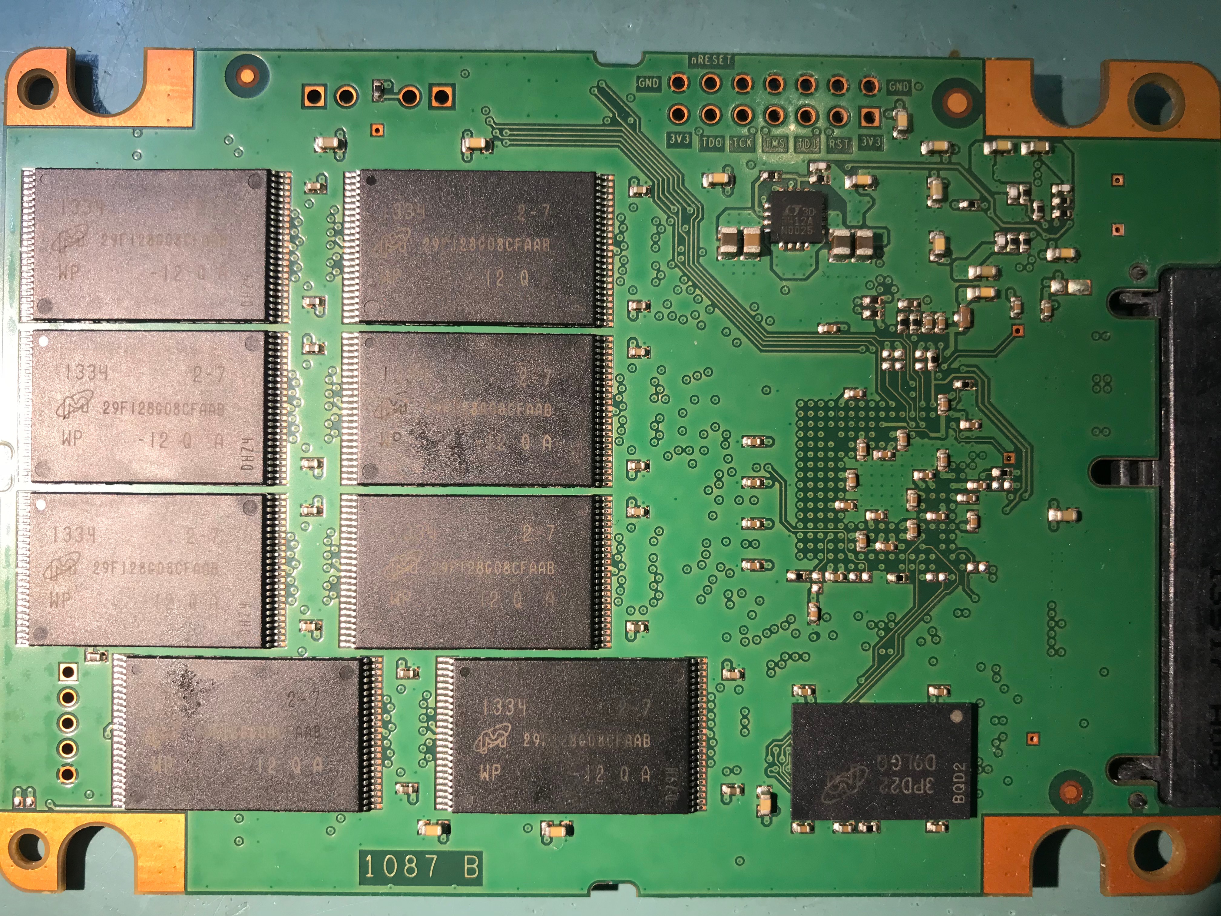

FYI, the SDRAM in the other thread is a 1.5V part, and the serial flash memory is a 3.3V part.
MT41J128M16HA-15E:D, Micron, marking D9LGQ, FBGA96, DDR3-1333 SDRAM, 1.5V, 1.5ns, 16M x 16 x 8 banks:
https://www.micron.com/~/media/documents/products/data-sheet/dram/ddr3/2gb_ddr3_sdram.pdf
M25P80V6G, STMicroelectronics, serial flash memory, 8-VFQFN, "V" = 2.7 - 3.6V:
https://www.jameco.com/Jameco/Products/ProdDS/321672-DS09.pdf
The NAND flash (MT29F128G08CFAAB, Micron) is an "L74A" part.

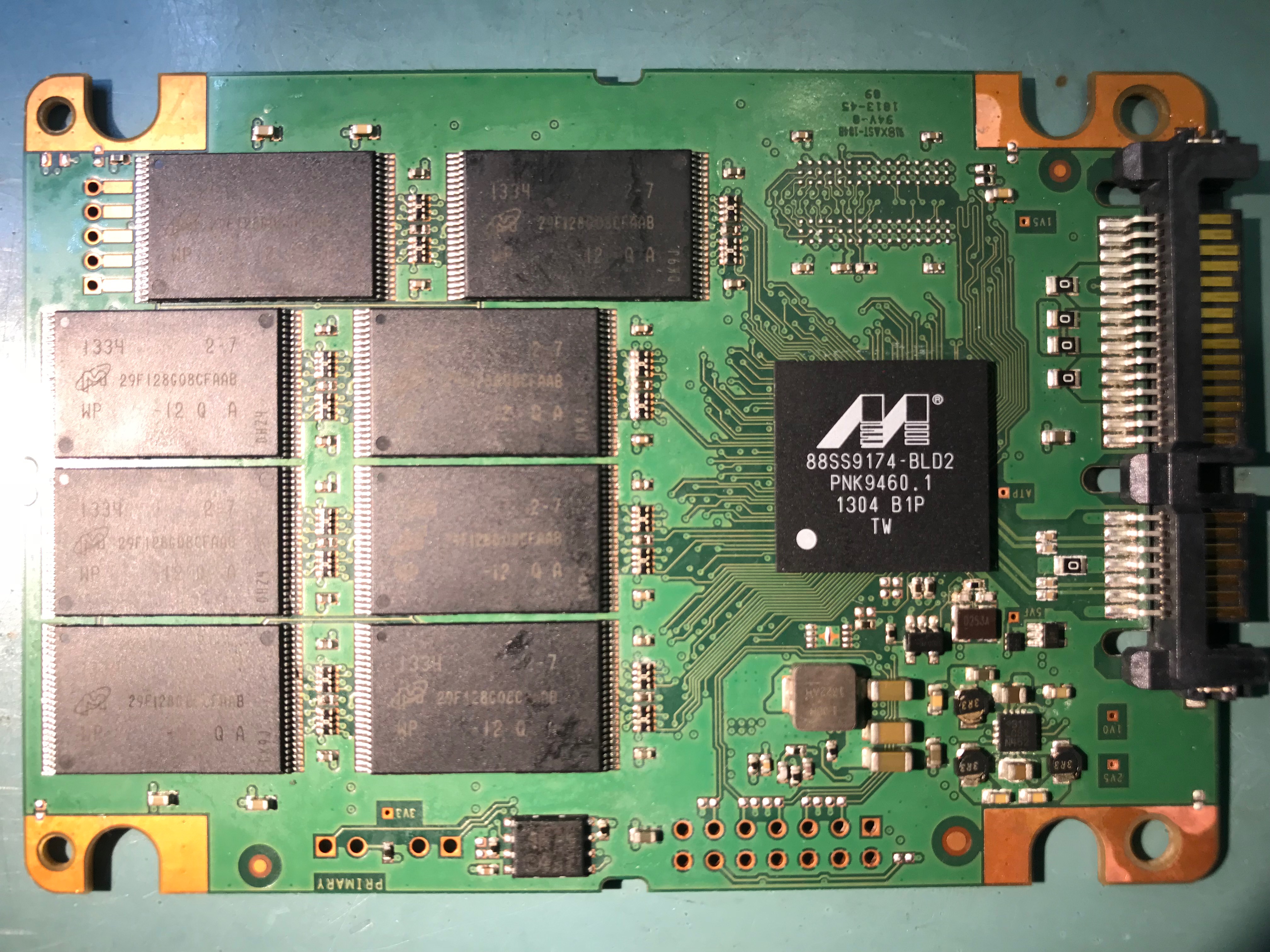

Frank ,
I Think i Have The SSD i Think , I Will Check And Let You People Know Might Be We Can Find The Real Cause Of Terranovas SSD Being Just Dead ,Just Wait For Tommorow Morning

The following thread suggests that the 5VF test point should rise to 2.5V at power-on and then drop to 0V when the supplies stabilise.
http://notebook1.ru/forma1/viewtopic.php?f=290&t=126331
If 5VF is sitting at 0V, my next suspect would be the D250x crystal.
More info on the NAND, for completeness.
MT29F128G08CFAABWP-12A, Micron, L74A NAND flash, TSOP-48, 3.3V, 128Gb, x8, 166 MT/s, type 2D:
https://www.micron.com/parts/nand-flash/mass-storage/mt29f128g08cfaabwp-12z

I have exactly the same symptom!! All voltages measured right. Bios does not recognize it, but if I use an USB to sata adapter, I can read the Smart information and I can even flash the firmware. But if I try to initialize the disk, I get the cyclic redundancy check error. The chips are very cold too. The drive only have about 700hrs.
Any information would be great.
