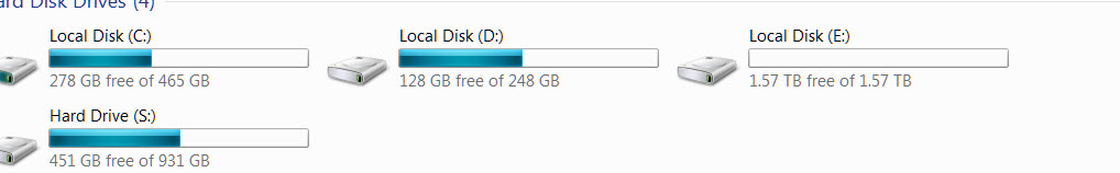

I say particular recovery because I need to recover only one partition on the drive.
The drive was partitioned into 3 parts, D,E and F. Now it only shows D and E. (see pic). Not sure what caused it to drop F drive partition. I was able to recover the F drive although it doesn't show up, by using EaseUS Data Recovery Wizard. D drive is readable as is E drive but I have a lot of files on E drive that I'd like to recover so haven't written anything to it other than a EaseUS Data Recovery Wizard scan. The scan shows a large number of files of various sizes as well as the "usual?" list of files. They are listed under "more Lost Files" raw 341368 (number of files).
E is showing 1.57 TB free which I'd like to recover. I'm thinking E drive partition has lost it's file listing? Anyway to repair it without losing everything on that partition? I don't care about the D partition so it can go if need be.
Thanks for and all help!

try to use r-studio.
 Post subject: Re: Hitachi HDS5C3020BLE630 particular recovery
PostPosted: January 30th, 2018, 21:41
Posts: 17323
    (248 GiB) + (1.57 TiB) = 1.99 TB
ISTM that you may have deleted partitions E: and F:, and then reinitialised the resulting empty space as a single partition.
Can you show us DMDE's Partitions window?
