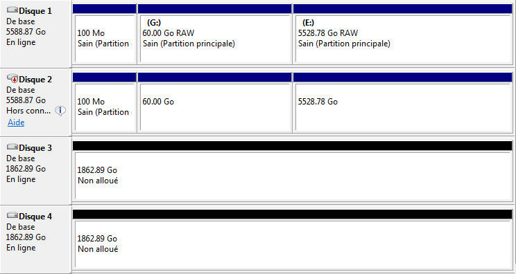

The partitioning sheme of drives #1 as well as drive #2 is as follows:
100 Mb (EFI system partition)
60.00 Gb RAW
5528.78 RAW
When drives #4 is attached to another computer, whilst drive #3 is, it is not "In line" but "Off line" in the disk manager.
But when attached alone, it is becomes "In line". So, there is some conflict between the two drives, as they were same.
Drive #3 as well as drive #4 have a unique RAW partition which covers all the drive.

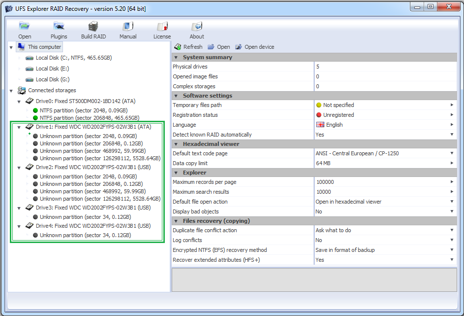

Connect All Disks and open UFS and send us here screenshot
Prefer if you mark those drives by anything using MS-Paint or something

So, here are the screenshots of the disk manager and UFS RAID Recovery.
The docks in which the drives are were powered on respecting the order of the drives had in the NAS (1, 2, 3, 4).

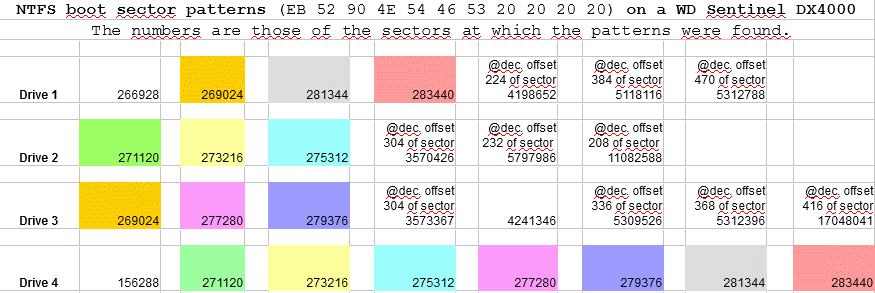

I also did some analysis of the drives with an hexadecimal editor.
The MBR (signature 33 C0 8E D0 BC) was located at the following offsets:
[list=]Drive 1 : 7B55A90
Drive 2 : 7ADDA90
Drive 3 : 0
Drive 4 : 0[/list]
(Drives 1 and 2 had "00" hexadecimal values at their beginning.)
I also searched for NTFS boot sector patterns (signature: EB 52 90 4E 54 46 53 20 20 20 20).
They are given by the screenshot of the spreadsheet.
And this is where I stop for today.

Raid5, Backward dynamic, 64Kb stripe size.
In sector 3907023920 of each drive should be present interesting info about this raid5 layout (Order, stripe size, offsets and so on)

hehe As a Conclusion here:
From your Uploaded Image, Disks Order as the following:
Disks 1&2 (One of them is 1st. the other is the LAST) in array
Disks 3&4 (i guess should be simple, 2&3) in array
The rest is you to collect all info.
Good Luck

Absolutely. The last screenshot in my second post shows they are not mirrored.
If the drives do not match then its most likely RAID 5. If two sets of drives match, then its a RAID 1.
Totally agree. Yes it's RAID 5.
Indeed, I didn't see the last post. A 5.5TB partition. I also meant 1+0 rather than RAID 1
With 4 x 2TB drives, RAID 10 (1+0) would allow a maximum storage of 4 TB, not 5.5 TB.
I ran a XOR test with graphical output, showing that the RAID 5 is OK for most sectors.
The first 3 sectors failed, showing where the problem could come from.
I also observed some small stripes at some locations, where the XOR test was ambiguous, which proably means that the XOR test succeeds for some bits in a sector and fails for some other bits.

Data recovered :D
Drive order : 2, 4, 3, 1
Block size: 128 sectors (64 Kb)
Backward
