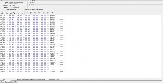

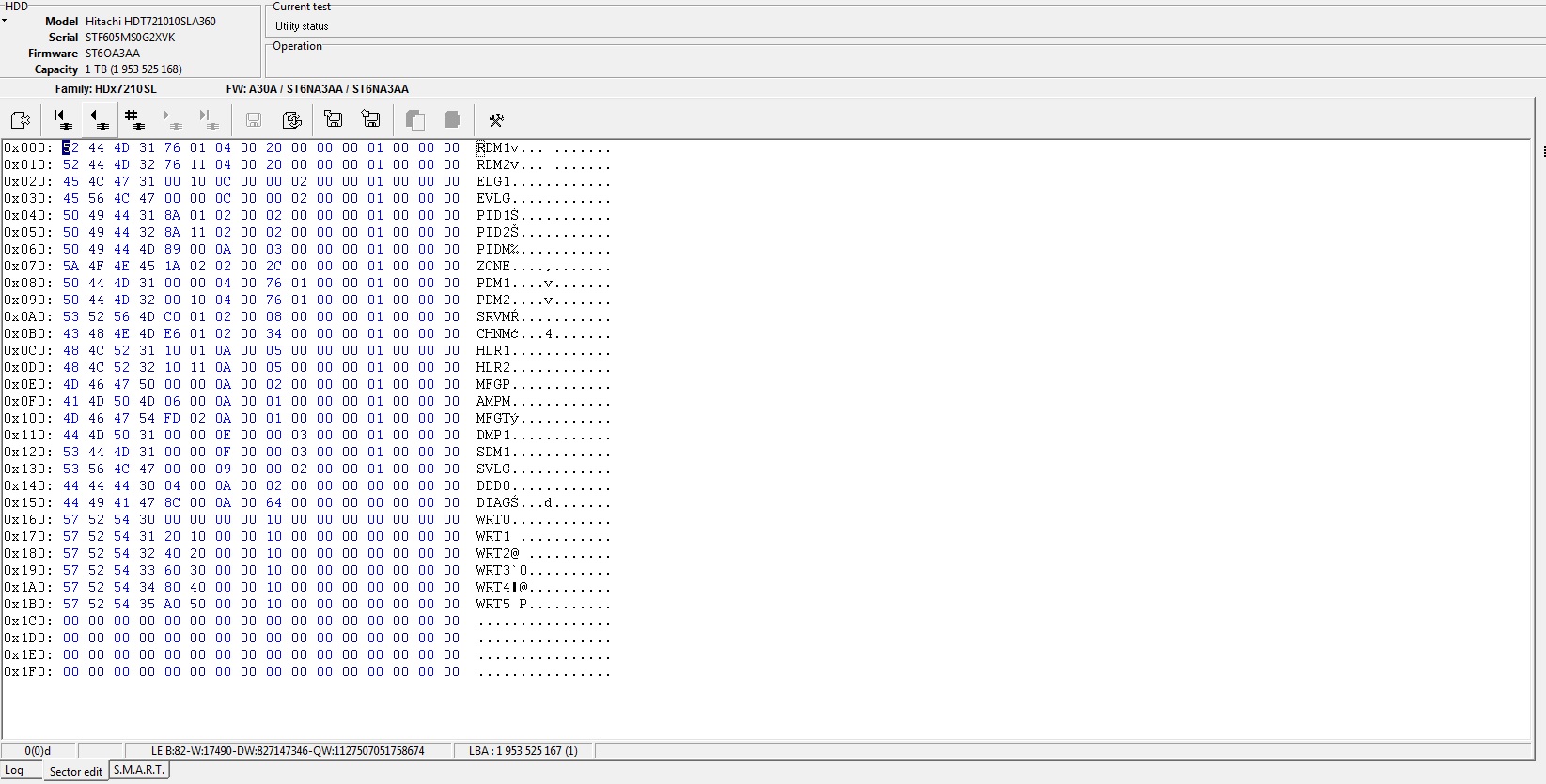

 Post subject: Hitachi HDT721010SLA360 - each sector looks the same.
PostPosted: May 10th, 2018, 2:51
Posts: 356
Hello, just found an old drive in my stock. Data is not important but i've never seen a drive(not encrypted) that has each sector the same. Picture attached. Any tips on this one?
File comment: sector view
odzyskiwanie danych
 Post subject: Re: Hitachi HDT721010SLA360 - each sector looks the same.
PostPosted: May 10th, 2018, 3:07
Posts: 1388
Location: isreal
everything OK in the SA ?
PostPosted: May 10th, 2018, 3:26
Posts: 356
RSVD F copy looks bad. Nothing more important, in my opinion:

Thank you, will try. Disk was formated via PC3K (tech) - same result. I did format it under Windows and sector 0 shows normal data - Error loading operating system etc. All the rest - same as it was. I can write to the drive and it stays written.
odzyskiwanie danych
PostPosted: May 11th, 2018, 1:37
Posts: 356
I used security erase over night and all sectors are zeros now.
