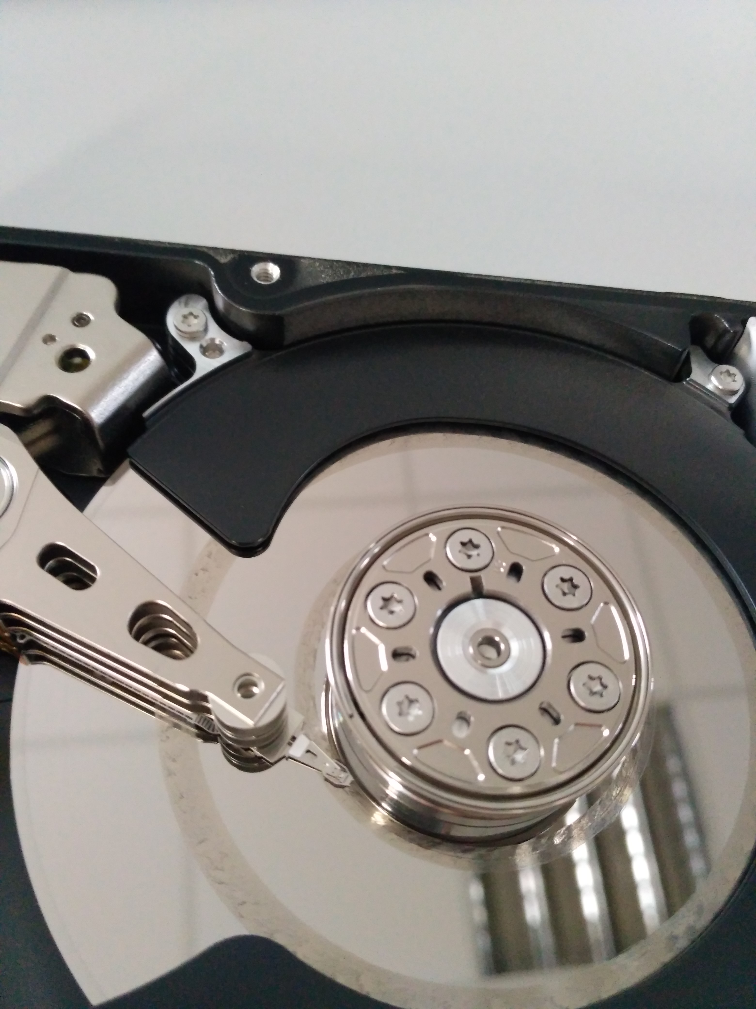

hi guys,
I have Seagate ST31000528AS drive, it starts spinning, then a few clicking noises and then stop spinning..
I have opened the drive and made a photo.. as you can see, some problems on the plate I would say..
fortunatelly, I have another one, which Works good - my idea is to switch plates from bad to the one which Works - will it work or based on the picure, there is some problem in FAT (possibly firmware) area and there is no chance to read data?
btw. I have already tried to switch logic board, but the same behaviour so it is not in the logic board (I think, I'm not an expert)
data are sensitive so no posibility to send HDD to external company for recovery..
and yes, from the HDD failure, I'm using RAID and also net/local backup but that disk is from older times, maybe somebody can give me a good advice..
thank you so far!

Your drive is FUBAR, nothing you can do to recover from it, media is damage. You mention that drive is part of a RAID? what level RAID is that?

Too late for something, both from the defect and from the opening of the drive.
A pro could recover some of the data, but I believe it would be costly. You need to balance the data importance for this cost, and then choose a data recovery company with a good confidentiality agreement. I´m sure there are many in Europe.

Looks like you killed a dead disk. Yep not much to do except to rebuild the array on a working Hdd.

hi all,
no no no.. that disk is not part of any raid.. I was just saying that from that failure, I'm using raid.
so there is no way how to read data betweet those damaged areas? like sector by sector?? it should work right..?
if I take out disks from failured HDD and put them into working one (the same model) - no possibility to recover something?

I know I will sound harsh, but just stating the facts :
The way to recover the little data that still is possible would involve many heads, because they will be damaged by those rings in the platters and other damage to the surface.
Yes, it is possible to read some data between those damaged areas. Some very experienced people can do it. It will cost a lot, also.
If YOU take the disks from this disk and put in another ( what for ? The problem is in the disks ) you will just ruin the good disk, and destroy any possibility of recovering your data.
To sum it up : if the data is important, find a professional recovery firm ( if you complete your profile in the site with Country/City people may advise someone near you ) . It will not be cheap, and many people will refuse the job, now that the disk has been opened without necessary precautions .
If data is not that important to justify paying for it, then just put the disk in the trash, and consider this a costly lesson on keeping backups.
This is a good guide on how to make two dead drives out of a dead drive and a working one.
Since you have already opened the drive (which was a very bad idea on its own), look at the air filter - how dirty it is? This could give you a rough idea about chances with a professional DR company.
But recovery will be time consuming, expensive and far from 100% perfect anyway.

disk is NOT from raid - I only told you that I'm NOW using raid because I want to be secure :)
ok and, it will be maybe very amateur point of view BUT:
what about reading those good data like from vinyl? like rotating the plate and moving the reading head and saving those ones and zeros and basically collecting what was left..?
or this reading head in bad hdd is already bad because of the plate surface?
btw the other disk was opened too - just to see how good plate should looks like but it's ok, it's 8 years old 1TB disk.. nobody would use it for any purpose...
Awesome!
One of the most revolutionary approaches I've seen in the data recovery industry so far.
Be sure to additionally lubricate the platters to help the sliders move easier.

:)) it's the standard approach but it should work.. head will read right? so if you move above the rotating plate, you must get data.. and every sector has humber and other info so some software should be able to "build" iso image from those data...
As I told you, reading what is left will involve many head changes, because the platter surface will damage then. That is one of the reasons it will be costly to recover just a part of the disk.
The other disk is destroyed now also. There was no reason to open it, but if nobody would use it, then now it can to go trash and cease being a waste of space.
As for your problem disk, you should consider its data lost. Think as if it was stolen, complain a little, then forget about it and seek ways to rebuild the data, if possible. Recovery from the situation the disk is in is not viable in this case.
