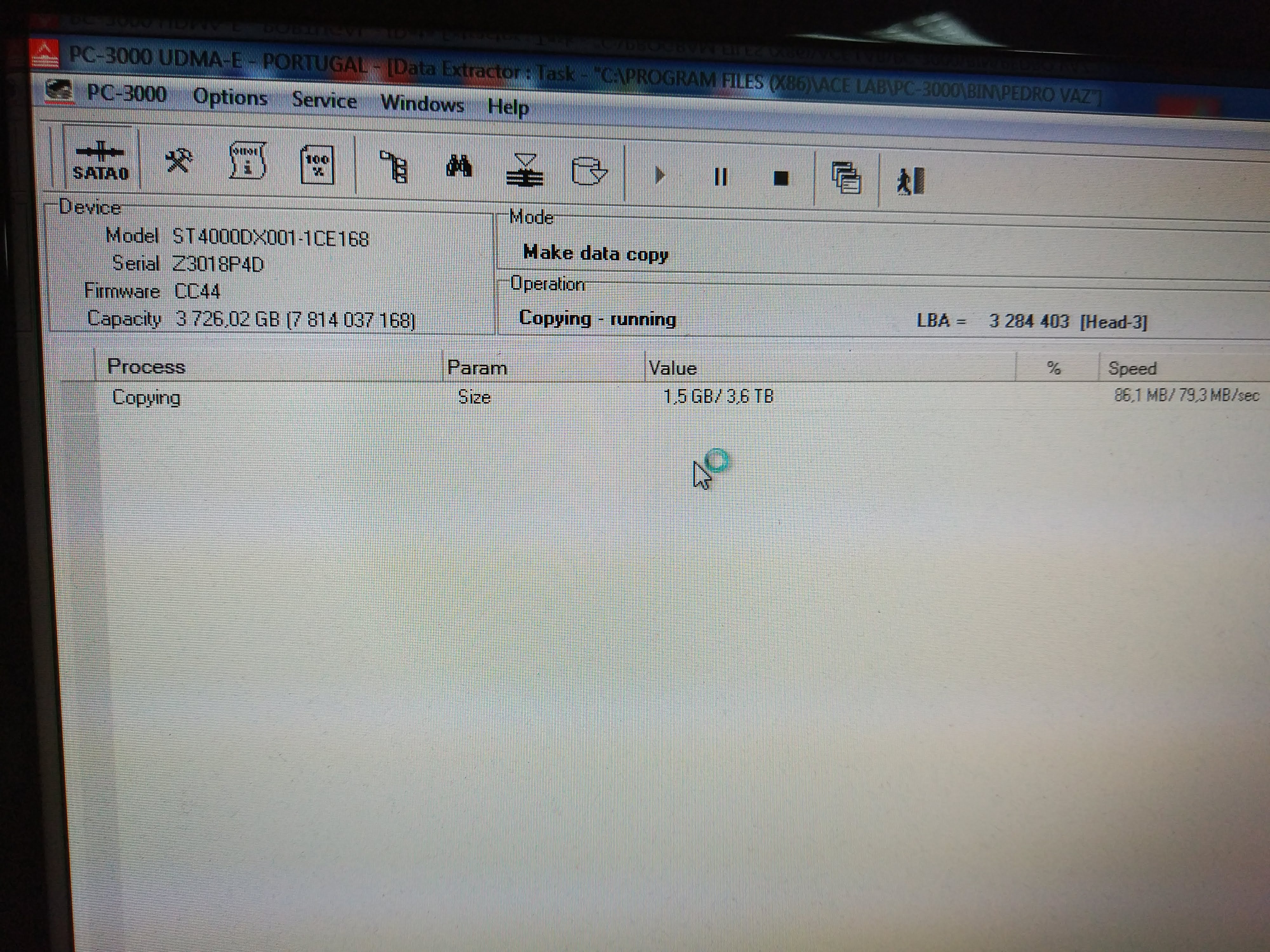

Imaging hehheh

What was the issue?
 Post subject: Re: Serious issue with SSHD ST4000DX001, UART 3.3v or 1.8v
PostPosted: February 10th, 2018, 5:12
Joined: July 12th, 2010, 4:38
Posts: 1455
First was a messed up ROM swap eheheheh
After getting the right one, got a good PCB, solved FW problem and voilá.
But to get things good: at 55% of imaging, the destination HDD for (provided by the client) also failled. Guess what: another Seagate :mrgreen: :mrgreen: :mrgreen: :mrgreen:
Got to get another drive and start all over.
