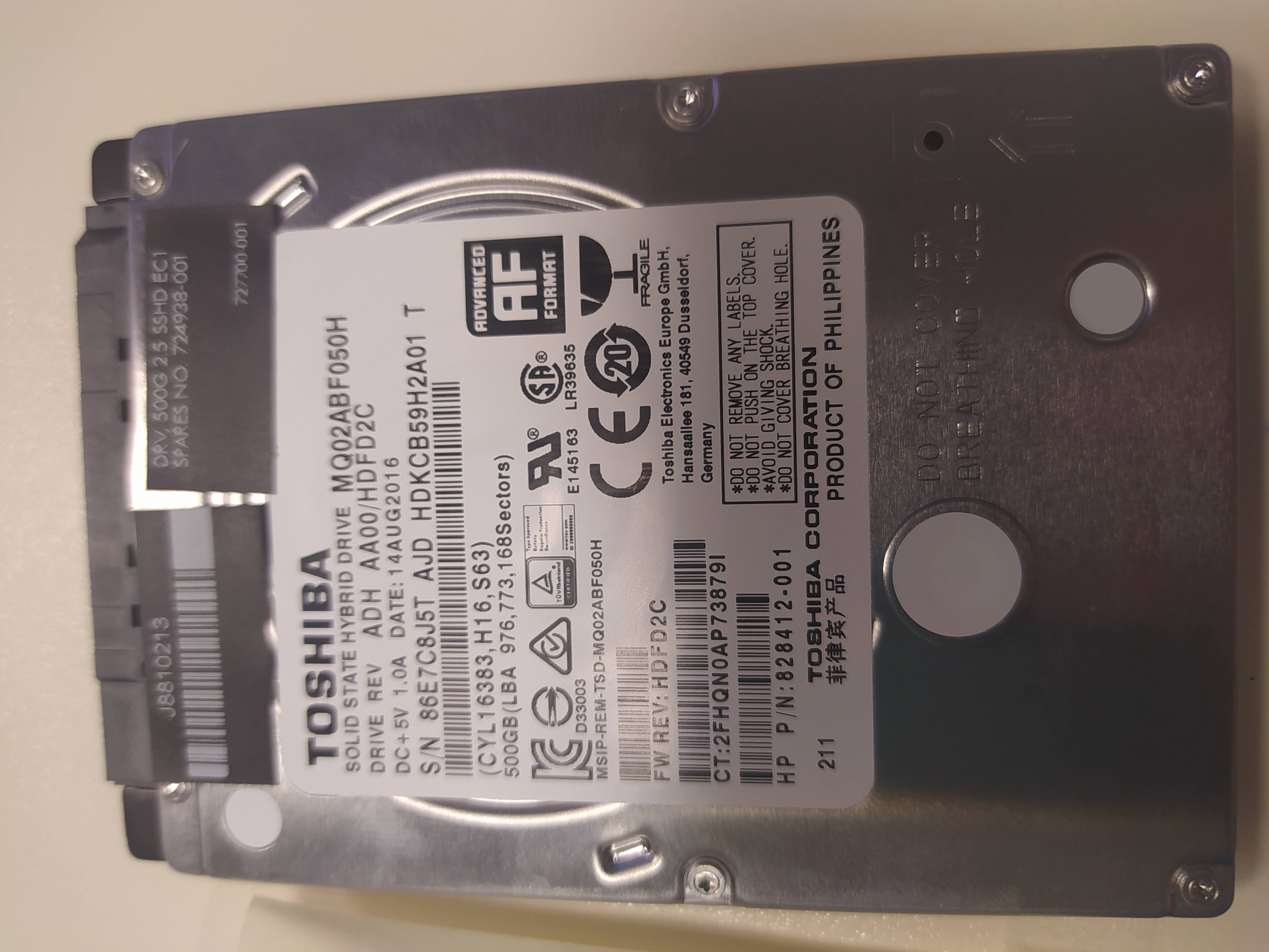

Hello to the community, this is my first question in the forum, I have registered because I have a problem with the hard drives that is discussed in the forum, in my case it is the model
TOSHIBA MQ02ABF050H OF 500 GIGAS HYBRID.
They have been installed in some hp elitedesk 800 g2 65w desktop mini pc.
I installed them with w7, and I constantly have the problem that is reported in the forum, the image is frozen, I turn off the button, and the operating system no longer starts, I have not managed to recover with a windows 7 bootable usb, here they comment that It has been solved by deleting nand, but I don't understand the procedure, could someone explain to me?
Is there a firmware update on these hard drives that fixes this problem?
Thanks for the answers in advance.
All the best.

I don't know how exactly fix this in a certain sure way BUT i would try reducing the size occupied by the partitions (example NOT using first and last GB).
More exact way may be knowing where exactly is the bad sector and exclude it from the usable space...
