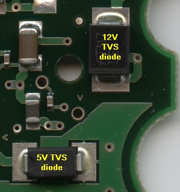

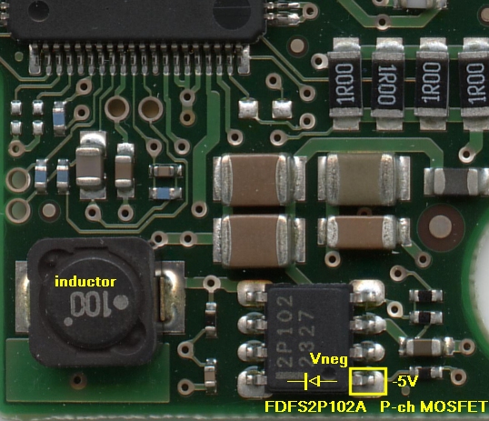

At the 4-pin Molex connector, confirm that +12V is present on the yellow wire, and +5V on the red wire.
Measure the Vneg, V1, V2, and V3 voltages.
Seagate Barracuda 7200.7 ST3120022A hires PCB photos:
http://www.hddoracle.com/viewtopic.php?f=112&t=109

Here's what I got:
V1 1,49V
V2 4,90V
V3 4,90V
Vneg -4,92V
What say you?

Sorry, did I mix up the +5V and +3.3V test points?
V1 is Vcore. Both V1 and Vneg are OK.

The voltages should be measured using a ground reference, eg a screw hole.
I think I may have incorrectly identified the voltages on pins 2 and 3 of the "V33DP" ICs. Are the voltages reversed, ie is the voltage I have identified as +5V (pin 2) really +3.3V? If so, then all is OK.
