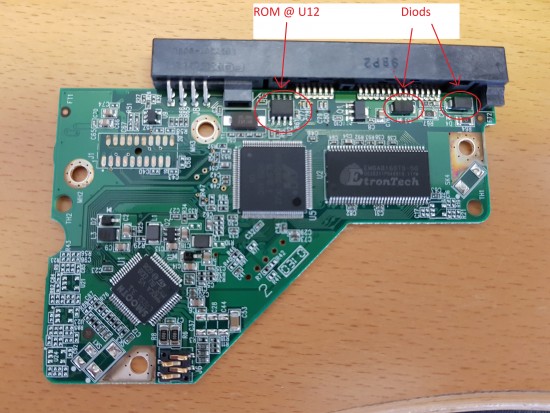

Some MCUs have internal flash memory. Others have an external serial flash chip at U12. Is your U12 location populated?

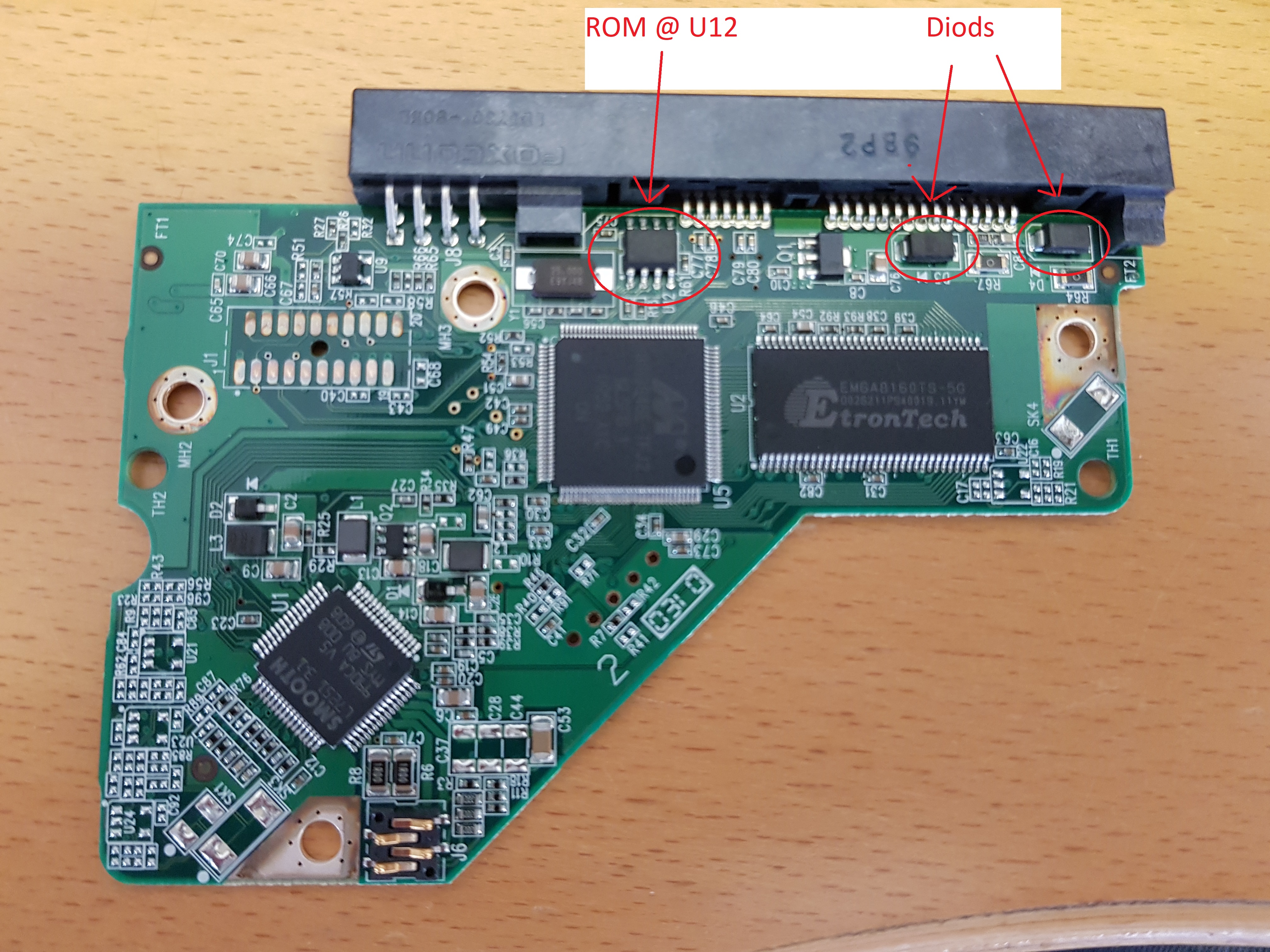

Well, what is a MCU ? And what do you mean by U12, is this a code on the PCB ? Let's have a look... I see many E something, a few P something and TV someting, but no U something, if that's what you mean (I haven't unscrewed it to look at the other side). And I couldn't give you more info for that defective HDD which is not mine. Are there that many differences on HDDs sharing the same model number ?
Also, could it be fixable by removing a damaged diode, as I saw in some threads here, including this recent one ?

Here is a pic of 701590-001. You need to unscrew your pcb and check the other side.
Mcu is the processor...big chip with an M.

Alright. But what would it entail if there is or is not a ROM in U12 on my PCB ?
And can the owner of the defective HDD attempt something with those diods ?

Could You post a picture of the electronic board?
If You do not have external Rom than the rom is located in MCU.
It is possible to recover this rom with PC3000 or rebuild it from SA (using pc3000). Also You can resolder MCU if You have skils :-) Or repair the oryginal electronic board.

Your drive belongs to "Kermit" family. All drives of this family have an external ROM chip ( U12). You have two options:
1. To swap the ROM chips by desoldering / resoldering
2. To transfer the ROM content from one PCB to the other by using a program like WDMarvel, WDR, etc.

This one has no ROM at U12:
https://www.harddrivesforsale.com/it/wd10eavs-00d7b1-pcb-2061-701590.html
https://www.harddrivesforsale.com/media/catalog/product/cache/3/image/560x800/b61f6e664c77c06cd32013c973526a8f/2/3/23842a.jpg

If the drive has ROM chip swap it to the good board...if it doesn't have, swap both diods with the ones from the good board....you can measure them to find the faulty one if know how...or swap both.

I can send a picture of my electronic board, but what would be relevant would be a picture of the defective one, right ?
I could ask the owner of the defective HDD to send a picture, and post it, but that would become too time-consuming to help solve an issue for a total stranger with no reward for it.

EDIT : Answering my own question, WD10EAVS-32D7B1 PCB has no ROM chip in U12 either :
https://www.harddrivesforsale.com/it/wd ... 00-ad.html

If you have a short diode (TVS) then if you plug the drive to a PSU the PSU will shut down, meaning that on internal PC drives with shorted TVS the system will not even power on. If your system is running fine with the drive plugged to it (to the internal PSU) then most likely the problem is not related to shorted TVS.
Alright, that's definitely a useful piece of information.
So if it is not a short diode, it's necessarily a system area issue ?

Probably irrelevant here, but I asked again if there's a chip in U12 on his damaged unit.
If the damaged drive have a PCB without ROM chip (ROM EMBEDED ON MCU) then you could use tools like the following ones to rebuild the ROM by reading the COPY on the SA and write it back to the donnor (new) PCB

It would be simpler to read ROM with external programmer and write it to the PCB by Firmware tool.
In that case, it would read from the (hypothetical) external ROM chip on PCB A, and write it to the MCU of PCB B (which has no external ROM), correct ?
Don't do it. As soon as you reach the part to "no longer functional" unless it does have extrenal ROM chip that you can re-programm with external programmer or you have a tool that can unbrick the pcb by TTL (and writting correct ROM) you will kill the PCB and you will NOT be able to write ROM back....
Alright, so bad idea, even for testing purposes... Is there something else that can be done to test the tool before a first actual procedure ? (That wouldn't entail purchasing two identical drives, if possible... I do have several pairs of WD HDDs with the same model number – including the two WD6400AAKS mentioned in another thread – but none that are currently “expendable”.)
In this case, I would have to do the procedure twice, ideally : once to (hopefully) make the damaged HDD readable again, and once to write back the original ROM to the replacement PCB, so that the healthy HDD (the one I sold) can be used normally later on. For the second part, it has to be done after the PCB has been put back on its original drive, or it doesn't matter ? In any case, once the correct ROM is written to the PCB, there has to be a power cycle for it to be read and for the HDD to (hopefully) start normally, right ?
