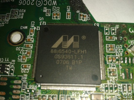

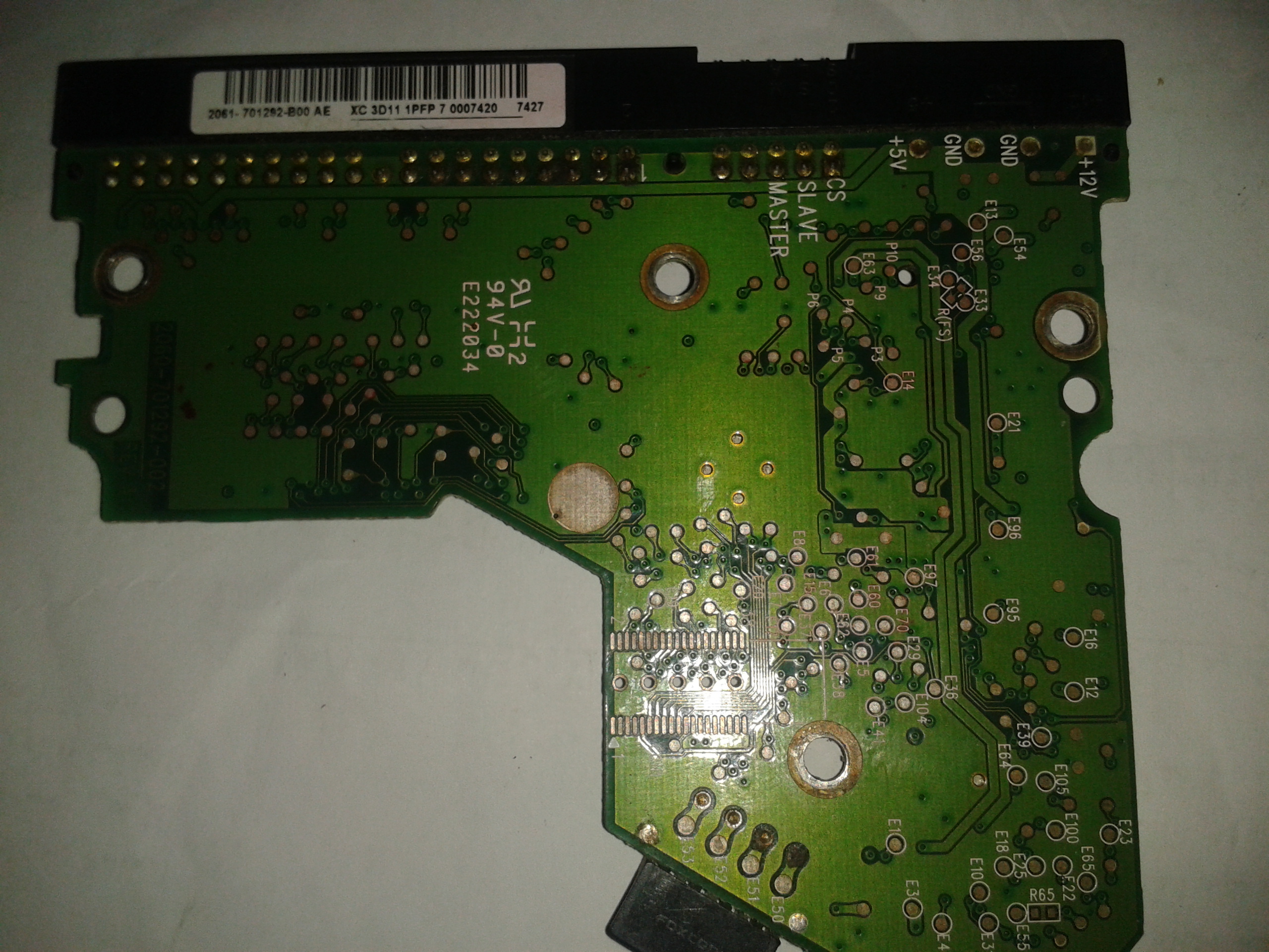

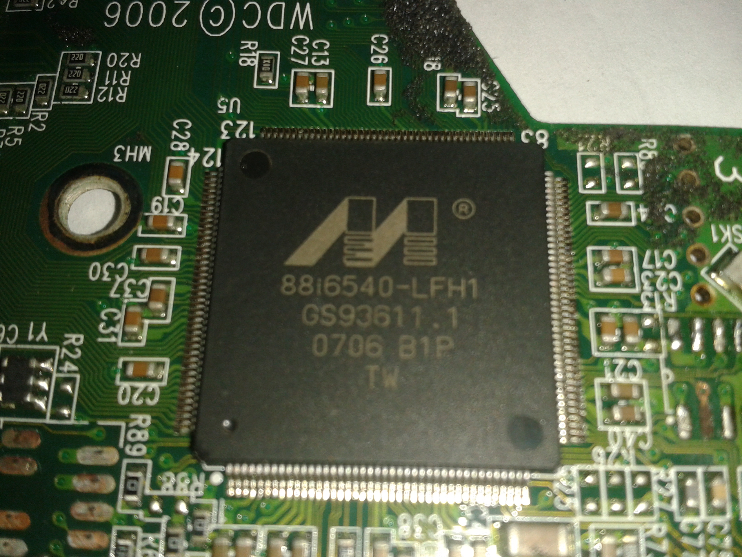

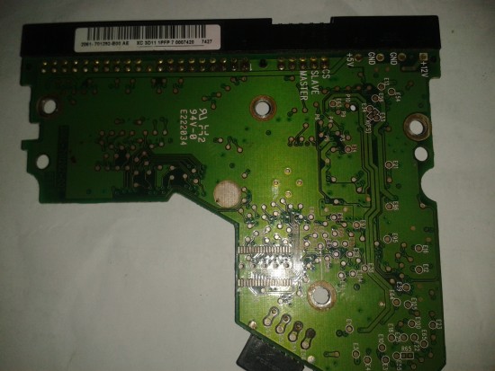

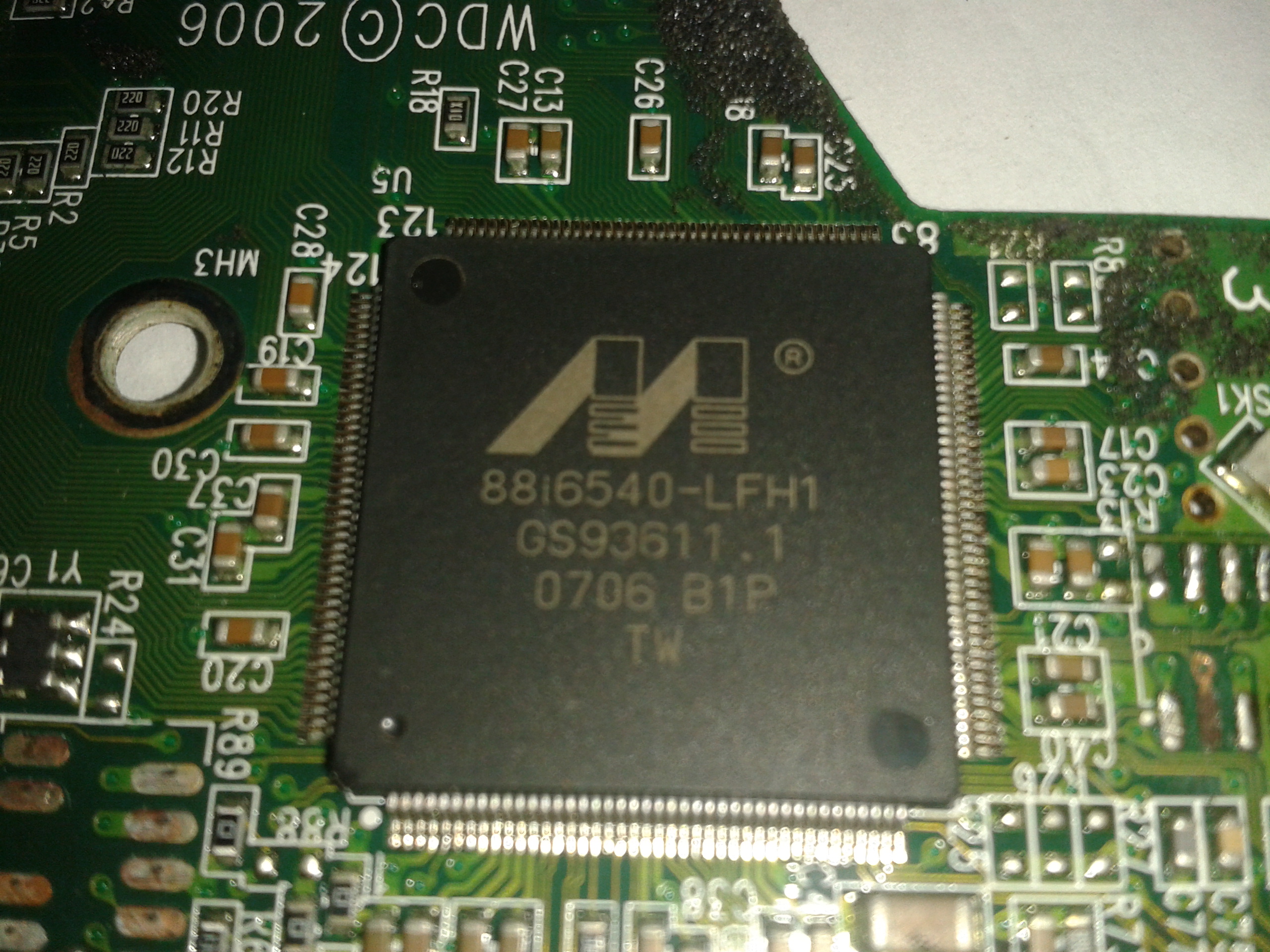

 Post subject: Repair PCB, need ROM short point PCB 1292
PostPosted: February 12th, 2018, 17:05
Joined: January 11th, 2018, 18:09
Posts: 35
Location: egytp
need short point PCB 1292 to terminal write ROM

Hi, what do you think you will accomplish on shorting on that pcb?

There is no terminal on that pcb, for read/write ROM you need to put the pcb in safe mode by use jumpers...or through ATA with right programs if pcb is healthy....otherwise move ROM chip to a new board.
