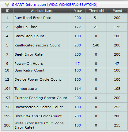

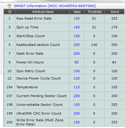

I have a pair of Western Digital Red hard drives in a RAID 1 configuration via a Vantec NST-400MX-S3R hard drive enclosure. I've been running this setup for ~4 years and would like to verify the health of the drives, in case either needs to be replaced.
JMicron HW RAID Manager software was provided with the enclosure but it does not provide much, in this context, other than SMART information.
Normally, I would use Western Digital's Data Lifeguard Diagnostics software to check drive health but, in this case, it would just check functioning of the RAID system rather than each drive individually.
Any recommendations?
The SMART information from the drives is troubling. Maybe I should replace purely based on that?
File comment: Drive 2
File comment: Drive 1

What do you see that is troubling you?
Smartmontools should be able to provide the raw attribute values. These would be more meaningful than the normalised data.

I don't know much about SMART information so I perceived some current and worst values being higher than threshold as a bad thing.

As for the Current and Worst values, higher is better. It is only when these values begin to fall toward the threshold that you need to worry.
https://en.wikipedia.org/wiki/S.M.A.R.T.
Thank you for clarifying. In this context, my drives seem to be in pretty good shape.

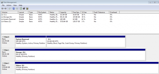

The separate drives are not visible to Windows so I don't think there is a way to do this.
Back to my original question, is there anyway to run extended test, etc. on each drive individually?
