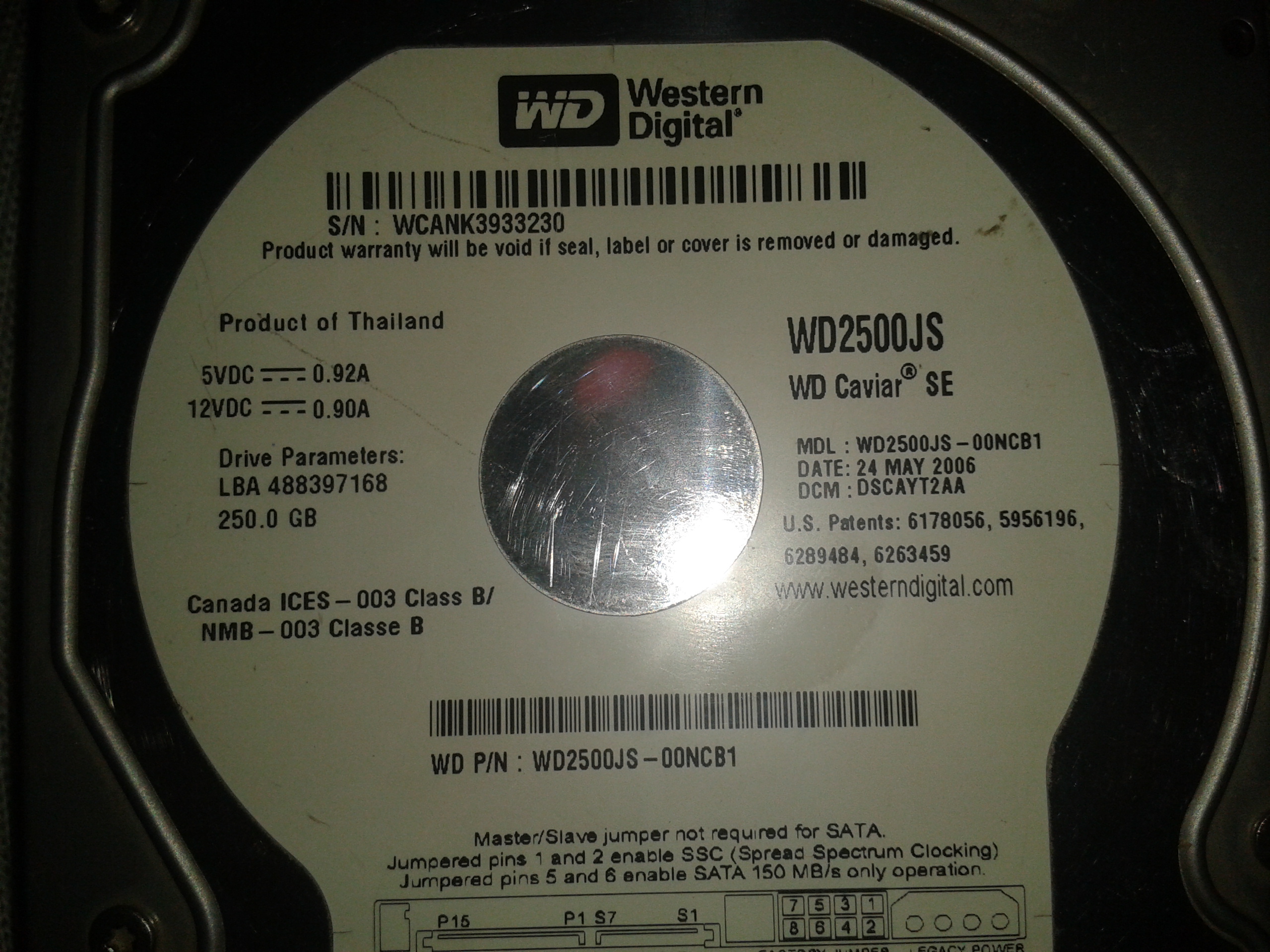

 Post subject: I want firmware
PostPosted: February 22nd, 2018, 17:12
Joined: January 11th, 2018, 18:09
Posts: 35
Location: egytp
I want firmware
S/N:WCANK3933230
MDL:WD25000JS-00NCB1
DATE:24 MAY 2006
DCM:DSCAYT2AA
LBA 488397168

Client Clear firmware :oops: :oops:
What is the family of the drive :?: :?: :?:
PCB :13335

I do hope that you do not need to recover the data on this one:No Did not matter
Client used something like WDR as well to clear firmware ?Yeah That's what happened
You can't just write firmware from other drive if you need the data:There is no
What do you see with WDR ? Does it enumerate modules at all ?
WDC ROM MODEL-HAWK----- FW:02.01C02 SN:WDC-ROM SN_ XYZ---- (ROYL selected) port 0x1F0
Logical: Cyls 15528, Heads 16, Sectors 63, LBA 15651217, 8Gb
Controller Buffer Size: 8192Kb
Family: Hawk
