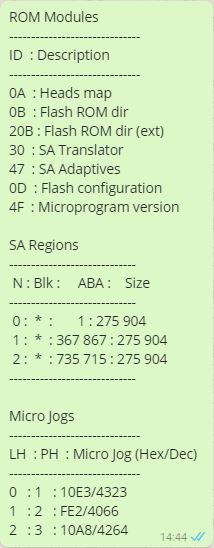

finally we suspect ROM may not be native , but there is no way (like Seagate F3) to check S/N ( at least I don't know) , (attached is ROM)
We tried donor rom and tone of sound changed & disk continued to spin (does not spin down)
What could the issue ,since we don't have access to modules Rom cant be regenerated, We have tried 15-20 Roms but its of no use.
Can someone pls. suggest a remedy or at least pin point exact technical issue ?
I am attaching all details of hard disk.

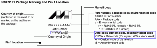

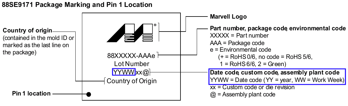

 Post subject: Re: Extreme Complex Case , Is someone ready to accept challe
PostPosted: March 5th, 2018, 13:36
Posts: 17335
Here is an example:
