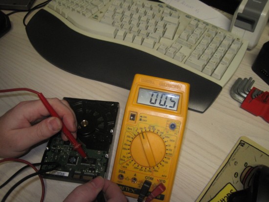

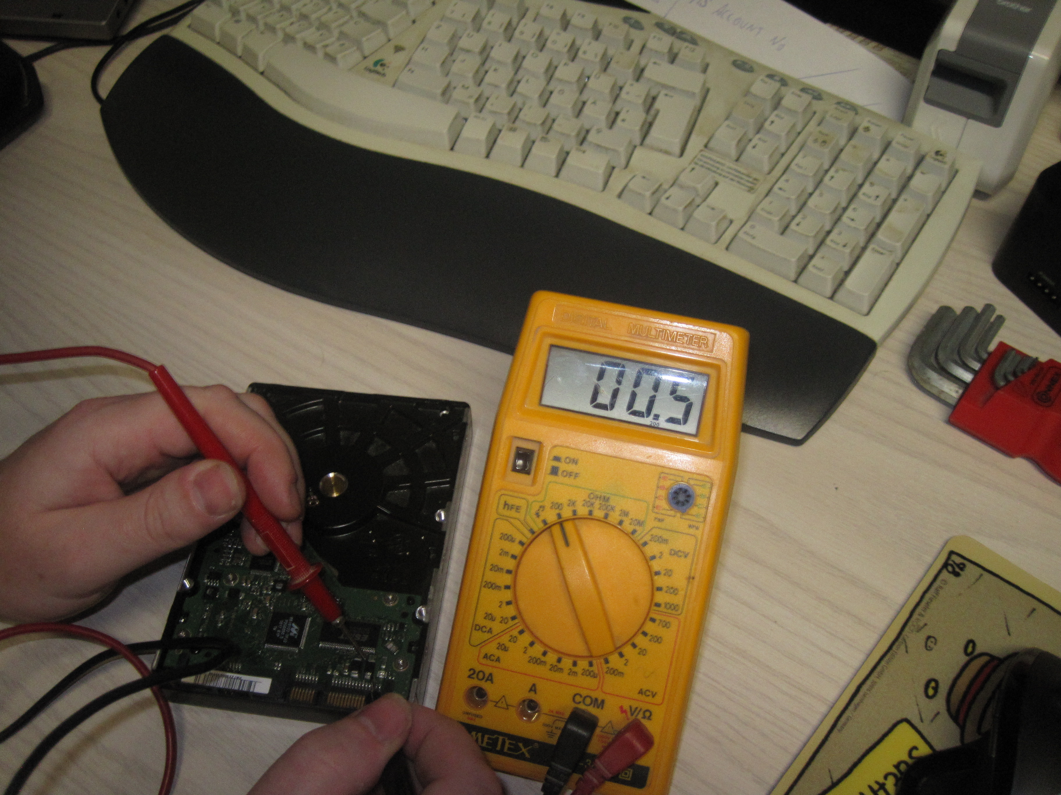

I measured as described here:
viewtopic.php?p=166418#p166418
And then I looked at those:
http://www.users.on.net/~fzabkar/HDD/HD204UI_TVS.jpg
And it seems that the 12V is broken, as I measured a very low resitance with the 200 Ohm setting.
Now my question - under the assumption the data is ruined anyway.
Is it worth to spend the time to fix this 12V link in case, that the drive could spin up again with the "old" PCB and is then maybe recogized again?

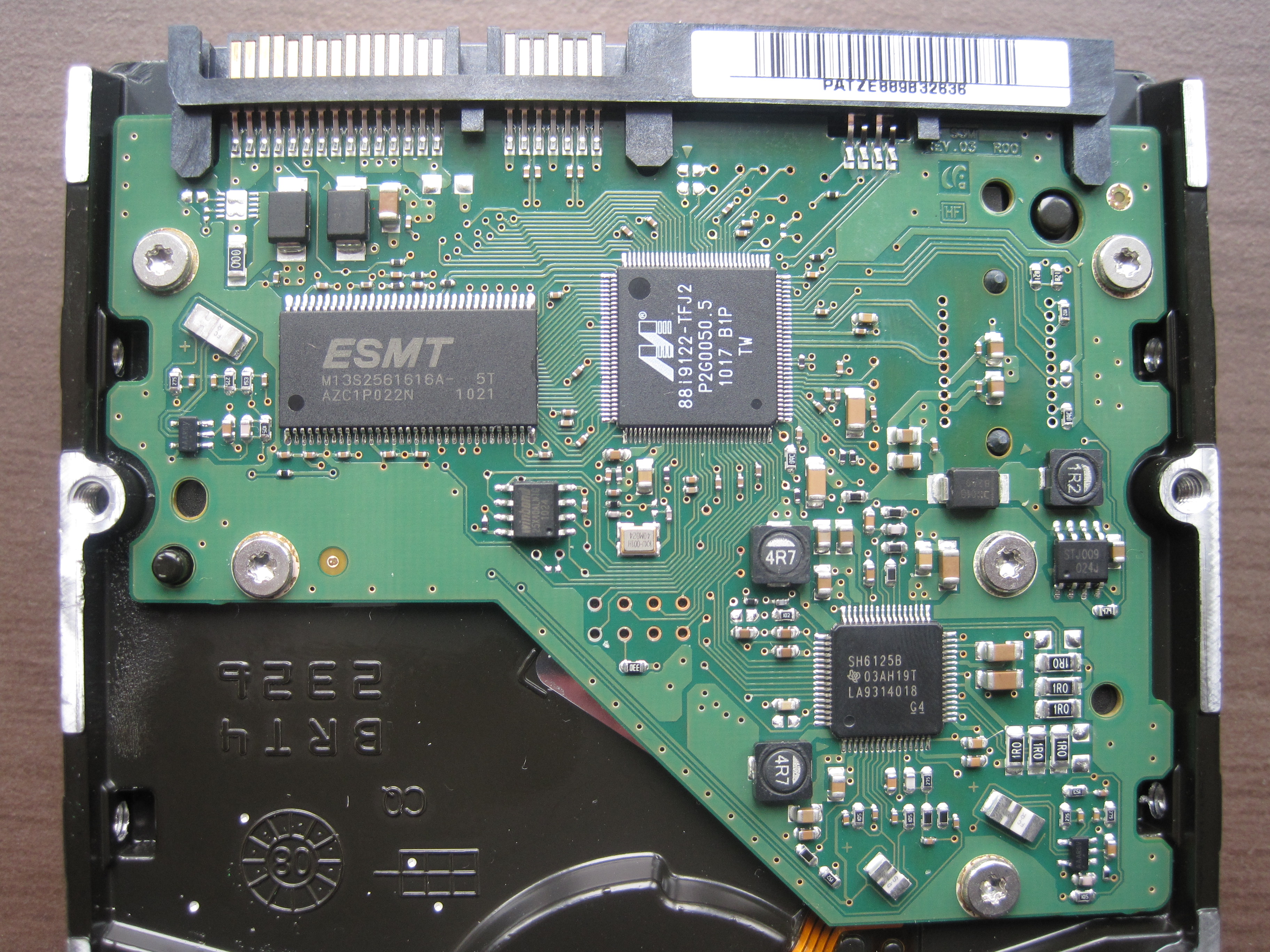

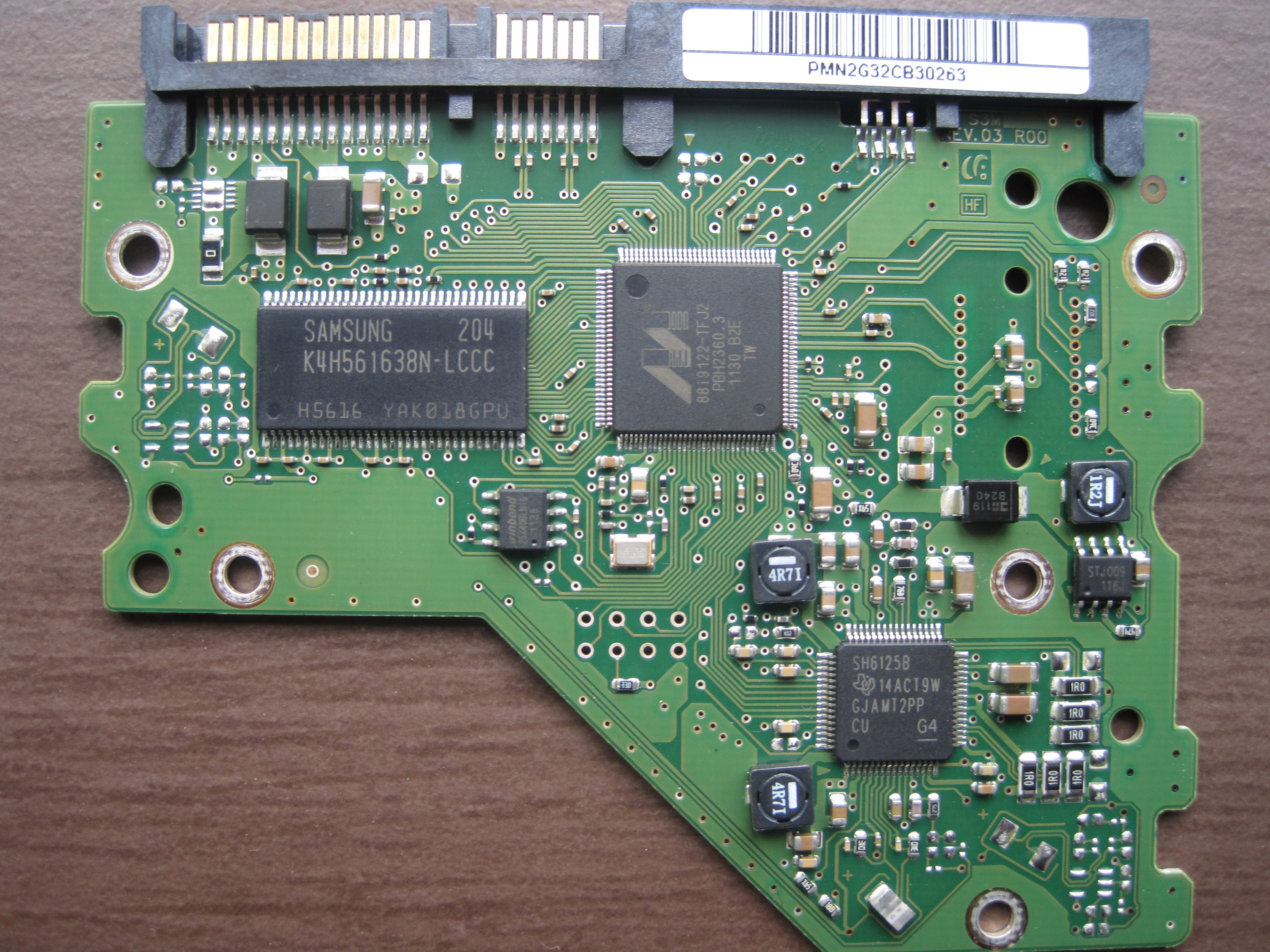

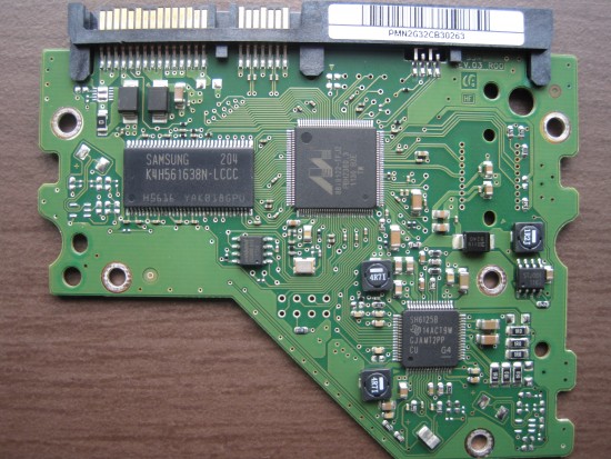

File comment: The PCB I found on Ebay, which spins up the disc

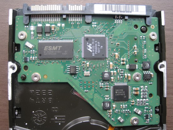

File comment: The original PCB, which does not even spin up the disc

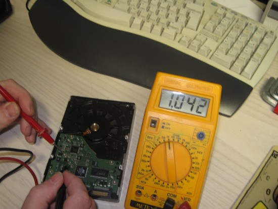

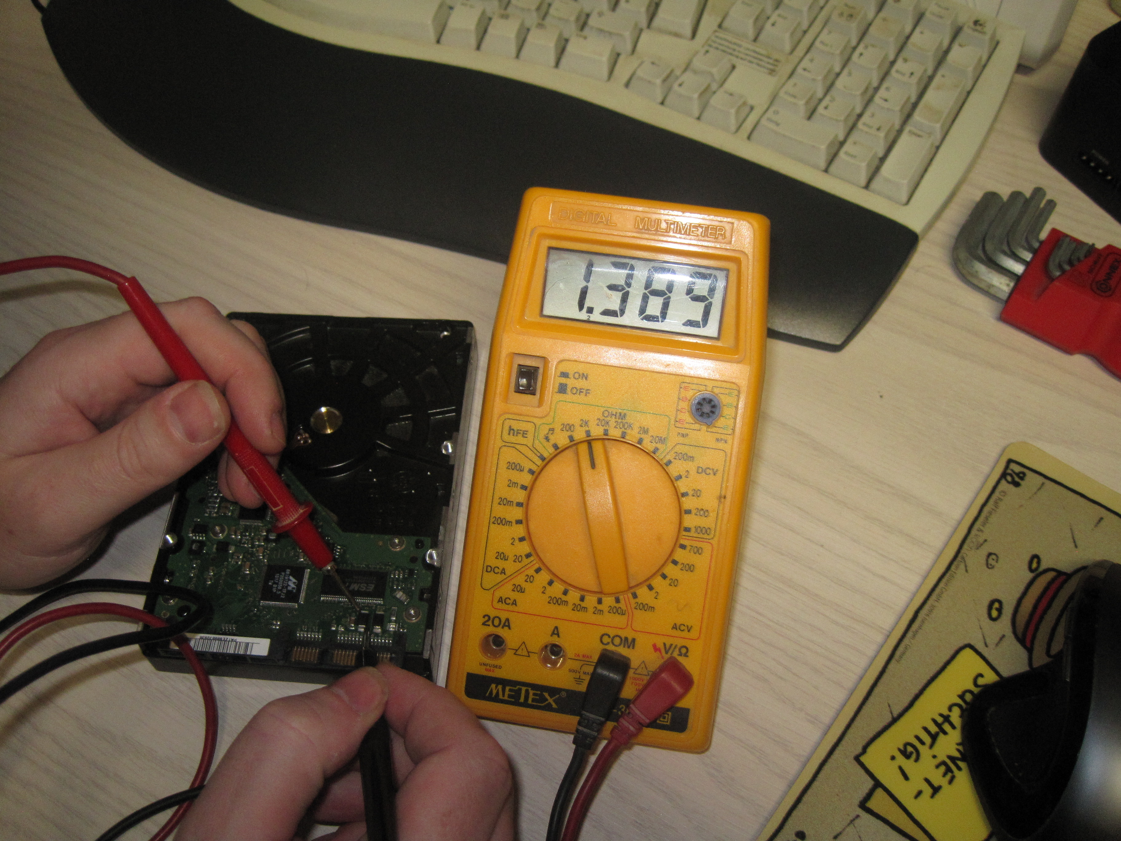

Hi fzabkar,
the 0 Ohm shows no reaction on my Multimeter.
I tried from the 200 to the 200K range.
Not sure if it is an error 40.
Thats why I just attach the pictures with my measurements.

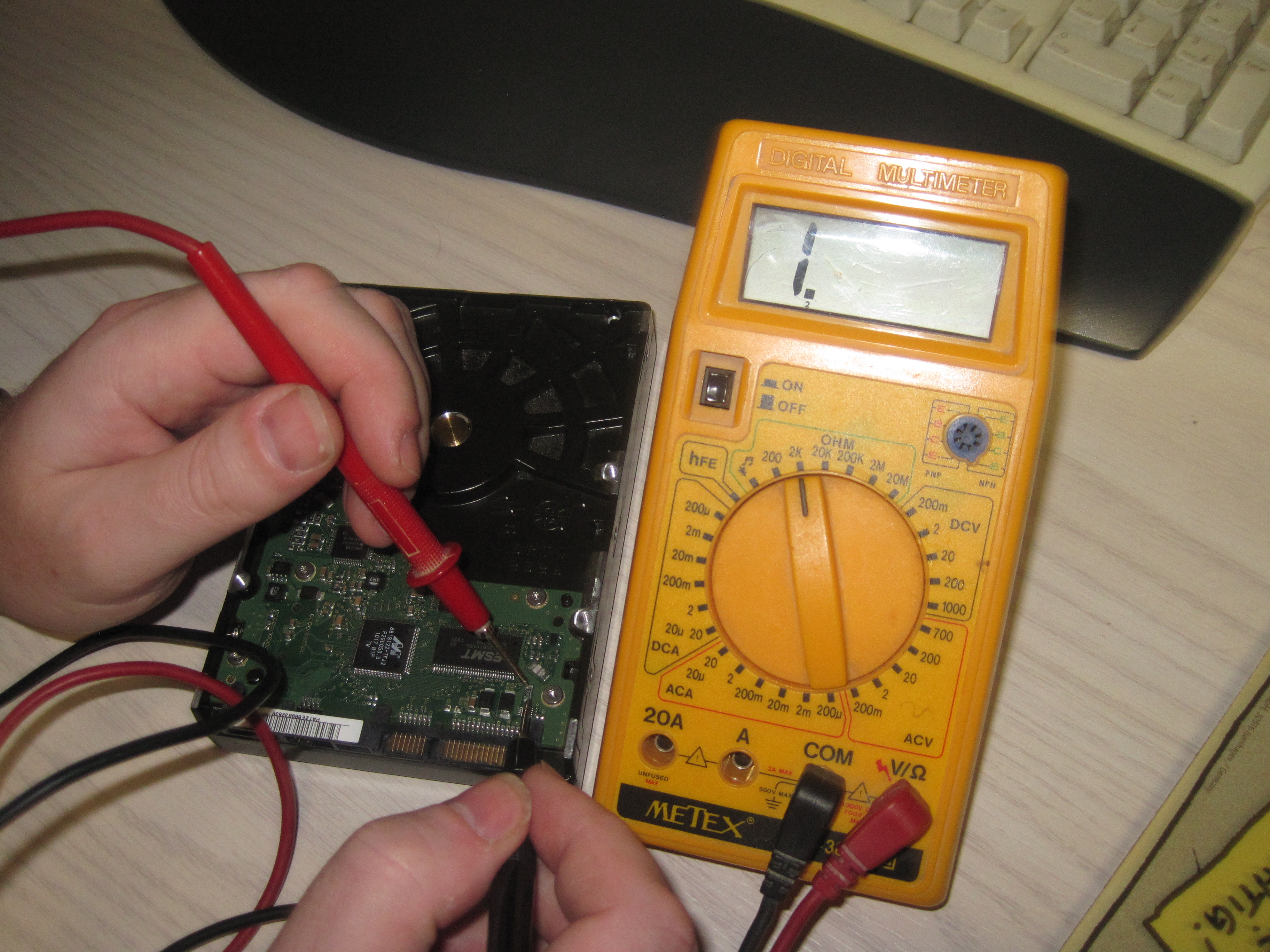

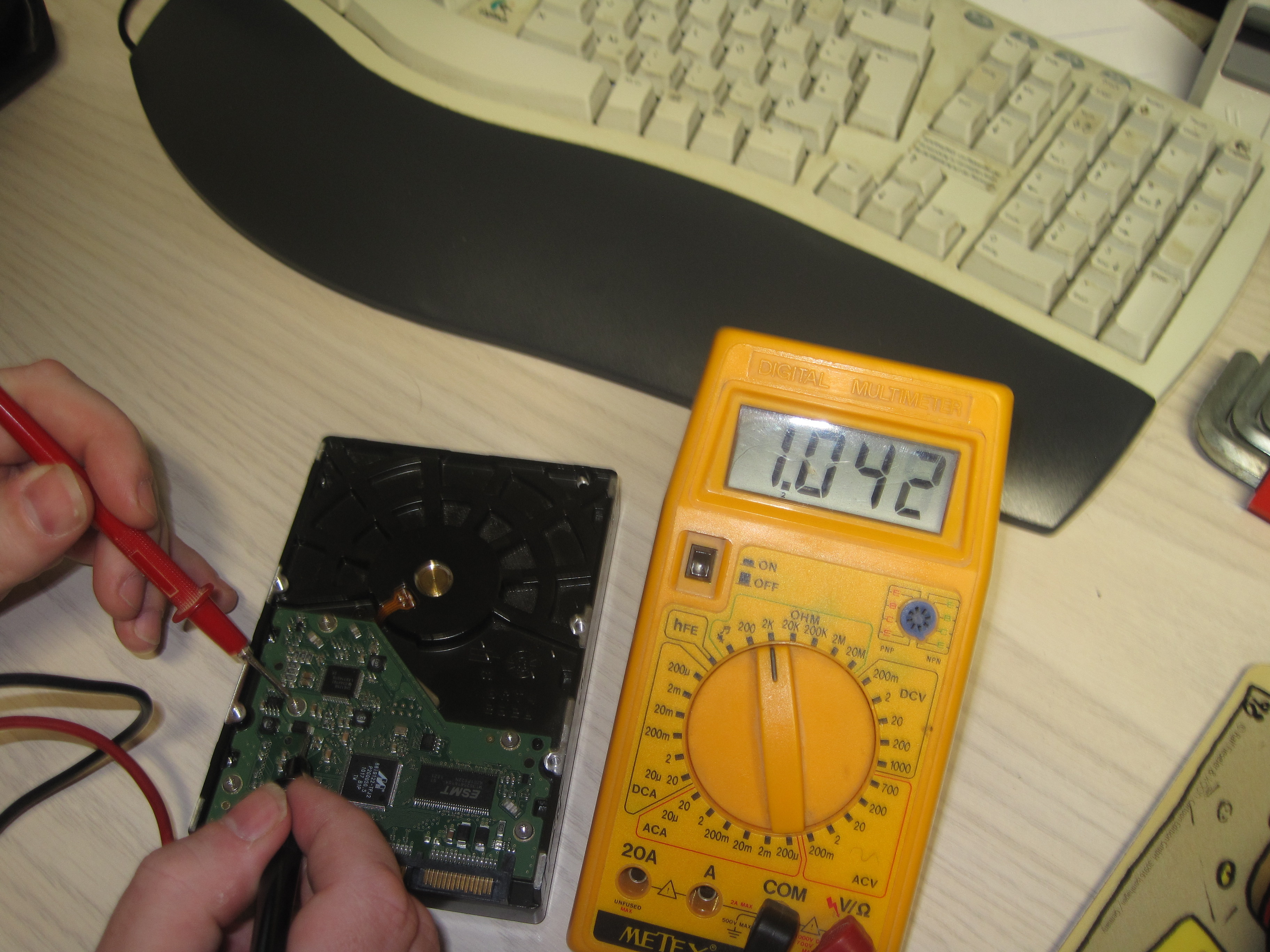

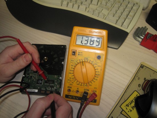

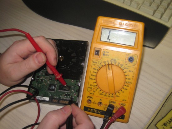

The 12V I measured with the 200 Ohm, the three other pictures are with the 2K Ohm.
File comment: 5v neg TVS
File comment: 12V TVS
File comment: 5V TVS
File comment: 0 Ohm

The 12V TVS diode is shorted. You need to remove it.
The zero-ohm link is open circuit. You need to bridge it with a blob of solder.
After you have done your repairs, test the PCB off the drive. Be aware that your PCB was damaged by an overvoltage on the 12V supply, so make sure your PSU is producing the correct voltages.
