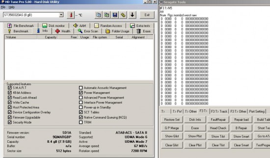

firstly st3500320as does not spin. i cleared the motor and head contact.
i want to test PCB without screw it. only pushing on case. after that drive spins. sounds O.K. no weird..
but at that moment remove the power without check the data.. because PCB needs to change.. it has one burning pin at 5V supply. i promise to owners what i will change PCB.
i did it but at this time drive didn't spin. head stuck issues says hello.
i think this is because of sudden unplugging power cord. (i already didn't screw the PCB) .
i release the head gently. now drive spins normally. no weird sound. But it seems only 8 gb.
Smart data and temperature can't seems.
i do bsy fix and clear smart but it's useless. Someone says i must load The LDR
Somebody help me with teamviewer? or what can i do?

original one's power socket (plastic) is broken. someone can plug the power cable reverse position.
i want to change PCB for that reason.
both pcb are O.K. i test second one after swap rom. but this second pcb was extracted from a motor seized disk.
is head stuck infectious?
My clean room is bathroom.. No dust fall on platter.
i think heads are O.K.
PC sees Hdd at windows and boot screen but lately. i can update the firmware (SD1A)
how i can test the heads?
i think some parts of SA (specially sys file 133) is unreyadable.
I might not have broken it. :?
there is no difference at this process. maybe it already seems 8gb.
dirty PCB contact can harm to disk.
need to recover..
rogfanther wrote:
You are using the second board, aren´t you ?
Try again with the original board.
Also, post here the terminal log.
there is no difference with both of them..
no weird message at Terminal log.

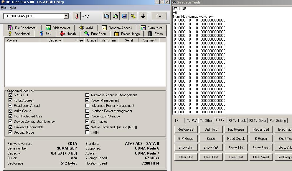

 Post subject: Re: Seagate ST3500320AS seems 8Gb
PostPosted: March 14th, 2018, 4:16
Posts: 210
Location: istanbul
all value 0 at Smart...
PostPosted: March 14th, 2018, 11:59
Posts: 713
Location: Brazil
Well, you have some tool to access the drive terminal, as your N5 picture shows.
Yet, you still haven´t posted the terminal log, as requested. So, it seems you do not need the data from the disk anymore. Good, because probably you wouldn´t be able to rescue it anyway.
PostPosted: March 18th, 2018, 10:21
Posts: 210
Location: istanbul
i tried this disk at xp machine.
yesterday i plug this disk to win 7 system. Disk was seem 0 Mb..
Then idea bulb flashes in my mind. :idea:
i tried standart bsy fix again.
clear g-list
regen translator m0,2,2
and i clear smart.
and disk's now accesible. :yayaya: Thank God. :please:
All data's succesfully recovered except some unnecessary files.
And YOU MUST KNOW that tired PCB may cause head stuck. It happened twice.
Motor stuck causes overheat of Motor Chip.
