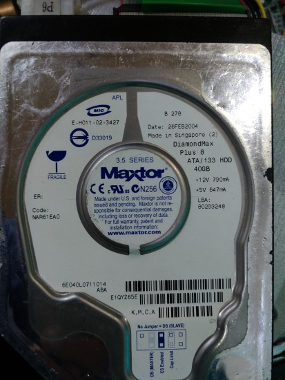

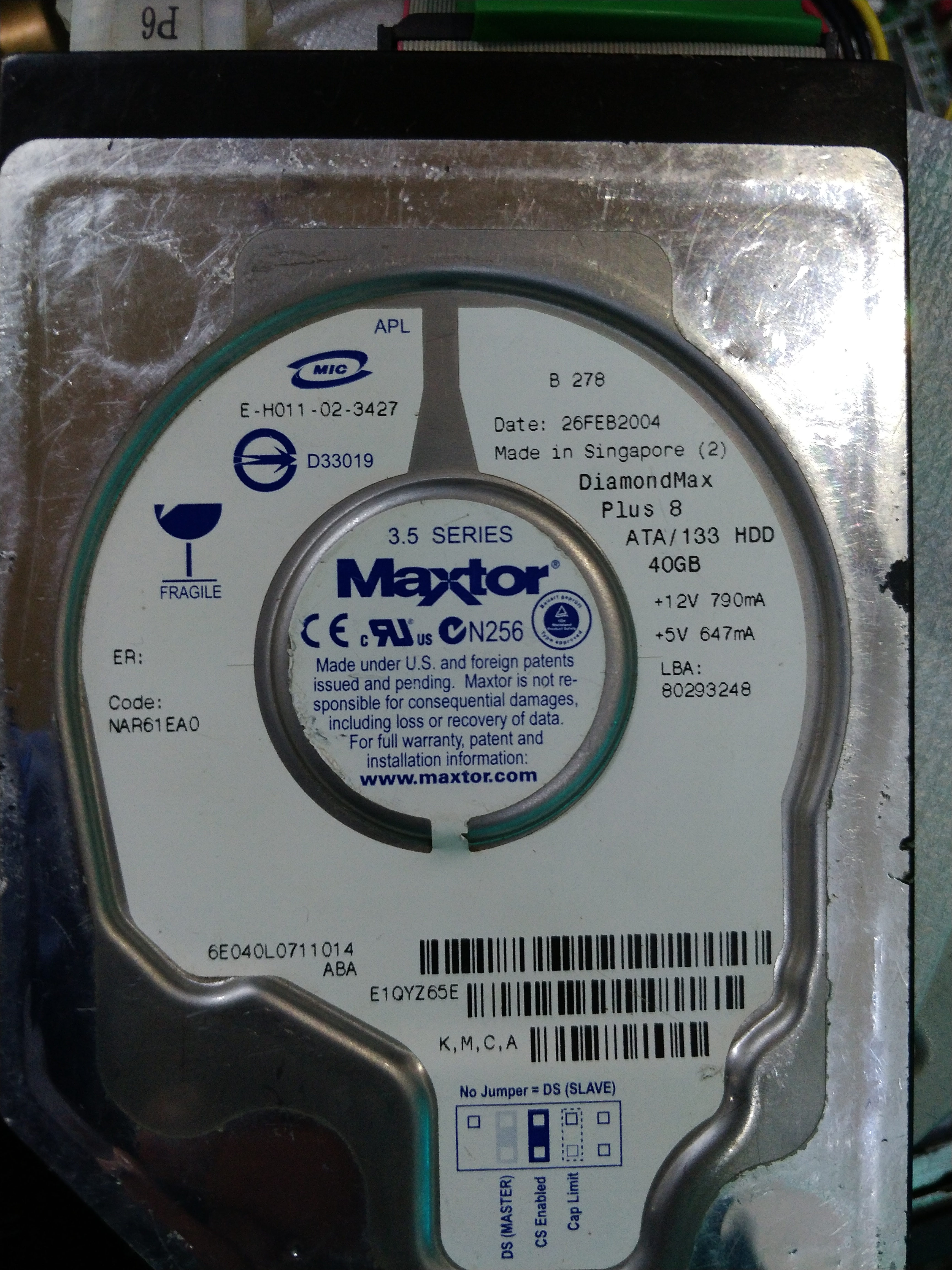

Hello guys i have a probelm i changed The motherboard of my Maxtor IDE hard drive so i can recover data from it the problem i have is that one motherboard shows only 8gb in space aand the other one 0.00 GB so i thought i need a firmware update My info are
Maxtor 3.5 Series
DiamondMax plus 8
ATA/133 HDD 40 GB
LBA8029248
Code:NAR61EA0
6E040L0711014
ABA
E1QYZ65E
K,M,C,A

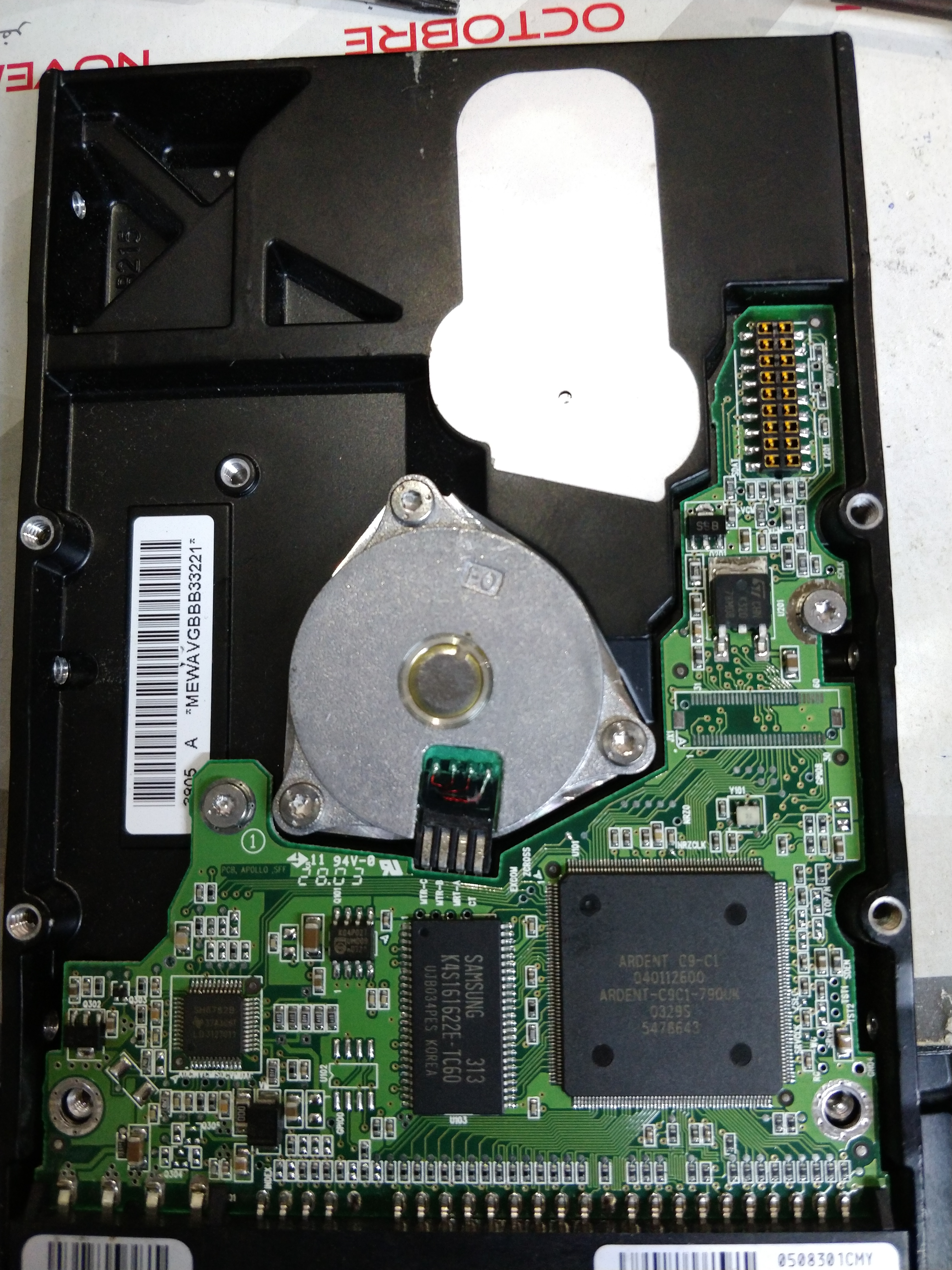

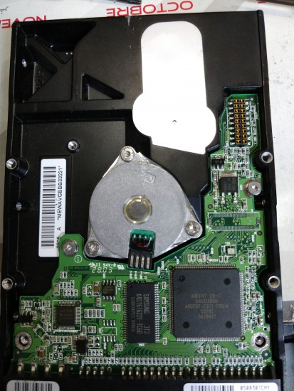

where is the rom chips you where talking about i attached my motherboard image

I do not have my annotations ready, but from memory you would need a board with the same firmware version as stated in those barcode stickers in the connector part of your board. Or would need the right software to read it from the MCU ( the big chip in your picture ) from the original board.
If you lost the original board, well, at least you would need good pictures of the entire drive so that one can see the codes.
Lacking an adequate tool, had to sift through a big pile of drives once to find a compatible one. I didn´t like those Maxtor slim drives, and that work just reinforced my opinion.

@yassintrancer, this page tells you what to match:
https://www.hdd-parts.com/20091329.html

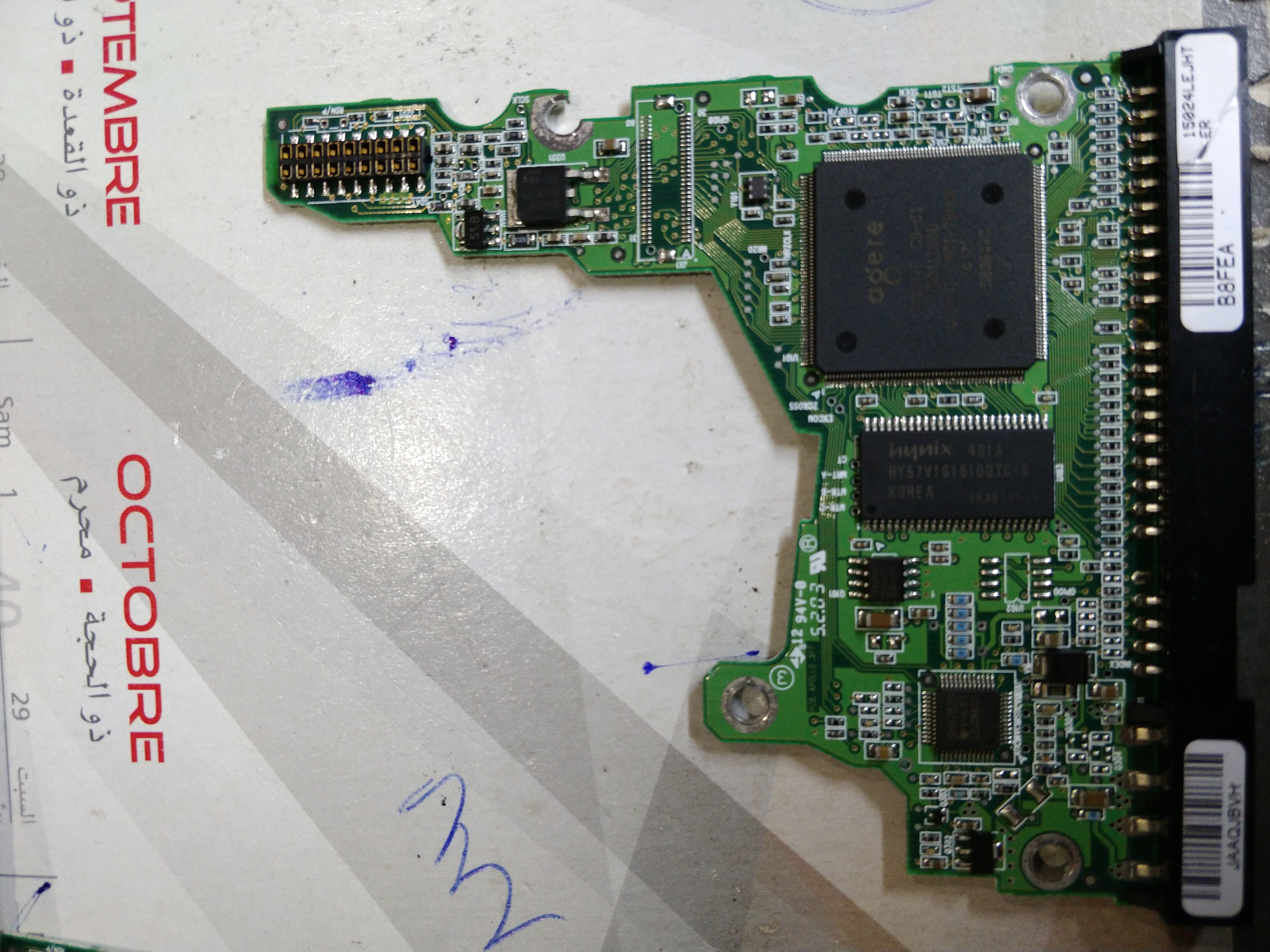

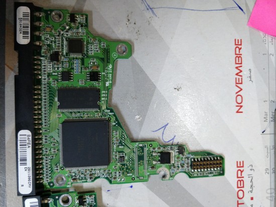

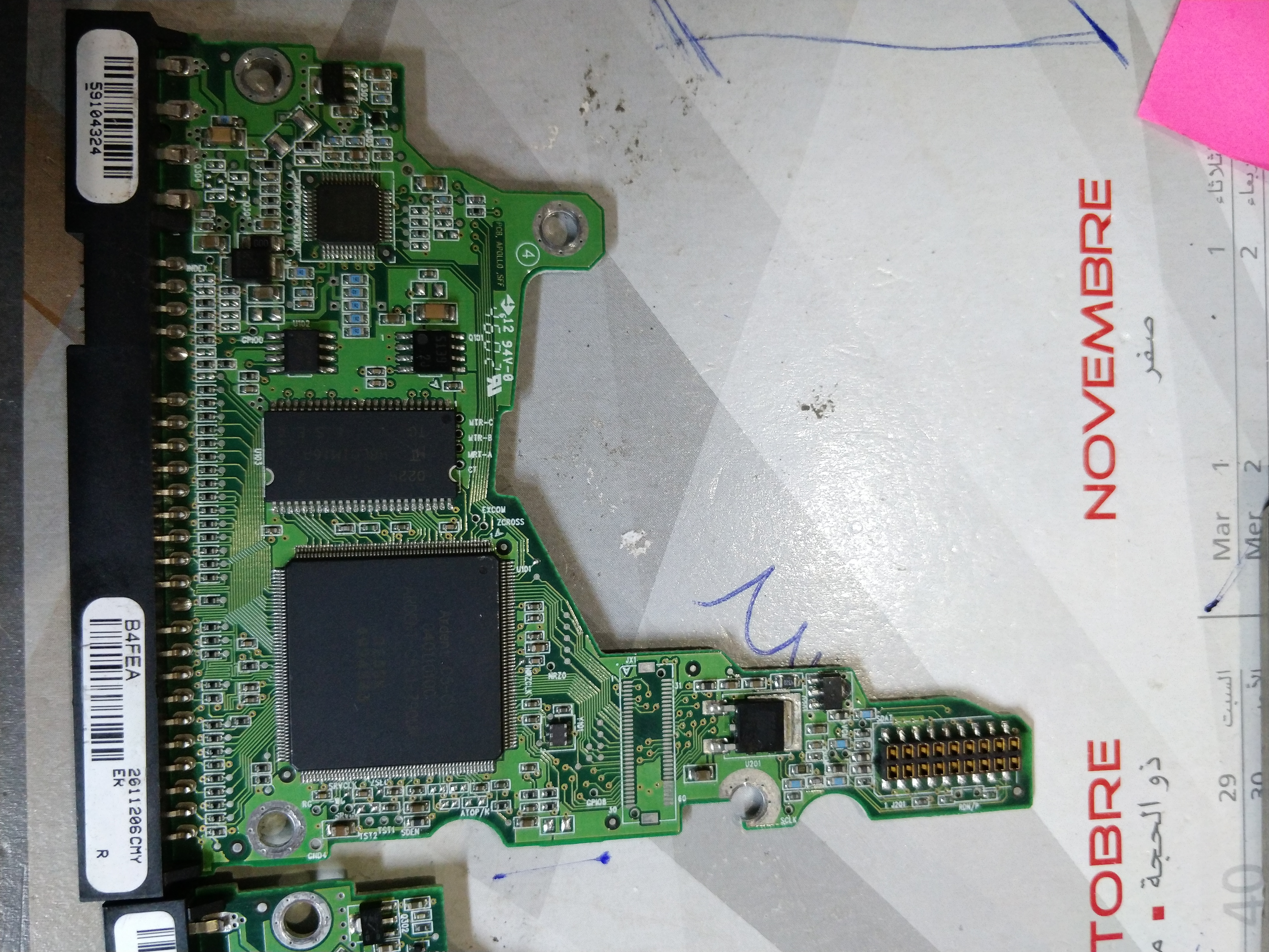

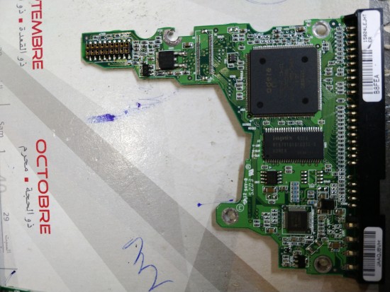

here it is but i dont have my original board those are the two i have right now but i will try to find other ones tomorrow
i dont care if they get dammaged in the process i just need to get my data back ill give it a try

According to hddparts.com, you need ...
    Code (on label): NAR61EA0
    Model (on label): 6E040L0
    Main controller (on original PCB): ???

No i lost the original long time ago those are the only i have right now
 Post subject: Re: Maxtor 3.5 Series Firmware ISO Help urgent
PostPosted: March 16th, 2018, 14:48
Joined: March 15th, 2018, 16:00
Posts: 46
Location: morocco
Okay i will try different pcbs :(

99% certain this will have other issues apart from PCB.
Most common issue is overflowed GList on N40P
I believe there was a free “fix” for this somewhere on the net.
PostPosted: March 16th, 2018, 16:42
Spildit wrote:
Agree !!!
But the first issue is to find the PCB that will work or get the ROM from SA to flash on the available PCB. Only then you can check SA.
The "free" fix was a very old DEMO of a SD tool but it's LIMITED to Maxtor 541DX (2B020H1 2B010H1) - "Maxtor Athena". This tool will NOT WORK on N40P. The tool is posted on my site (SD Section) and also on the HDDGuru file section ...
