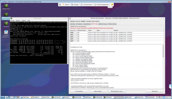

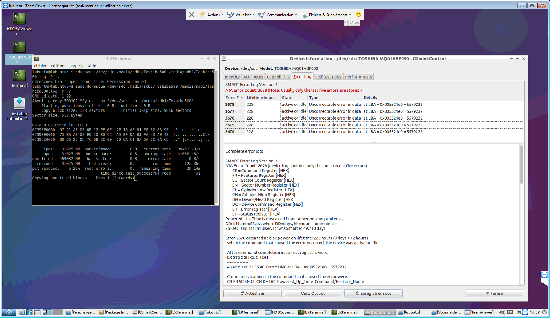

Someone asked me to recover data from a laptop computer HDD (Toshiba MQ01ABF050, 500GB) which, supposedly, has only been reformated by mistake. But it was reformated by the owner's father because the computer was acting up for an unknown reason : failed to boot, got stuck with an error message or a blue screen or whatever, I don't know the details.
To be on the safe side, before attempting any "in place" fix, I removed the HDD and I'm currently imaging it with ddrescue : all goes well, about 3 hours to go.

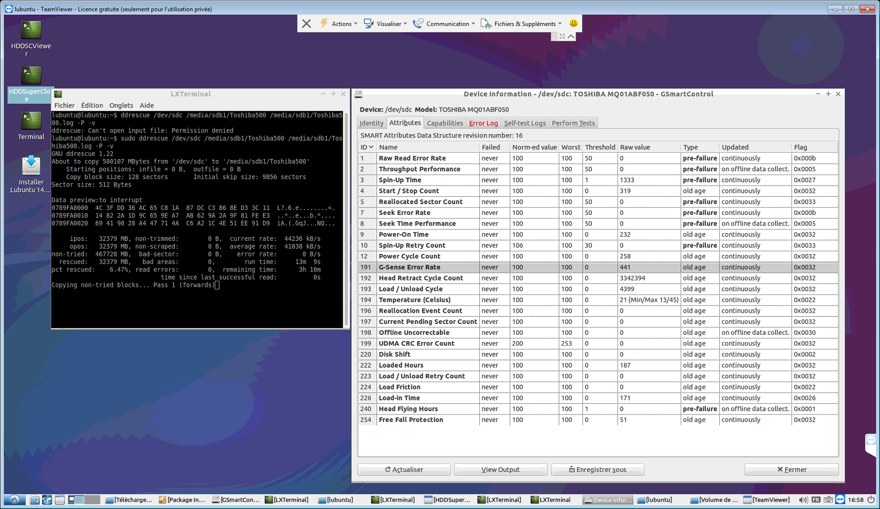

GSmartControl indicates no reallocated or pending sectors, but there are several "Uncorrectable error in data" messages in the Error Log, at the same LBA.
Is the drive safe to use again ? What could be the cause of those errors ? I made a quick search : it may be related to an inadequate power supply, or a bad cable/connector. The computer is a Sony Vaio running on Windows 8, with no sign of damage, the battery and power cord are both original and appear to be in good physical condition.
Also, I see quite high numbers in the "G-Sense Error Rate" and "Free Fall Protection" fields : does that mean that the computer was seriously mishandled, or is that typical for a laptop computer with that kind of HDD ? (Most I've seen before for "G-Sense" was 5, on a 2.5" 500GB Seagate drive I bought used, which also reached a maximum temperature above 70°C, and which I don't trust for sensitive data for that reason, even though it has no bad sectors.)
Thanks.

The drive is perfect. The Error Log is for factory use only. You shouldn't open it.

The error log indicates that there could very well be a bad sector on the drive. You will know for sure when the ddrescue imaging completes. If it completes without errors, then the drive is okay.
At first I thought the sector reported bad in the log was at about 2.85GB, but then realized that the high order registers are not present, so it is most likely a higher LBA. You will know when the imaging is complete.

Thanks for those replies.
Well, then why is it there at all in GSmartControl ? (Which seems to be aimed at regular users.)
It completed with no error indeed. What are “high order registers” ?
And so, what could be the cause of those errors ? Could it be consistent with a software / system related issue ?
Apparently this drive (and the whole computer I assume) has been used very moderately (232 hours, 319 start/stop counts), so how can it have such high values in shock/vibration related fields ?
I've been testing the computer's RAM for a few hours with Memtest86+ : no error whatsoever.
Below is a copy of the detailed report for each logged error.
I've seen this thread a few months ago (soon after I registered on this forum actually), and marked it for further in-depth reading and testing, which I haven't done yet (so many things to do, so little time). Some of it seems to involve quite advanced procedures, with tools I haven't or couldn't even dream of having at the moment. But it sure is an instructive read.

The SMART error log is a user log, not a factory log. The factory log is something else.
Did the Reallocated Sector Count or Current Pending Sector Count change after the cloning?
The Head Retract Cycle Count of 3342394 is best expressed in hex:
    3342394 = 0x0033003A -> 0x0033 0x003A -> 51, 58
It may be a coincidence, but these values appear to be related to the Free Fall Protection count (51).
High order registers are another way of referring to 48 bit LBA access. It appears that GSmartControl used the read log command, the read log extended command would have the extended high order registers. You could use smartctl to read the extended log.
smartctl --log=xerror /dev/sdc
The fact that there were no errors when imaging, and no pending or reallocated sectors in smart, would indicate the possibility that there was a bad sector, it was rewritten (perhaps during the reformatting), and there were no issues so it is good again. So with the information provided, it would seem that the drive is healthy.
When looking up how the drive may produce the G-Sense Error Rate provided a possible answer that could be very simple. It could be a count of how many times the drive experience a level of g force that caused it to abort a write. This is a safety feature and could only take a very small bump to trigger it. Values are vendor specific (and also likely drive specific), so unless you can find the exact meaning of the value for that drive, I would not read too much into it.

The error log indicates that there WAS an unreadable sector and the drive tried several times to read it. During the format this sector was rewritten and came out to be a GOOD sector, so there is nothing to worry about.

No, reallocated and pending stayed at 0. Interesting observation.
@maximus
I'll have to search more information on that matter to get this clearly, right now it's not the priority...
Alright, so I'll stop worrying about the hardware part.

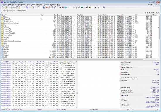

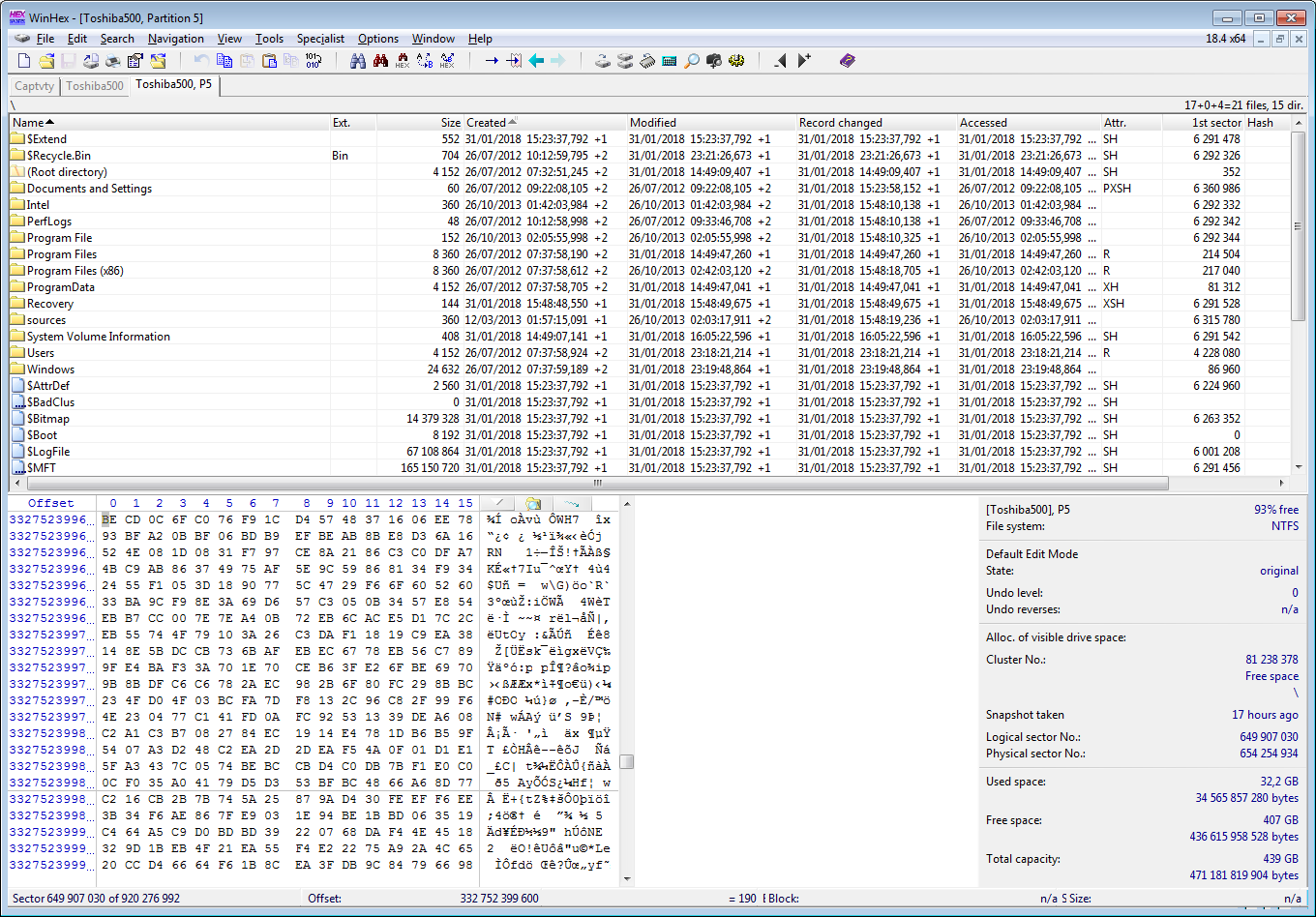

Now, the main issue is that I can't find anything that looks like personal files/folders on that thing. There's a 438GB partition starting at 2.07GB, the only one that could contain relevant data (before that there are two EFI system partitions, one 1.44GB partition called “Windows RE tools”, a 128MB “Microsoft reserved partition”, probably related to GPT partitioning, and after that, at 440GB, there's a 25GB “Recovery” partition) ; it does contain a Windows install, program folders, the usual. It was supposedly reformatted, so I scanned the whole image with R-Studio, expecting to find many files from the former install : it finds a total of 206GB of files, but this includes a 150GB R-Drive image and a 10GB “QEMU virtual disk” which are very probably false positives. “Users” is almost empty, and there's not much interesting in “Extra found files” either. The owner said that she had pictures for instance, but only 8 files are detected in “JPEG Digital Camera”, all linked to the Windows folder or the programs' folders. There are just 2 MP3 files. I'm currently running Photorec, but I doubt that it will find much more, R-Studio is becoming very efficient at raw file carving, and JPEG files in particular have a very definite pattern, they are unlikely to be missed.
And yet the drive is full of “something” : if I open the partition with WinHex I can see non-zero data up until the very end, the “free space” is anything but free. Even if the Windows reinstall overwrote a great amount of former files there should still be some remnants, either as raw files or as MFT records, right ? Perhaps the partition was formerly encrypted, which would explain why nothing from it can be identified ; is there a way to determine this ? Could there be another explanation ? (I'm wondering if the HDD is indeed the original one, or if the owner's father replaced it without telling her when he “fixed” the computer... that would be another possibility... Some people “fix” a computer like veterinary doctors “fix” a dog ! :) )

Again, is there a way to determine if the volume was formerly encrypted, and what type of encryption was used ?
In that case, is there any way to access the data that used to be there, or is it a lost cause ?
I scanned the whole drive with Photorec, with almost all file types activated : it only found 25,1GB worth of files, with only 103MB of JPG images (all seem to come from Windows / programs folders).
And yet, as I said earlier, there's data all over, see attached WinHex screenshot.

Damn, that picture has been seen 50 times, but noone has any clue or opinion on that matter ? :?
Are there particular sectors to look at for particular patterns that would hint toward particular kinds of encryption ?
The owner (well, actually her boyfriend) said that the drive is indeed the original one, and that it most likely was not encrypted, at least intentionally. But then, what are those 400GB of junk bytes, and how could a quick format and Windows re-install remove every single trace of the former files and folders ?

Could just look visually in hex space and see if data looks encrypted. Or search for simple/common keywords in RAW space with Winhex. If you get hits, then it is not encrypted.
Well, you saw the picture... How should encrypted data look like ?
As far as I can see, this seems like totally random data with no distinguishable patterns, or similar to what can been found in the middle of a compressed video file for instance.
If it's not encryption, then what could have overwritten a whole partition with totally random data ? (Well, a write test with HD Sentinel set to “random data” could do that, but something like this would be very unlikely here.) Is there a stupid option or “feature”, when re-installing Windows 8, or when activating the “factory recovery” on a Sony Vaio laptop computer, which could lead to this ? Like, “you want to format your computer, we assume that you have something to hide, so we will make sure that neither God nor the NSA can ever figure out what you were up to, now click OK if you agree, or Cancel if you're angry, or Whatever if you're hungry”.
I scanned the whole drive with both R-Studio (most common file types activated in “extra search for known file types”) and Photorec (almost all file types activated), both found nothing more than the current data, despite the fact that the whole drive – or more specifically the whole main 438GB partition – has data all over, I can't see any spot with empty sectors in the free space. So both of those reputed softwares recognized no pattern of common file types beyond the current files and folders, which form a basic Windows 8 install with the default programs supplied with that Sony Vaio computer.
(As a side note, what could be “simple/common keywords” for a search like this, without knowing even vaguely what kind of data was supposed to be there before ?)
