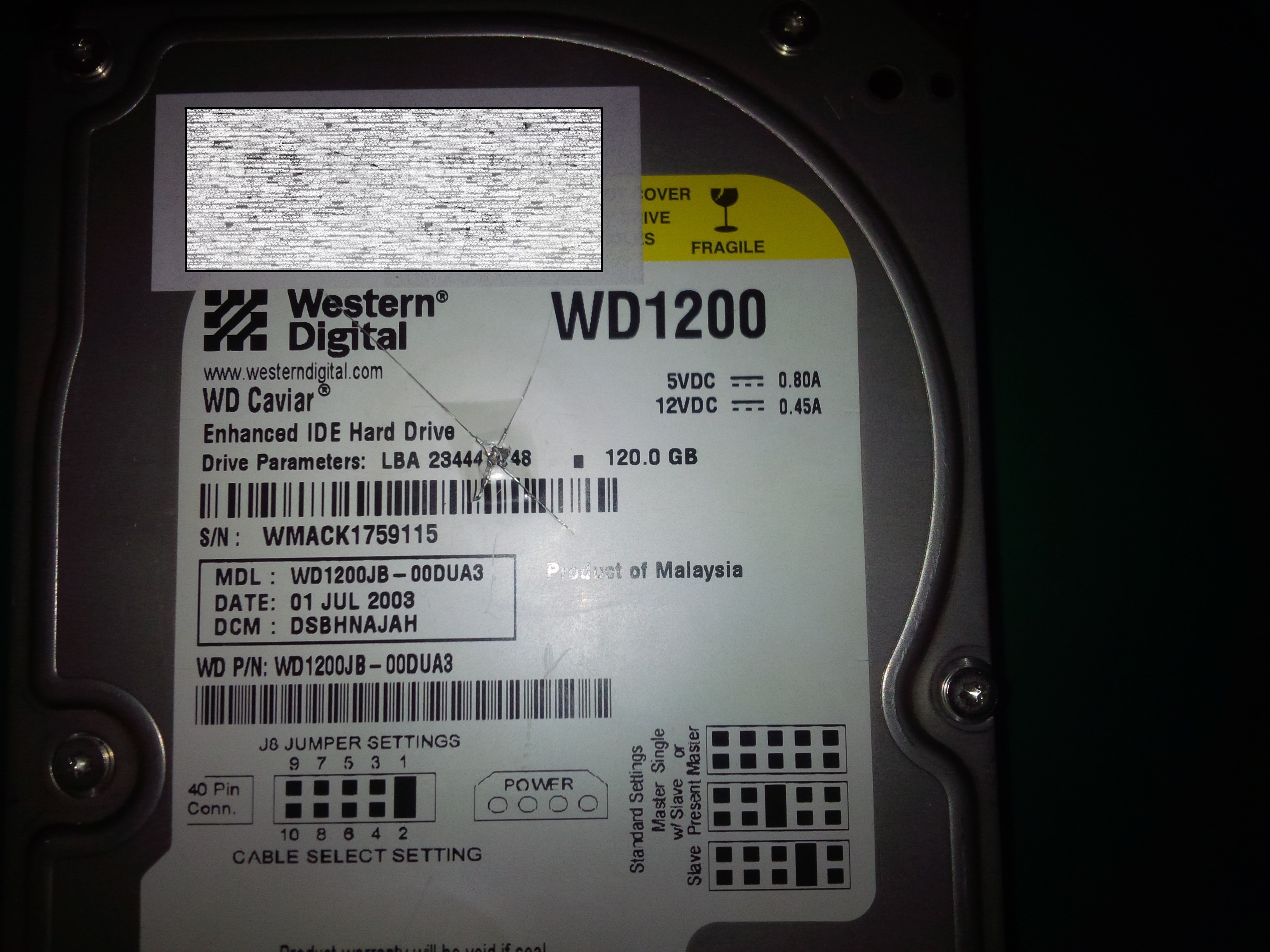

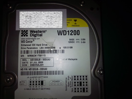

 Post subject: Re: Donor for old wd drive WD1200JB-00DUA3
PostPosted: March 19th, 2018, 8:28
Joined: February 26th, 2016, 5:02
Posts: 81
This is a picture this hdd
