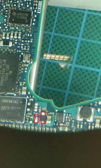

Hey guys,
I've received this HDD from a client, upon plugin it to MRT i've seen DS3 led blinking.
I believed it was a short circuit issue, and I've removed the diodes [they were both marking 129]. (picture below, removed marked in RED)
I plugged it again and drive wouldn't spin. (again DS3 led blink)
I believe I need another PCB to swap ROM and clone the drive.
Am I wrong ? Would you suggest anything else?
Thank you!

Did you check the fuse?
 Post subject: Re: HTS541515A9E630 / 0J24371 DA5471
PostPosted: March 27th, 2018, 5:36
Posts: 413
Yes, they were bad. I removed them and still no luck.
PostPosted: March 27th, 2018, 7:16
Posts: 3551
You need to replace the fuse, not remove it.
PostPosted: March 27th, 2018, 7:22
Posts: 413
News flash,
My issue is with my MRT board, that now I see that every new disk I connect on CH_0 or CH_1 I get a DS3 blink error, probably caused by some malfunction on the board.
FML really.
I can now access the HDD by powering it with a regular power cable, but I can't manually keep soft resetting because HDD keeps goign to BUSY state.
