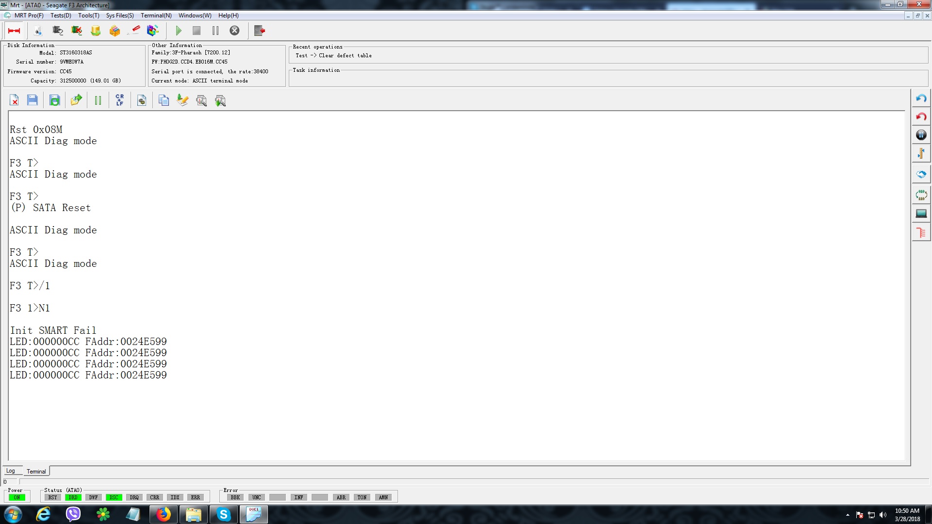

 Post subject: SEAGATE-ST3160318AS-ERROR - LED:000000CC FAddr:0024E599
PostPosted: March 28th, 2018, 1:42
Joined: July 7th, 2012, 1:28
Posts: 92
Location: srilanka
please help to me recovery this hard disk data,
" LED:000000CC FAddr:0024E599 "
how to fix this error ?
***please find attachment screen shot
 Post subject: Re: SEAGATE-ST3160318AS-ERROR - LED:000000CC FAddr:0024E599
PostPosted: March 28th, 2018, 4:41
Posts: 396
Location: slovenija
check this https://forum.hddguru.com/viewtopic.php?f=1&t=17823
PostPosted: March 28th, 2018, 16:06
Posts: 291
Location: espaƱa
Why do you want to erase the smart? :shock:
The disk is recognized correctly (and ready), run DE.......
