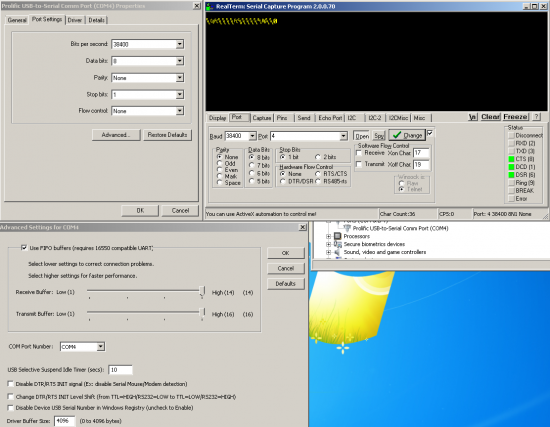

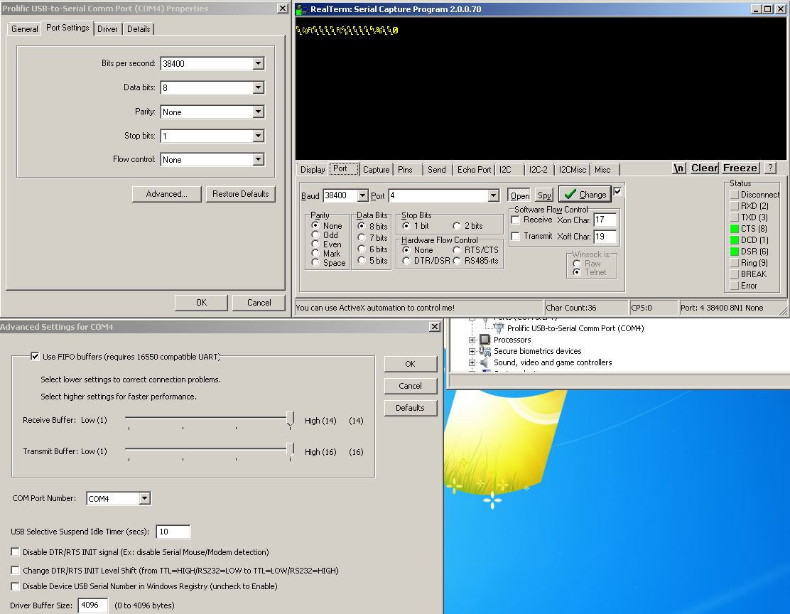

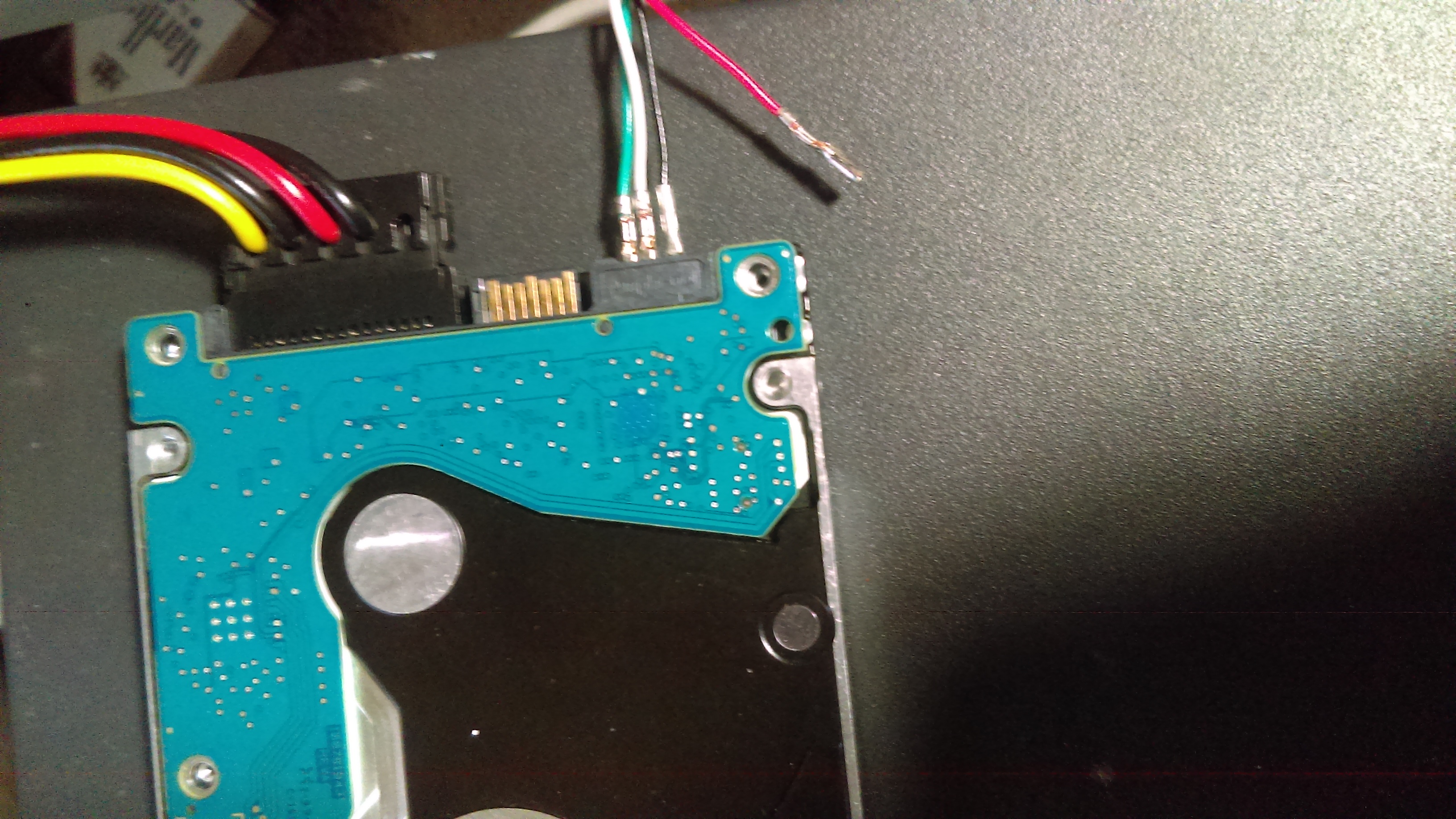

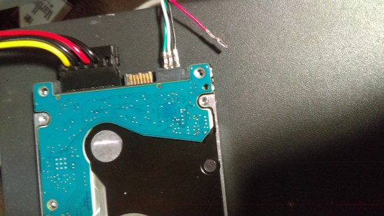

I'm hoping that a kind soul with more expertise than I might throw me an assist. I'm no expert, but believe I should be able to manage resetting SMART on a Seagate ST2000LM007. I picked up a PL2303HX USB-TTL RS232 Arduino off eBay, but am having difficulties with getting terminal T>. Based on my research, the pin config for the diag port should be:
___________________
| Pwr | GND | TX | RX | - |SATA| - |PWR|
So, I've connected my pins accordingly; using 38400 8N1 None with Realterm, and have played around with multiple pin configs. I just can't seem to get to T> no matter what. About the best I'll manage is either a locked session that is unresponsive, or depending on the config it will spit a bunch of garbled data (in ascii- hex will display characters).
Wondering if my usb-ttl is junk, or rather inappropriate for this job.
Prolific USB-TTL pin scheme
- Red: + 5V
- Black: Ground
- Green: RXD
- White: TXD
Hoping someone can steer me towards the right config with the hardware I have, or steer me towards what I need to purchase. I have 2 Seagate drives (ST2000LM003 & ST2000LM007) that I'd like to reset SMART on. I've tried to include the pertinent information in the pics.
Thank you so much!

Well, the first the point is why do you want to reset smart in the hdds ? What are the problem in them that you are trying to solve. The correct procedures depend somewhat on the problem.
Also, your ttl adapter will not work. You need a lower voltage compliant one, so easier to get one based in the CP2104 chip.

That could also mean that you cannot access the smart information due to the locked situation of the drive.
Your first post was long and with pictures attached, and it got through ok. Maybe something different in the way you built your post with the SMART reports ?
Try to use the Code tags and put the SMART information inside them.

If you look further up the thread, you'll see what I was able to produce using Seachest.
 Post subject: Re: ST2000LM007 - Terminal Diag - SMART Reset
PostPosted: April 9th, 2018, 11:17
Posts: 713
Location: Brazil
Please, post the information from Victoria or MHDD with the drive connected to SATA.
Also, try with MHDD to set a password, then run secure erase.
