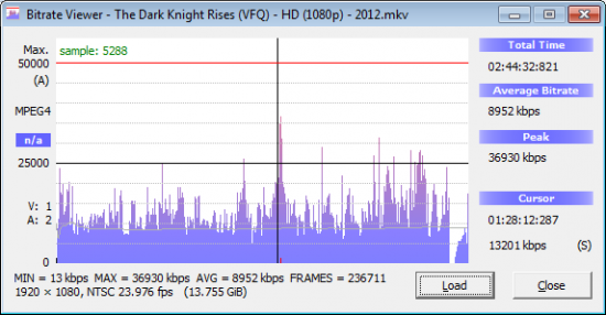

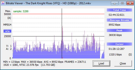

Yes, of course, that's what I meant : it's very unlikely to be an issue, since the video files in playback format are always compressed, and with a bitrate far below the throughput of even the slowest HDDs currently available. Just make sure you don't use enclosures in USB 2.0 : it limits the transfer speed to about 30MB/s, which could cause issues with high bitrate blu-ray copies (and would considerably slow down the file transfer operations anyway) ; even if the average bitrate is below that threshold, videos in H.264 / H.265 (and Xvid but it should be considered obsolete by now) are encoded with a variable bitrate, so complex scenes can require significantly more. You can check that with a tool called Bitrate Viewer if you're curious : I just made a test, with a MKV transfer of the movie The Dark Knight rises, total size 13.7GB, average video bitrate 8952kbps, average global bitrate (according to MediaInfo) 12mbps, but the video bitrate peaks at almost 37mbps (that's without the audio), which is actually 4.6MB per second since the bitrates are measured in bits, not bytes, so that particular file can be read with no hiccup in USB 2.0, but some video files could reach higher values, especially with 4K+ resolutions on the horizon. It shouldn't be a problem for a long time in USB 3.0 or eSATA.
