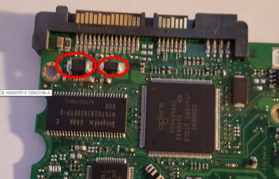

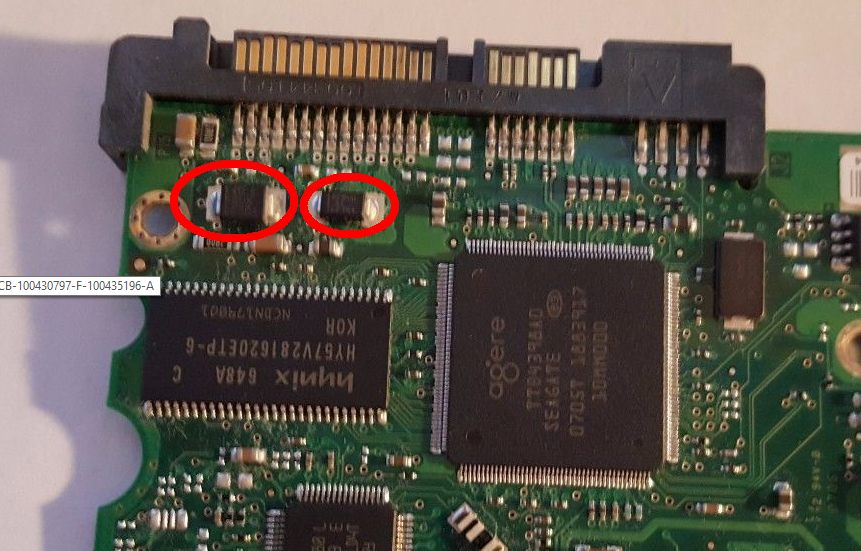

If you have a multimeter check the two TVS diodes where the power supply connects to the drive:
If either one is a dead short circuit measured both directions it's burned.
That's it! diode on the left has no reading.

rogfanther wrote:
No reading, as in open circuit, or it reads the same as when you touch the points of the multimeter probes to each other ?
I'm no multimeter expert. So, I'm probably doing something wrong. In diode mode I get voltage in both directions on the left diode, and no voltage in either direction on the right diode.
 Post subject: Re: Seagate ST3500630AS donor PCB question...
PostPosted: April 12th, 2018, 14:39
Posts: 713
Location: Brazil
That *could* mean, provided you aren´t doing something wrong, that the LEFT diode is bad, and the right one is good.
If you get both removed, or replaced, that shouldn´t be a problem, as long as you use the hdd just to recover the data from it.
PostPosted: April 12th, 2018, 16:46
Posts: 17230
pixelbat wrote:
See my TVS diode FAQ:
It includes multimeter usage instructions.
BTW, check or replace your PSU.
