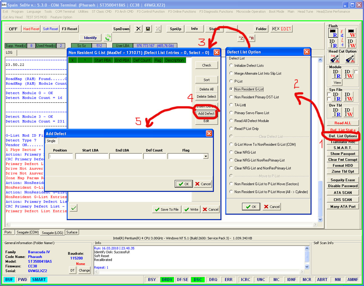

Hi friends, i need help in this case.
HDD Model: ST3500418AS, Family Pharaoh, FW CC38.
I need to recover data. Hdd came undetected in BSY state. When connected to terminal gave “No HOST FIS-ReadyStatusFlags...” error.
Thinking in translator issue i thinked to regen translator, but first went to NRG-list with V40 terminal command and 3-4 entries appeared. And here became my second fatal error (my first big fatal error was to not make a backup of critical Sys Files), i cleared NRG list with Sediv and regened translator with m0,2,2,,,,,22,
After that hdd is ready but became in partial access problem, because after lba 63301568 to the end can not be accessed.
Now i backed up all modules.
My plan is add deleted entries to nrg-list again and then use m0,6,3,,,,,22.
As i don´t know the value of entries i deleted, for determinig the entries values i used Sediv or Victoria logical scan and see that lba 63301568 is the first unc value. After that lba to the last lba of hdd gives unc or timeout error.

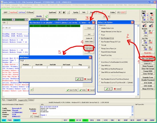

Sediv Allows add entries to nrg-list by the following way:
But here I have two doubts:
1- Lba value is in decimal or hexadecimal?
2- What flag i need to select (0, LNK, PFMT, DSP, PFP, b4, RGD, b6, b7, All)?
I probed to add lba 63301568 to nrg-list using decimal value and flag 0, then used m0,6,3,,,,,22, but now logical scan stucks about lba 61 000 000.
What's next?
thanks in advanced,
best regards,
Oleg

Only information I found was more a "hands-on". But as you did a lot of things through terminal, and I understand you will not be sending this drive to someone in another country, maybe this links could be of some help :
http://www.hddoracle.com/viewtopic.php? ... ardo#p7351
https://datarecoveryindex.wordpress.com ... nt-g-list/
http://www.hddoracle.com/viewtopic.php? ... ardo#p2145
http://www.hddoracle.com/viewtopic.php? ... ardo#p1471
http://www.hddoracle.com/viewtopic.php? ... nardo#p410

Problem Solved. More info at http://www.hddoracle.com/viewtopic.php? ... 060#p17060
