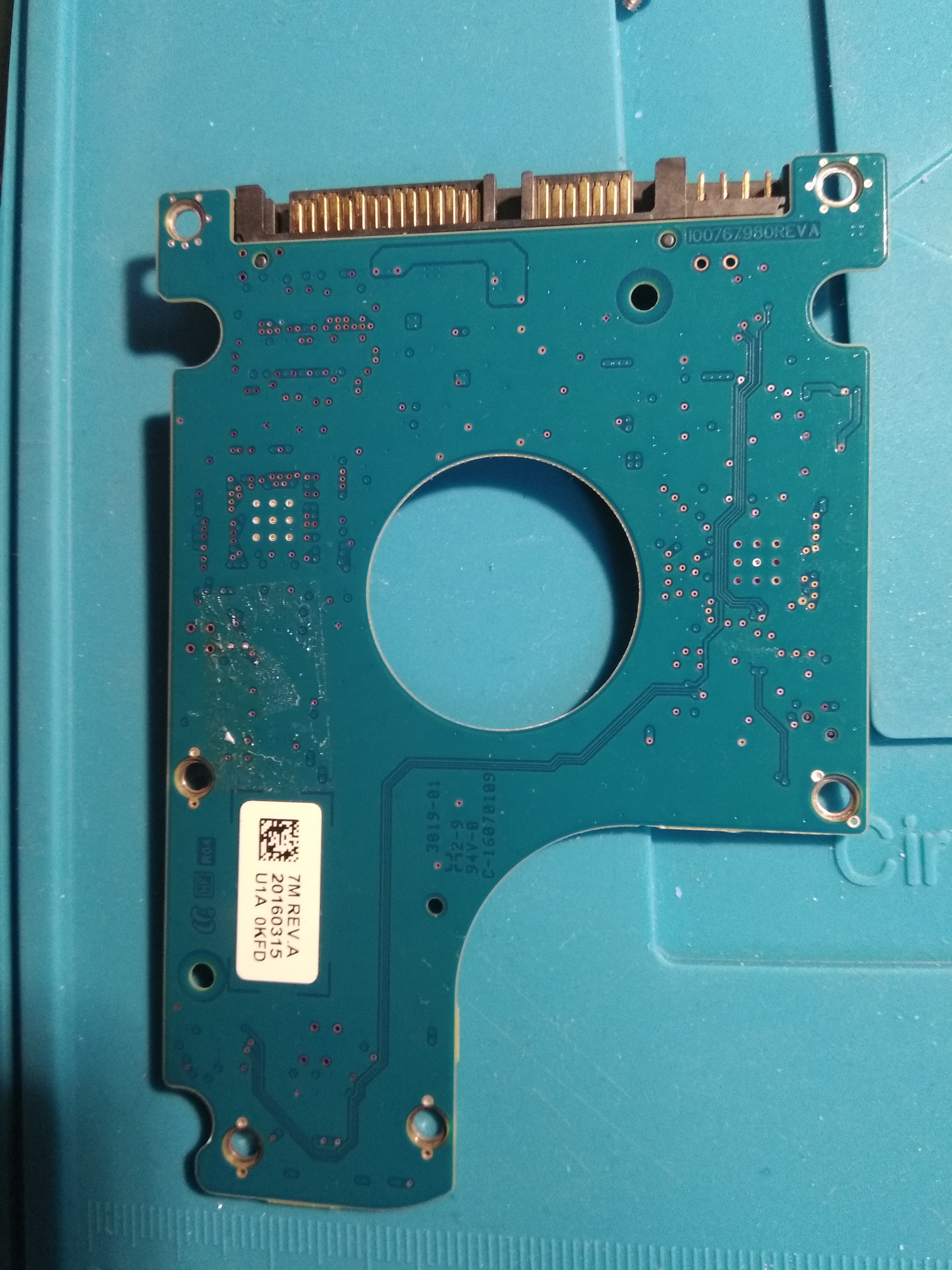

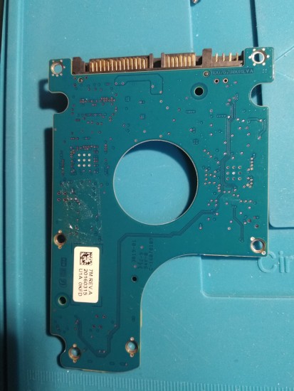

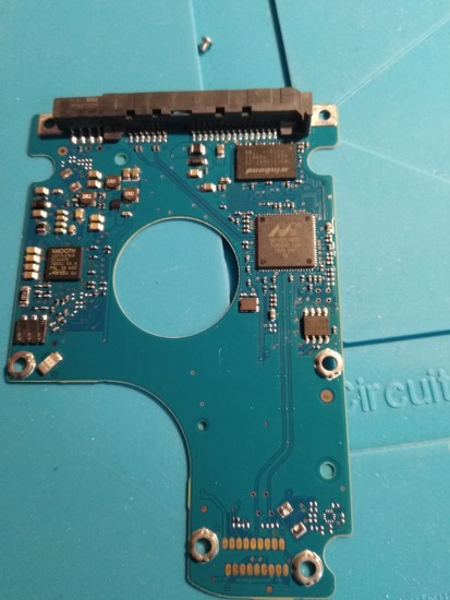

here is the Patient pcb

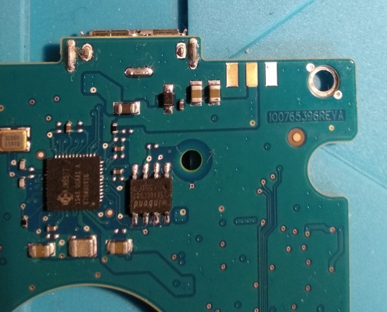

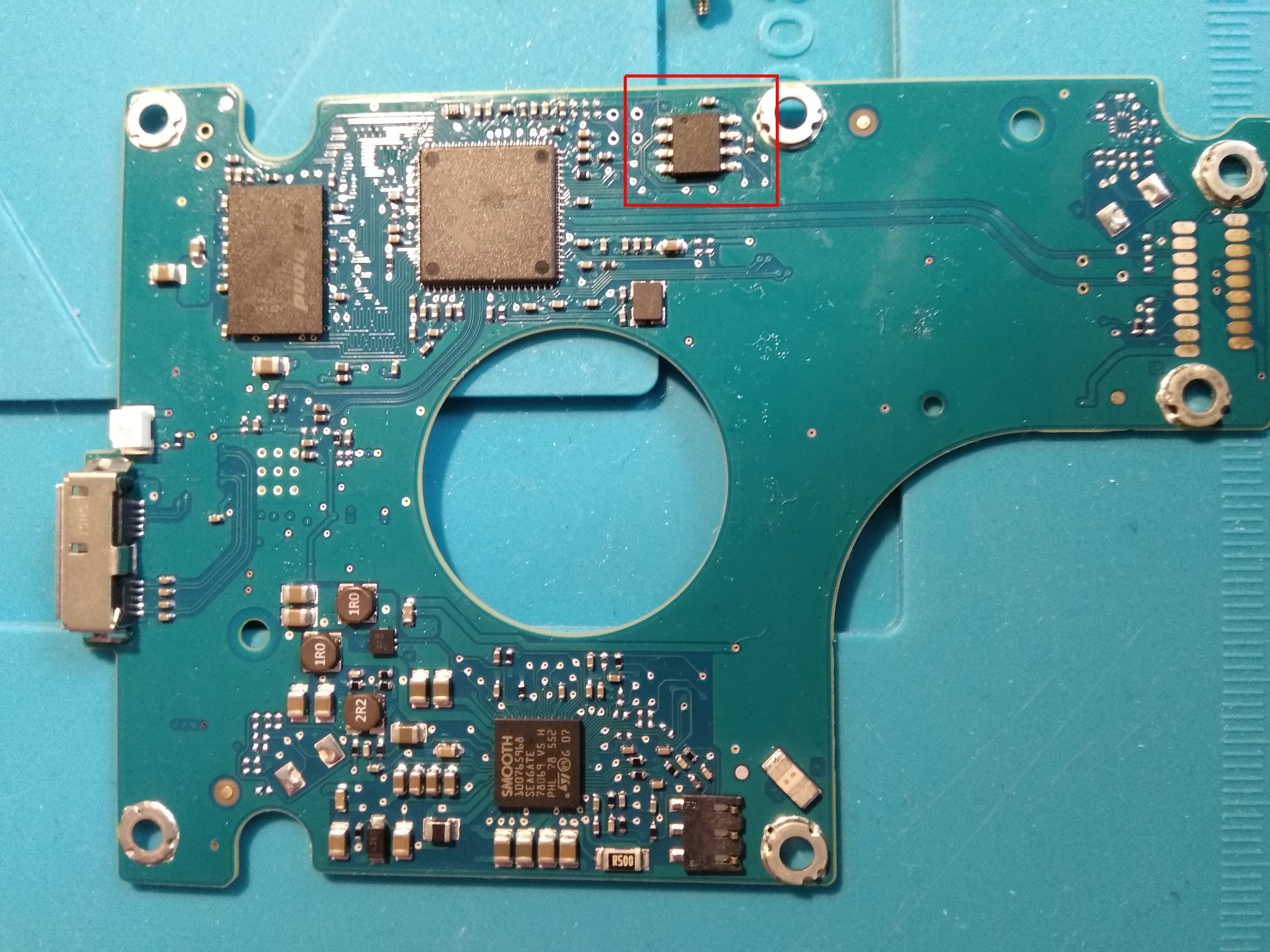

front side

How did you try to fix the original board ?
Can you post pictures of the new donor board you are using ?
Also, in the original board, you can try to clean the oxidation in the hda contacts. Maybe it changes nothing, but just in case.

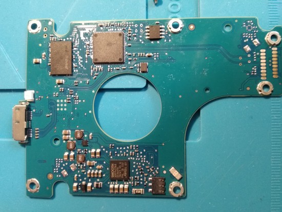

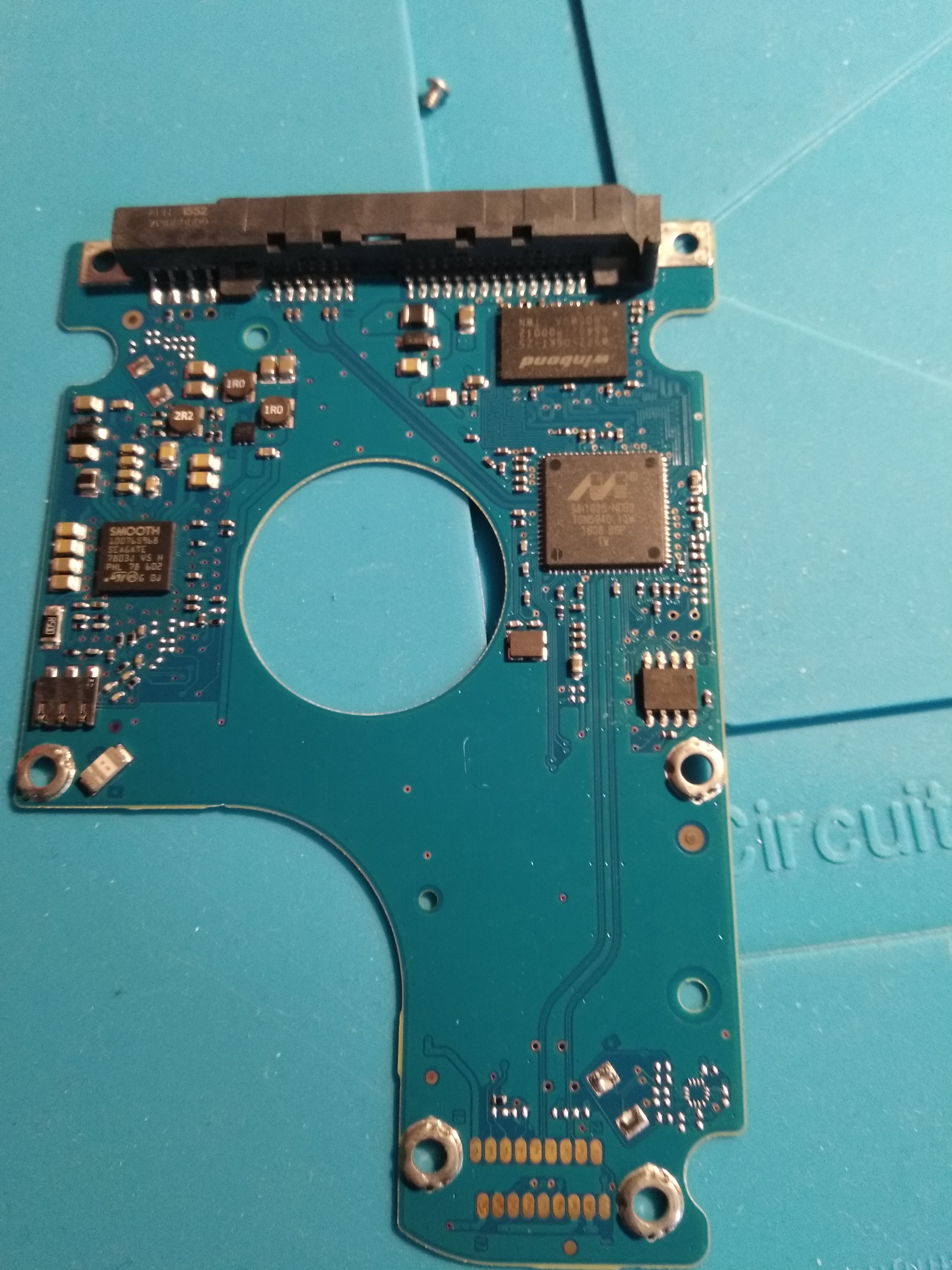

thanks for asking, I didn't do much to the original pcb just tried to reflow the connectors close to the usb and give it a clean up.

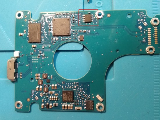

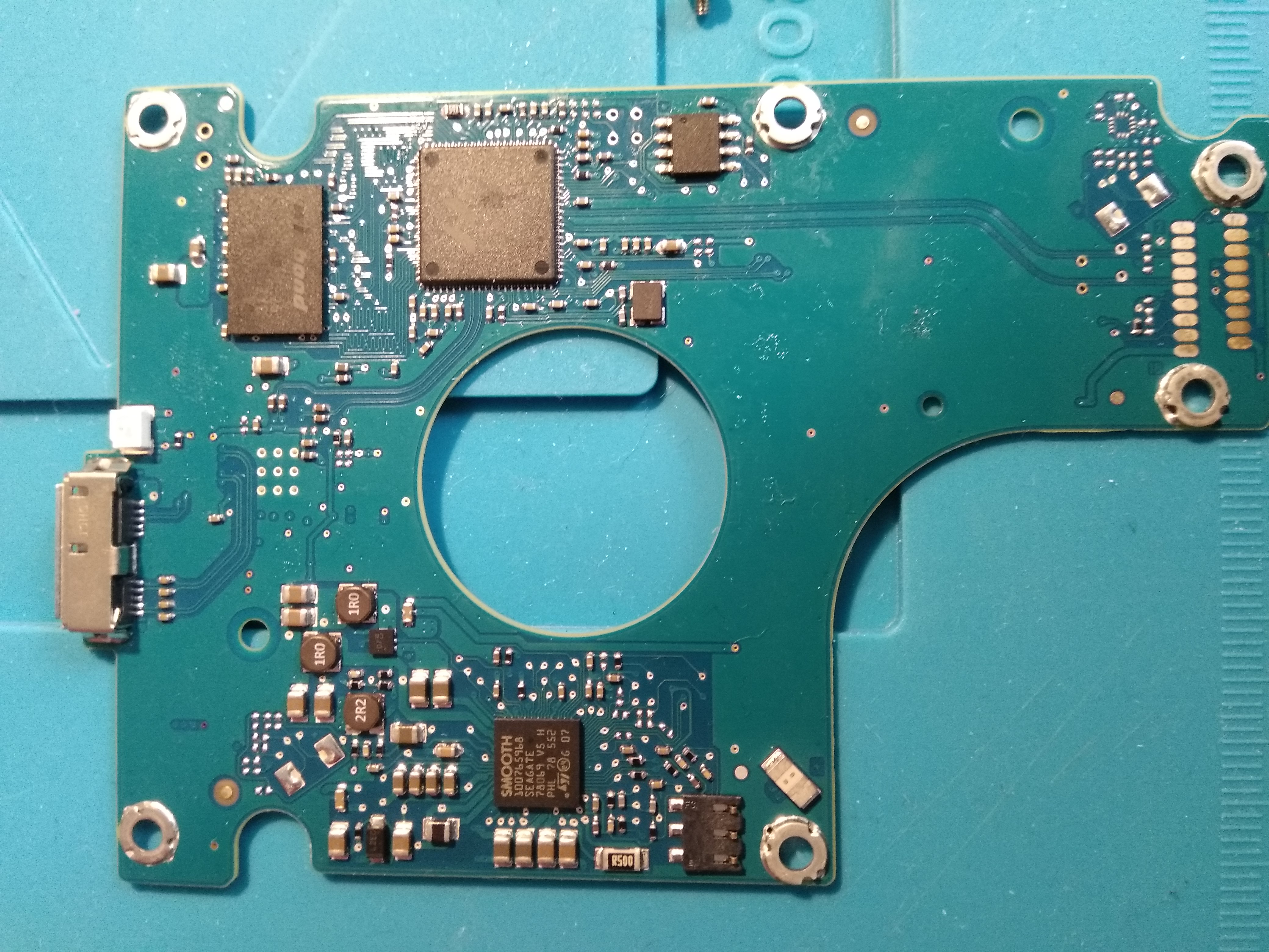

Here is one of the donors I used

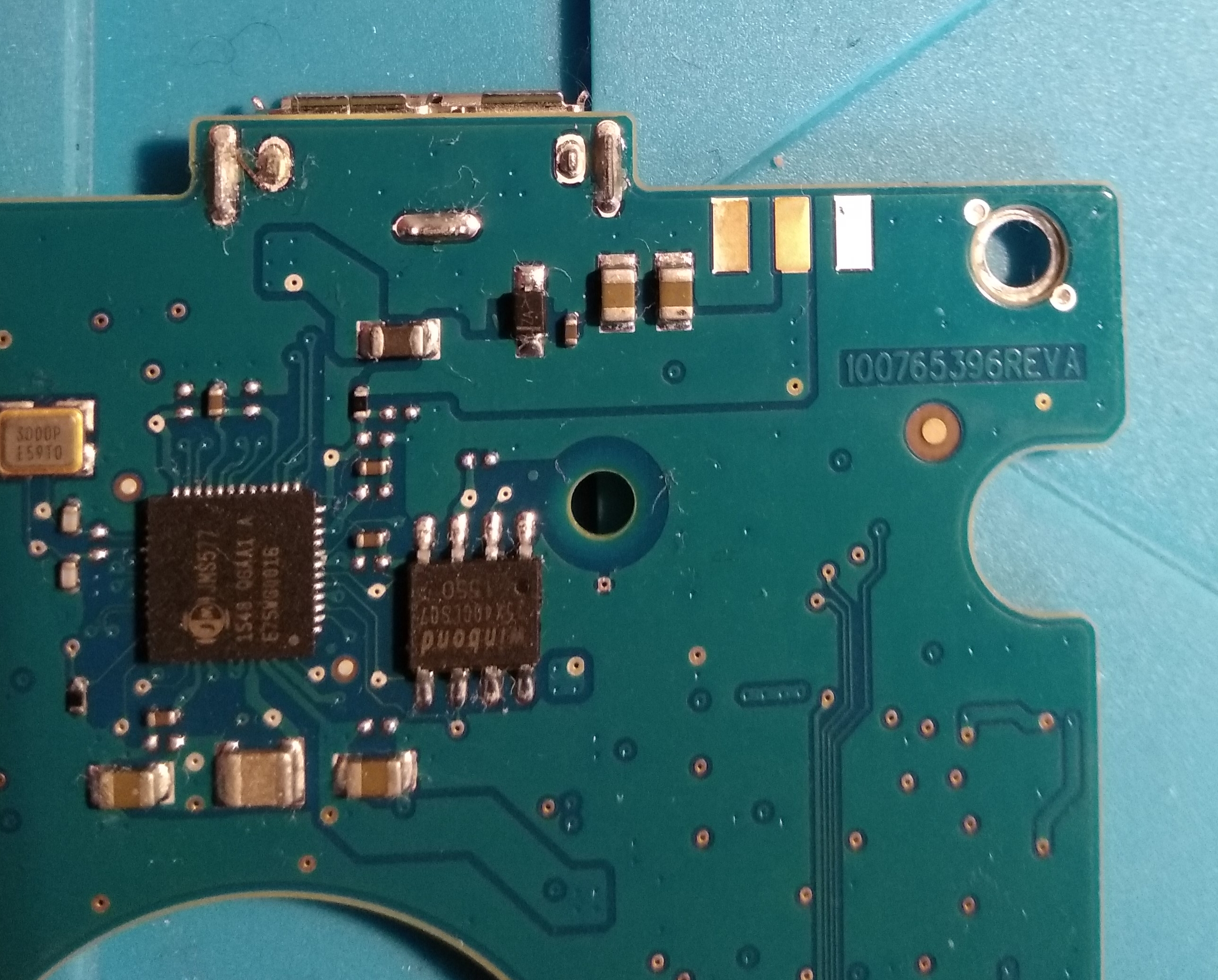

Maybe I´m wrong, but it seems from the pictures that you transferred the flash rom chip that contains the usb bridge firmware, not the the main controller one.
In the picture you called Patient pcb, it would be the chip near the second screw hole in the top side.

I didn't have many of those drive but I thought the one that contains the bridge fw was on the outer part of the pcb, here is the rom that I swaped, please tell me is the rom otherwise would be really embarassing form me :oops:
Yes, that is the right chip. From your picture, it looked like you had soldered the bridge firmware chip, that´s why I commented on it.

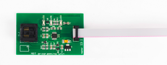

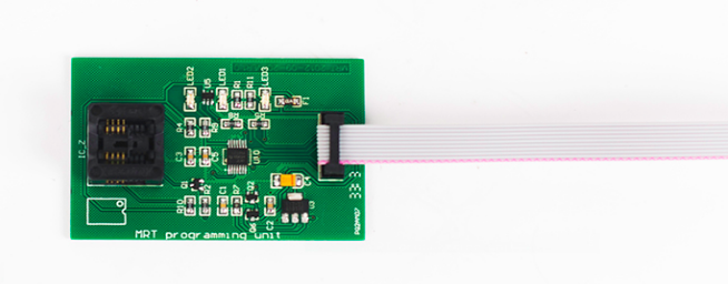

I did both, rom swap to the patient pcb and as it didn't work I removed it and used the MRT rom programmer to read the chip hoping anyone could help out here.
If you have used the new MRT you should know the flash reader/programmer reads directily from the rom
I attach a pic of the reader for you in case you haven't seen it yet.
As I am a bit new to MRT I thought the programmer would pick the size automatically but you actually need to chose it manually that's why I posted the 512k file in first place. :oops:
thanks
