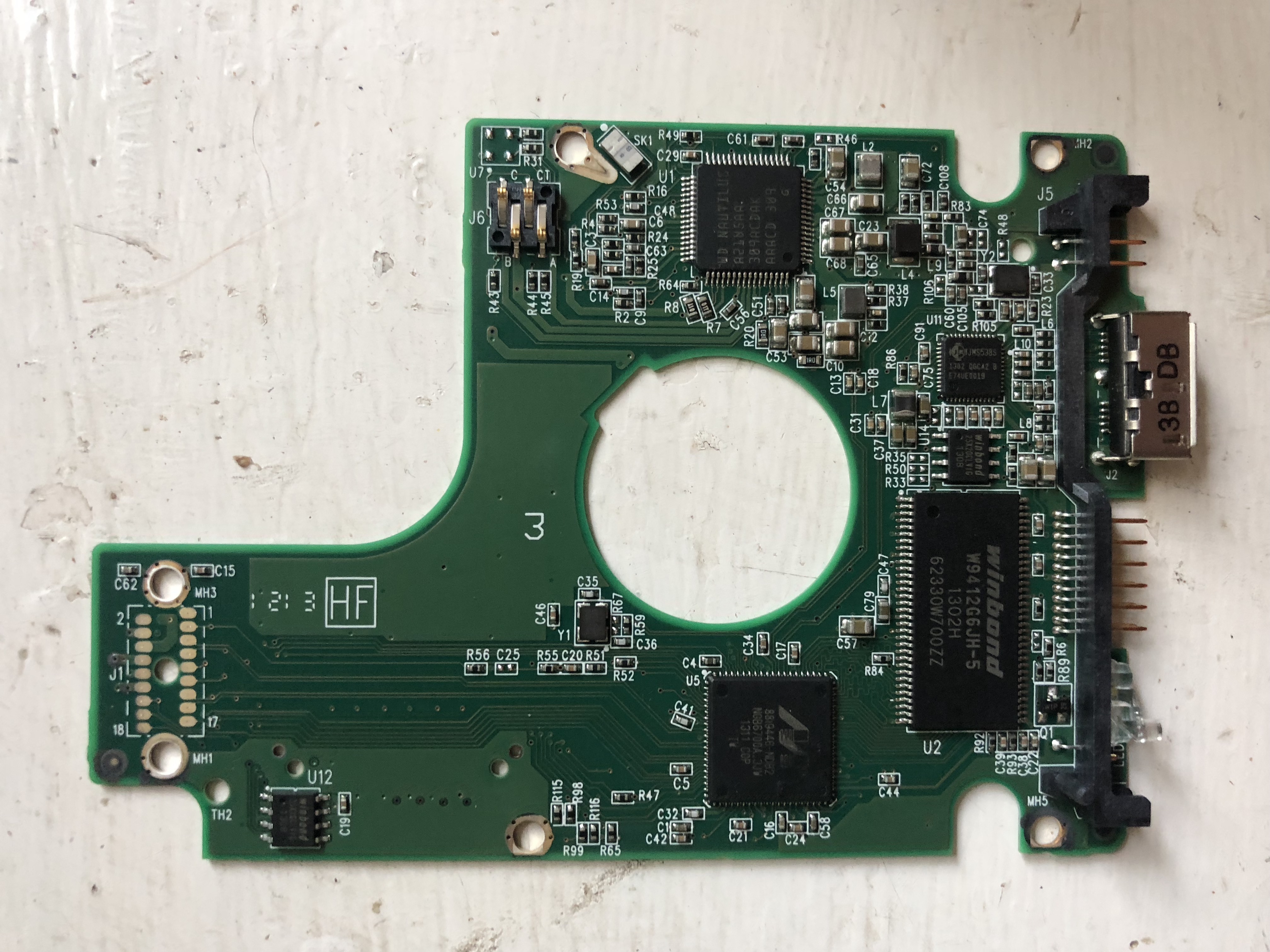

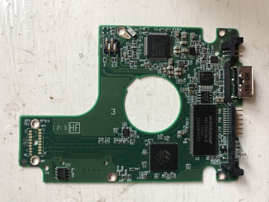

Buy a replacement PCB and transfer the chip at location U12 (if it exists) from the old PCB to the new PCB. Some PCB suppliers (eg hdd-parts.com) will do this for no additional cost.
However, before you do this, show us photos of both sides of the PCB.

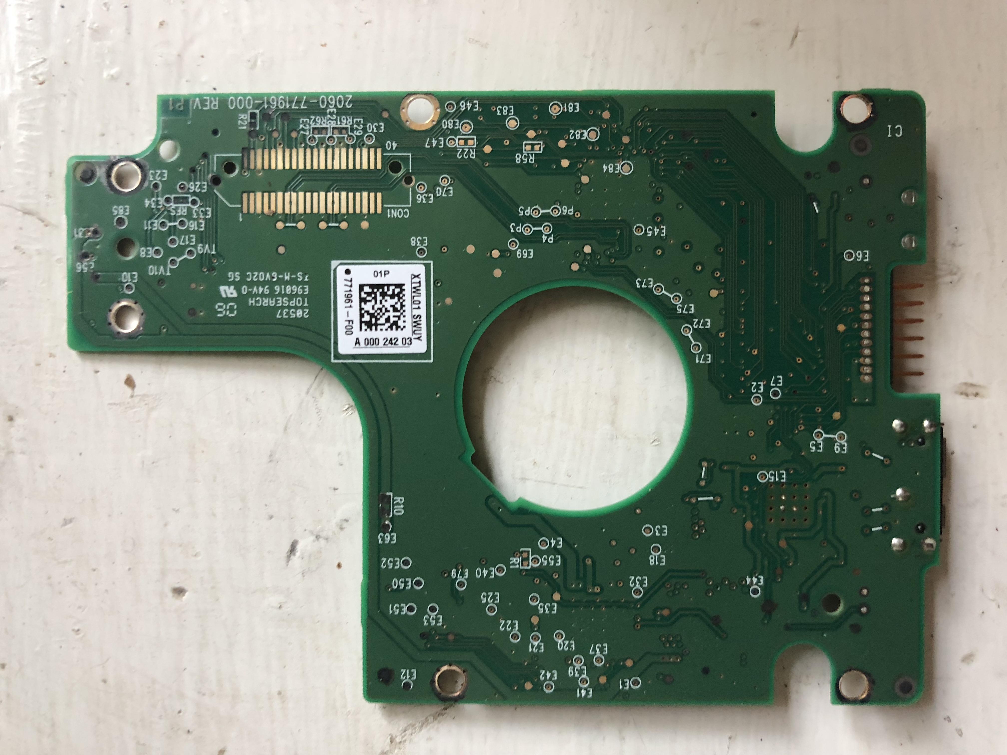

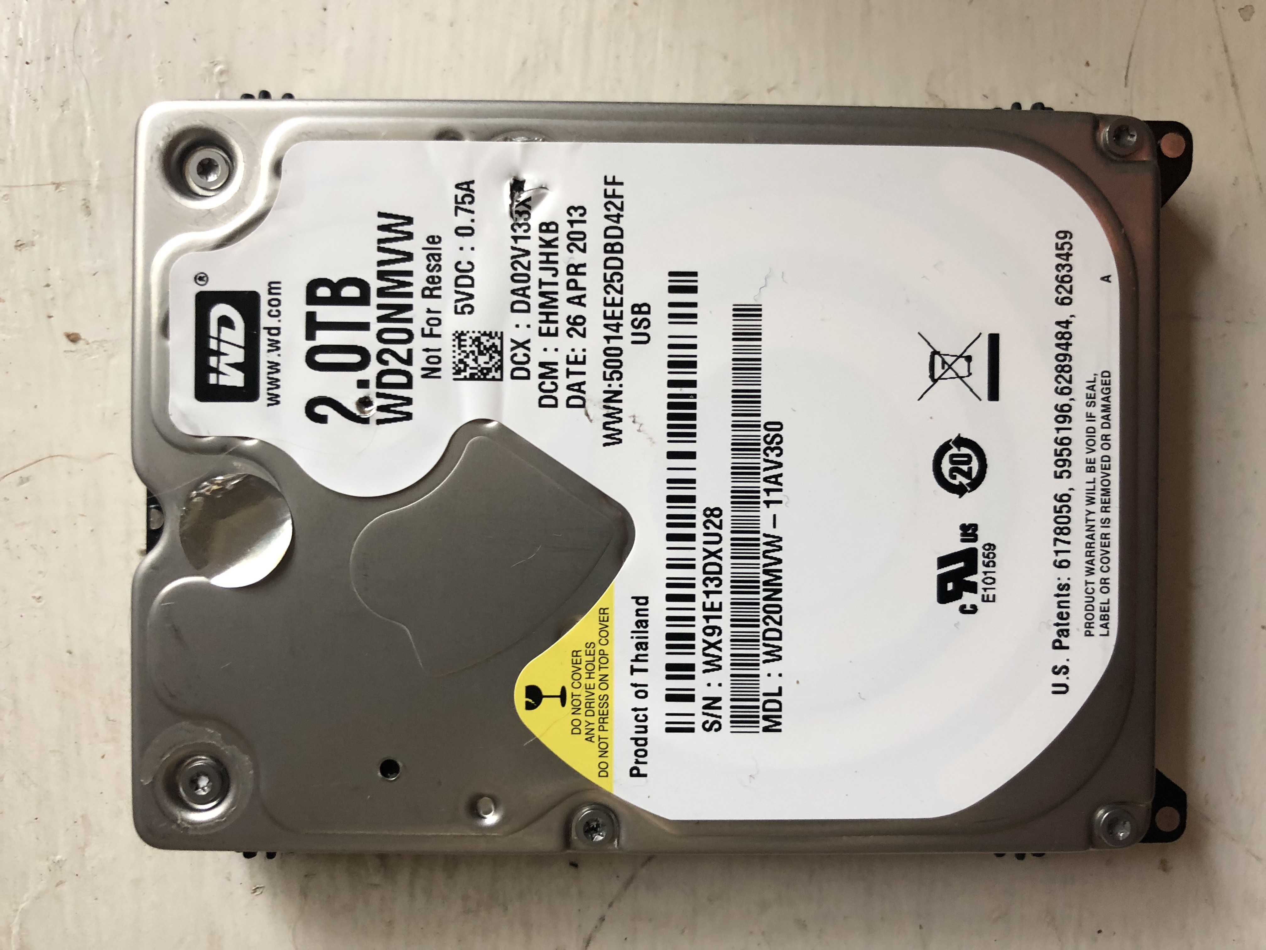

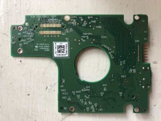

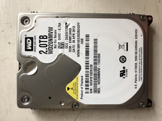

 Post subject: Re: WD My Passport 2TB control board failure
PostPosted: April 25th, 2018, 21:52
Joined: April 25th, 2018, 12:10
Posts: 10
Location: California
here are the parts.
If anyone is willing to provide the link to PCB I should buy I'd be grateful
PostPosted: April 25th, 2018, 22:39
Posts: 17232
Your PCB p/n is "2060-771961-000 REV P1".

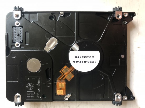

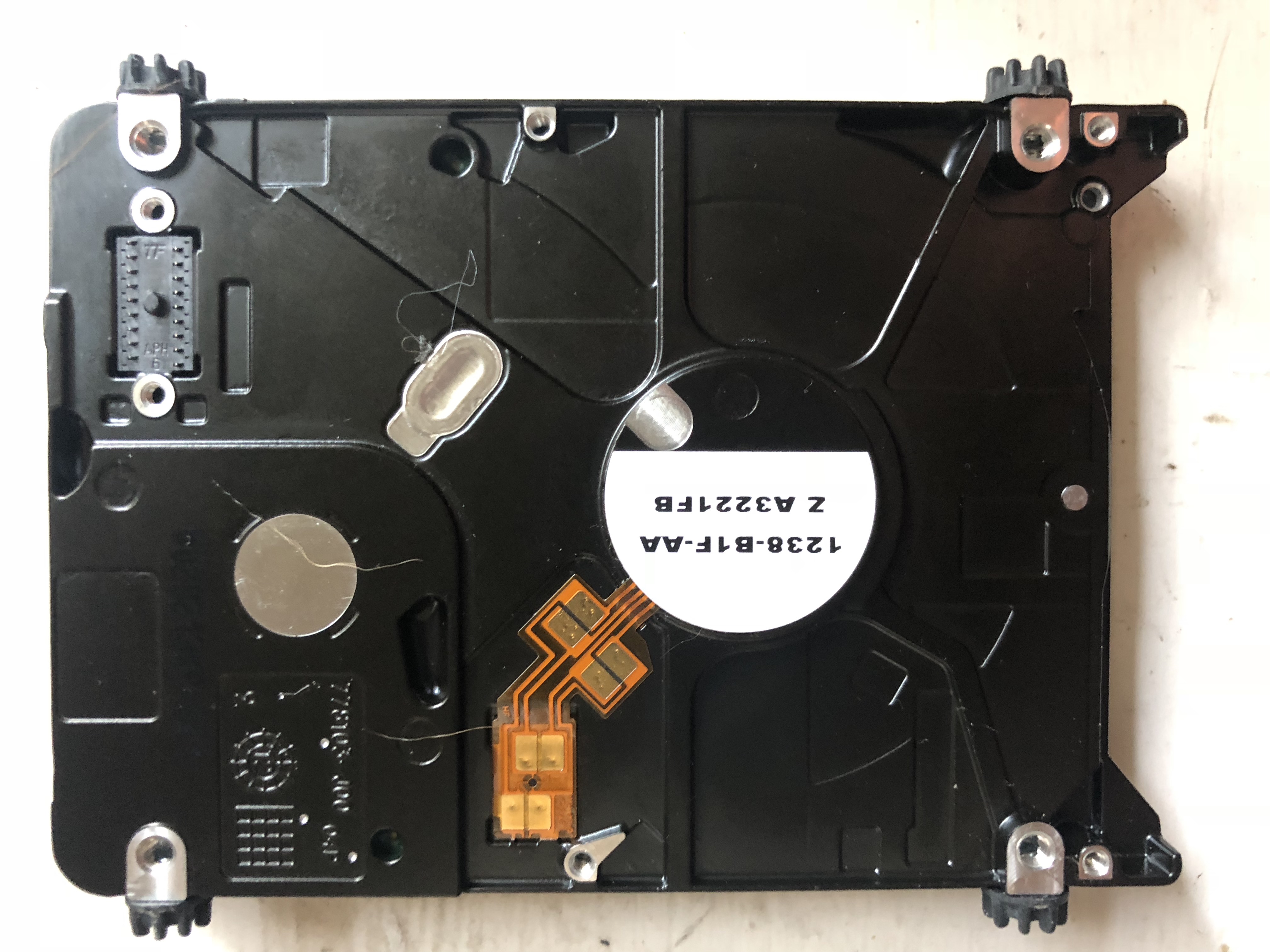

PostPosted: April 27th, 2018, 3:37
Posts: 17232

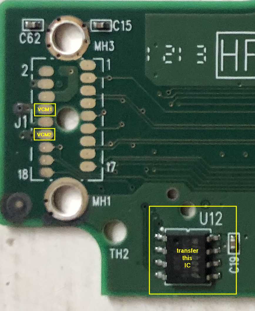

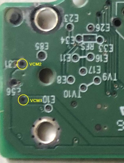

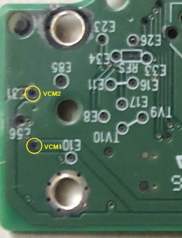

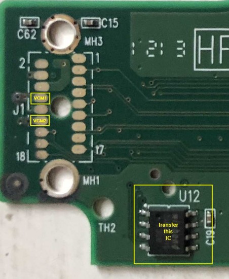

I'm assuming that the heads are parked on the ramp in their normal position and not on the platters.
To prevent the heads from moving off the ramp when the drive spins up, I would place some insulating tape over the VCM1 and VCM2 pads. These pads connect the PCB's motor controller IC to the voice coil inside the HDA. After the PCB has been screwed down, measure the resistance between VCM1 and VCM2 to ensure that it is open circuit.
This used to be my standard practice 30 years ago when servicing a HDD after a head crash. Of course today's drives are completely different animals, but ISTM that "purging" contaminants in this way is still a good idea. Hopefully any dust will be blown off the platters and into the filter. It's your risk, though.
