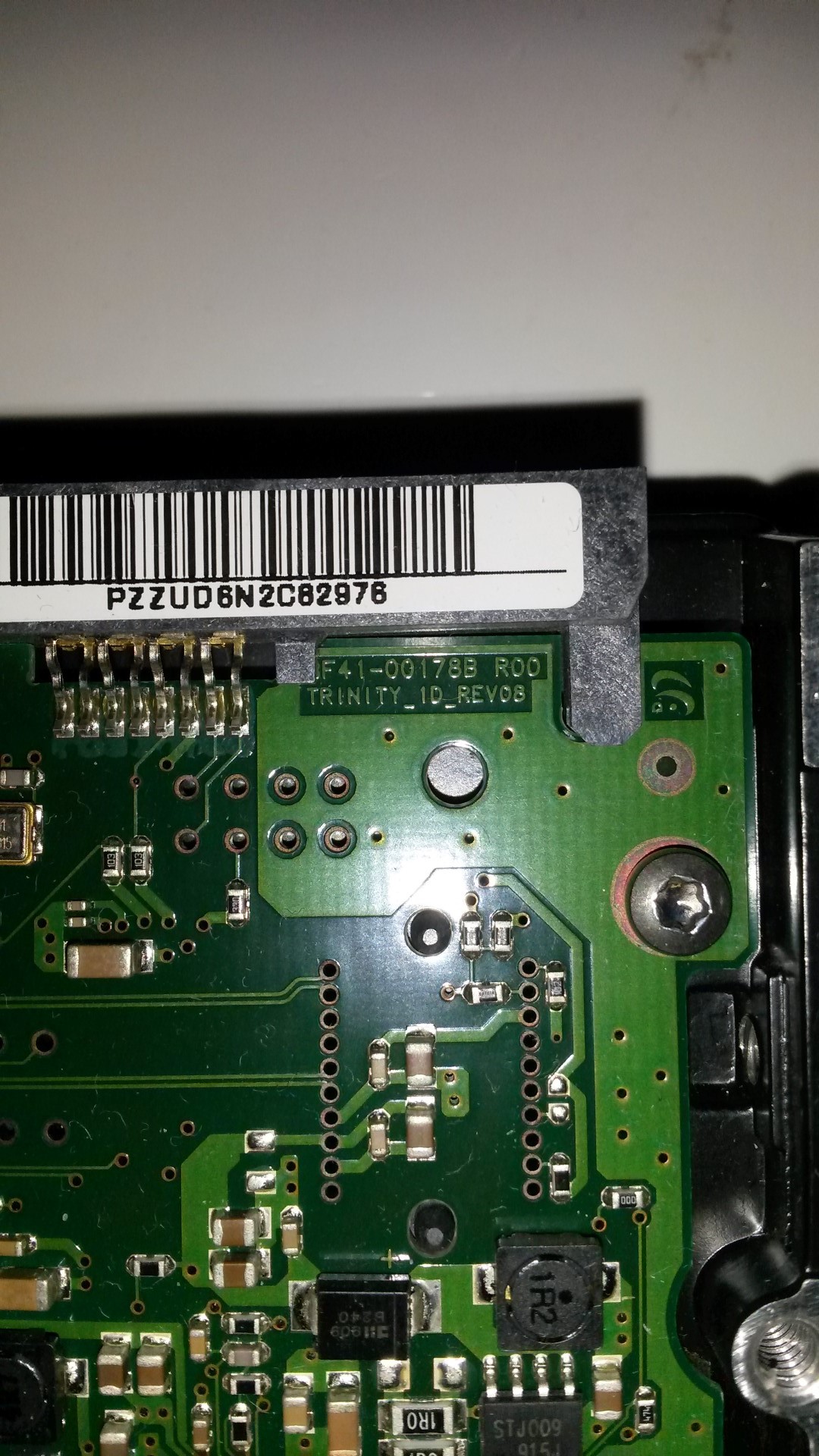

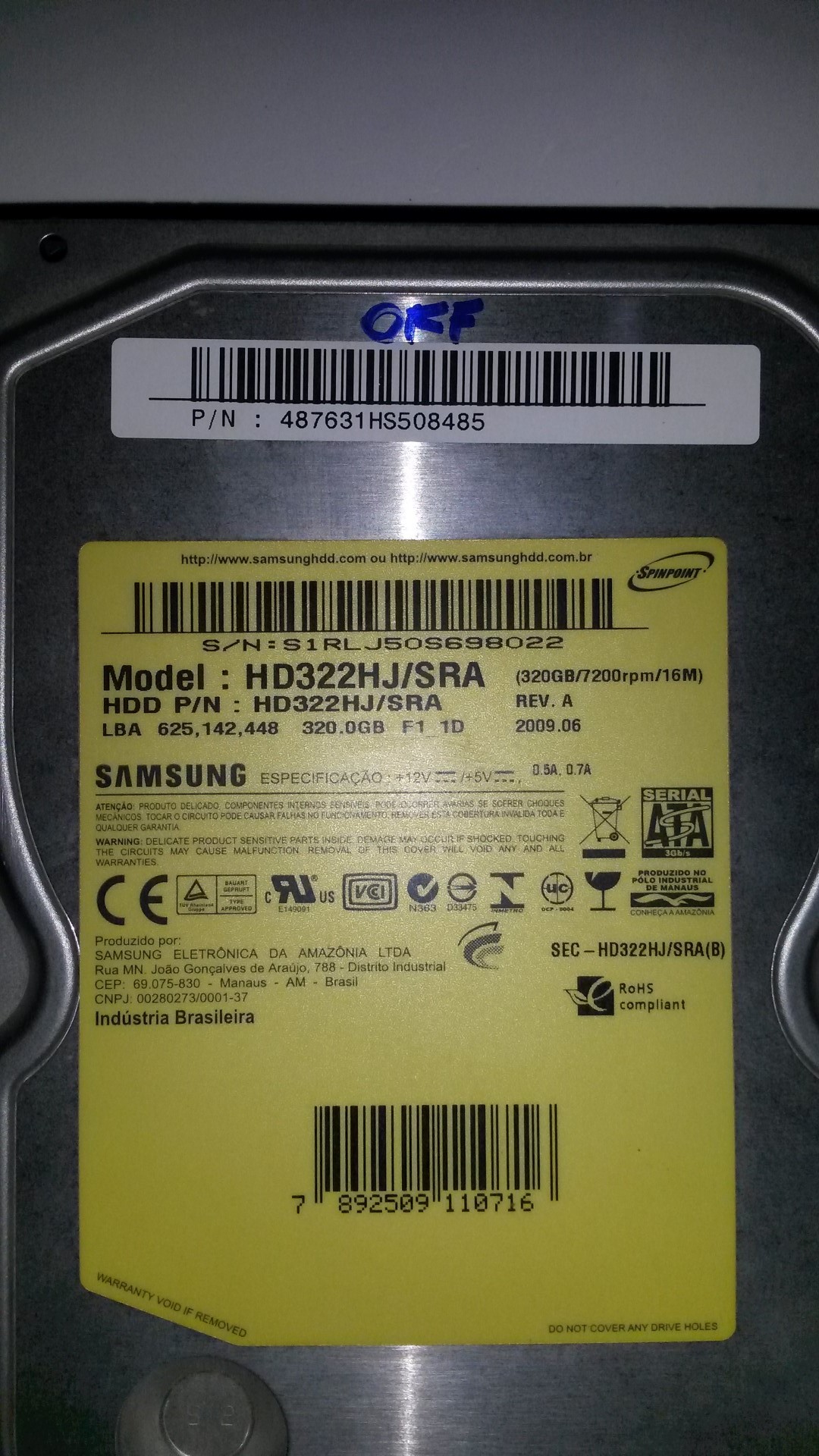

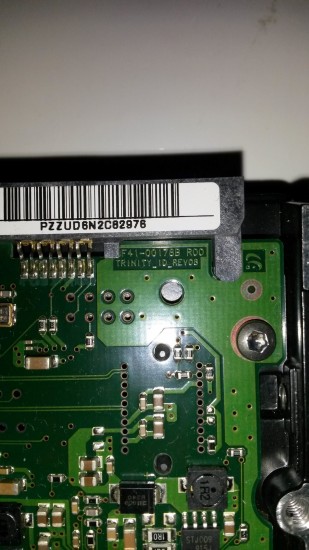

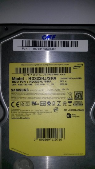

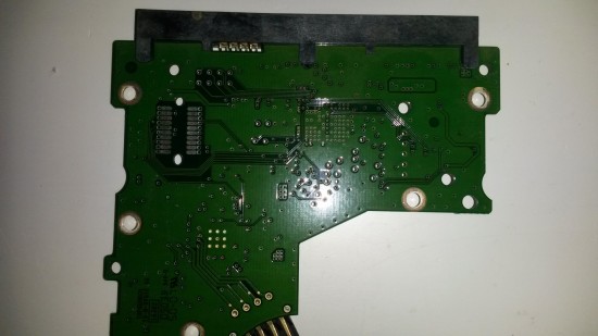

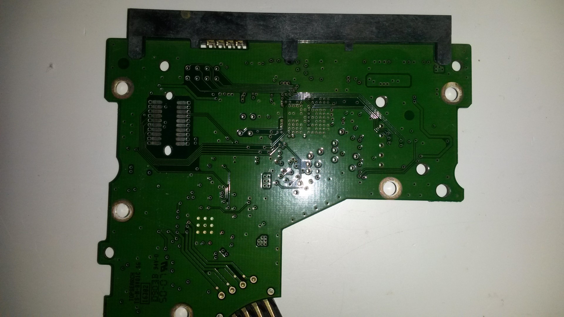

Need help with this.
Disk doesn´t spin up. Can´t hear anything.
Board is BF41-00178B.
Already searched for boards , but none that I have working is the same model. Does anyone knows if some other model would be compatible ?
Also, does it point more for sticktion / motor problems, or defects on the motor controller ? As this is the only board I have, I´m somewhat cautious about replacing the motor controller in it ( but would do, it that is necessary ) .
So, the hard choice : open the disk to see if there is stiction, or change the controller ?
As always, customer ( friend of a friend, actually ) says it "just stopped working".
Thanks.

Problem is being to find another pcb.
I found only one, that had already been canibalized for its sata connector. Will replace it and test to see if the board is still working ( at least a terminal log ) .
Other boards have been always "almost that" . A couple with all the components the same, just the motor connector is different ( and being considered for some "experiments" ) .
ROM in this case would be inside the Marvell chip. But even before rewriting old rom to the new board, the motor should spin, right ?
Unfortunately, sending the drive away won´t be allowed. One would thing people without backups would be more reasonable, no ?

Measure the resistances between the motor terminals.
Measure the voltage across the spindle motor current sense resistors during the spin-up attempts. This will tell you whether the motor controller is trying to spin the motor.

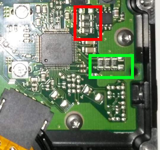

Resistance about 2.7-3.x ohms between them, either with board installed or not. Also the same reading in another disk ( that works ) .
These guys ? The red or the green ones ( or both ) ?
 Post subject: Re: HD322HJ/SRA doesn´t spin up
PostPosted: May 1st, 2018, 16:17
Posts: 17232
Newer designs don't have spindle current sense resistors (the sensing is done inside the IC), but if yours is one of those that does, then I would bet that the green resistors would be for the spindle motor and red for voice coil. Usually one end of the spindle resistor array would be grounded whereas one end of the VCM resistor array would connect to the HDA pins.
Better photo ...

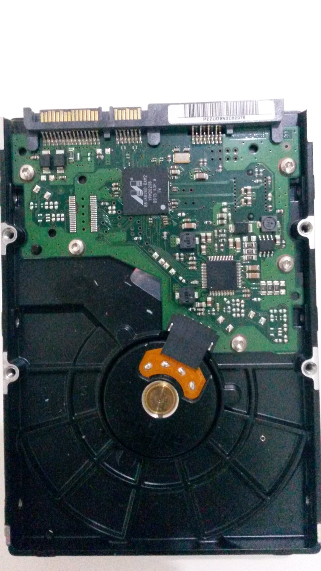

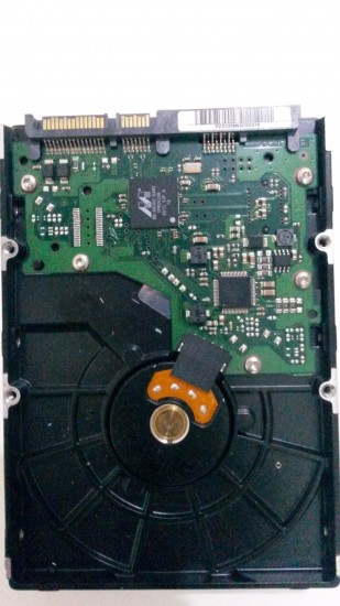

I should have put this here before, may be of some help .
Sadly not high quality, rainy day here today.

One side of them goes to ground through that via. The other goes to a pin in the motor controller, and I suppose through a via in the underside to the motor.
Referencing to that screw near them, the green block measures 0V . The red ( upper ) block measures around 5V. Didn´t take much measurements around it because I´m without the fine tip points for the multimeter .
PostPosted: May 1st, 2018, 17:12
Posts: 17232
ISTM that the motor controller is faulty.
You might like to measure the voltages at each of the motor terminals. Look for pulses.
