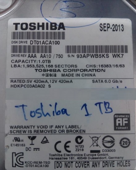

Hi everyone,
Anyone have firmware for TOSHIBA-DT01ACA100, MS2NB750 ?
This HDD original ROM already replace one of technical person.
PLEASE FIND ATTACHMENT,

Without original ROM, it’s pretty much game over.

I could help if original ROM lost. But original rom should be recalculated and rebuilded. Just foreign ROM will not help.

But it's still not a simple job i wouldn’t think due to unique “NVRAM” data. I must admit I have never come across a lost ROM on one of these so haven’t had the need to figure out how to make a new ROM

As a matter of fact when i did post i was going to sugest for the OP to contact you - @drHDD - as i saw another therads here at the forum where you were able to rebuild missing ROM/NVRam on HGST and retrieve the data.

i can help you with such problem... just did a CLA for another forum member 2 months ago. (it was in a pretty bad condition though, platters removed, dirty, fingerprints too, as i expected. Missing rom problem rarely comes alone.)
