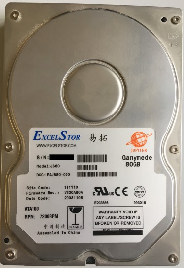

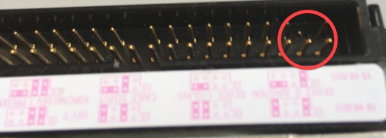

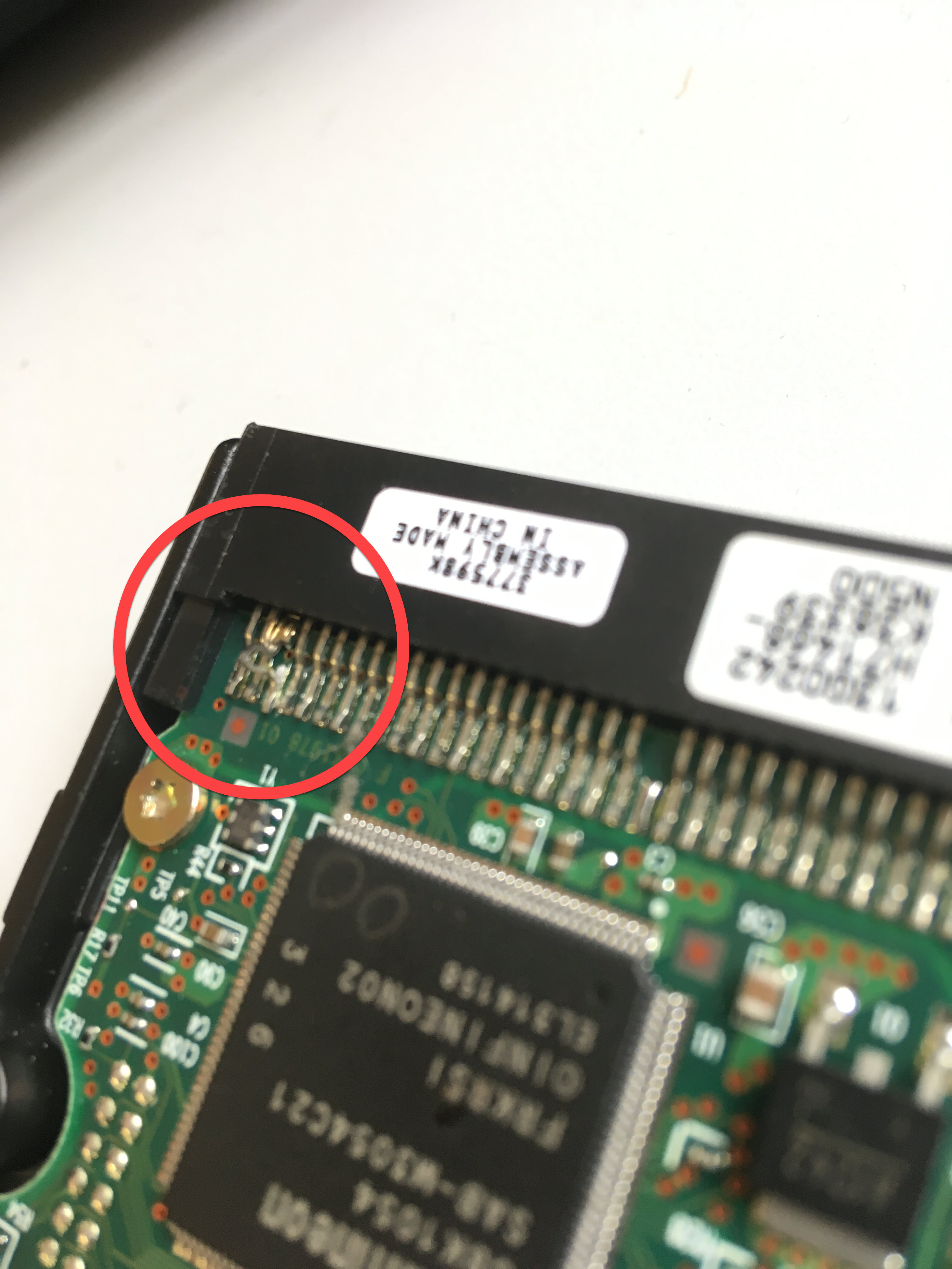

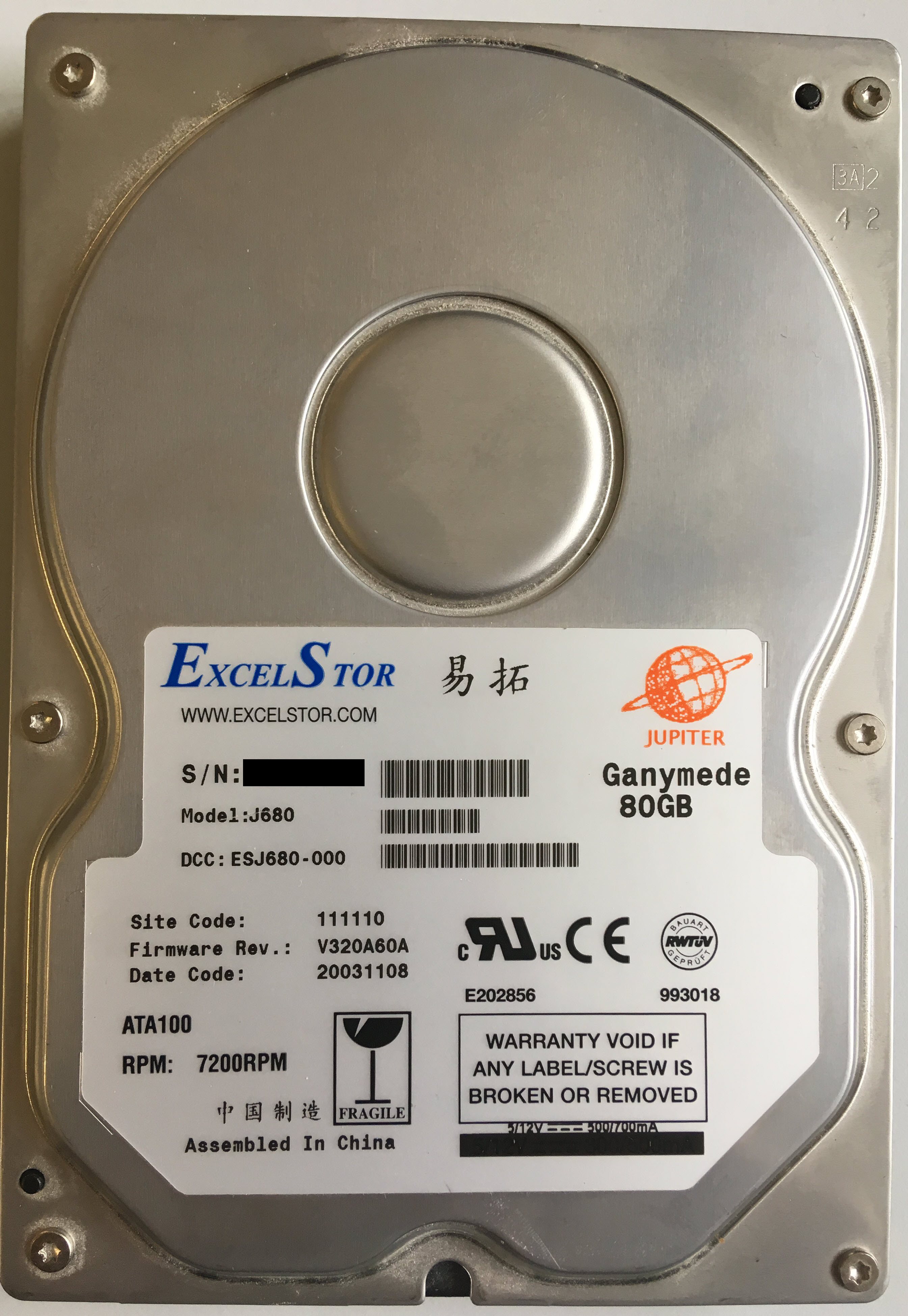

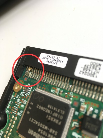

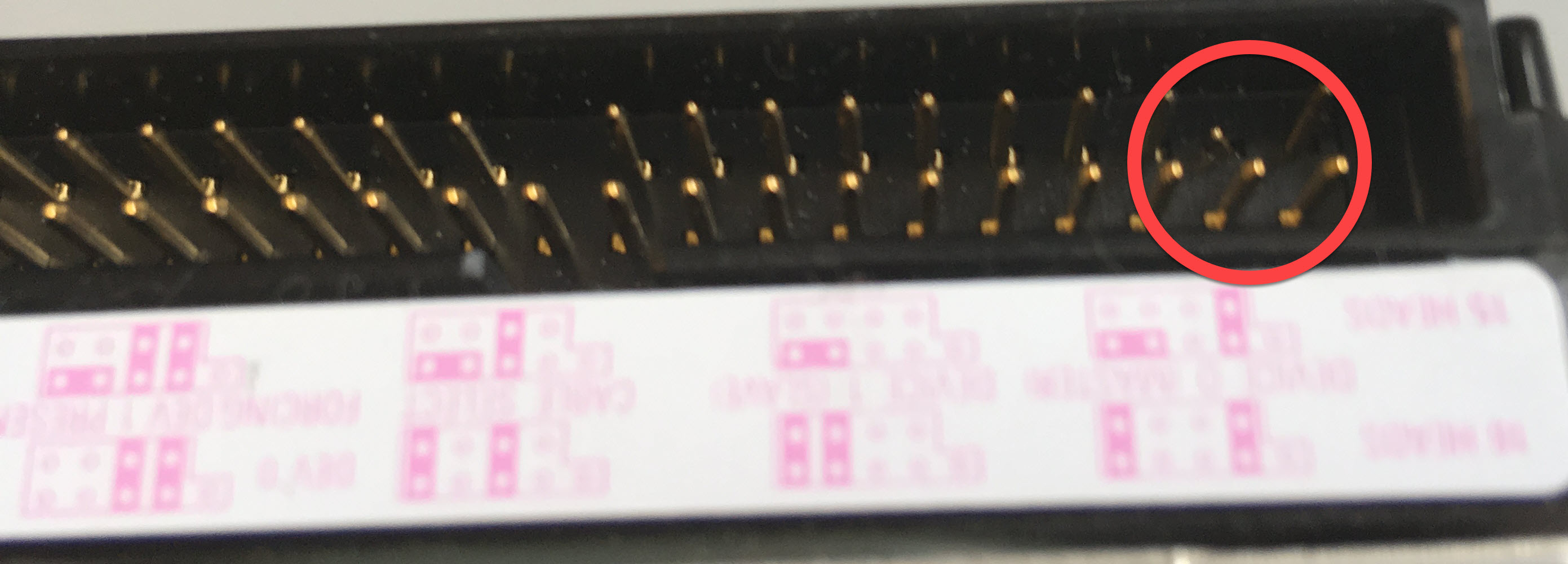

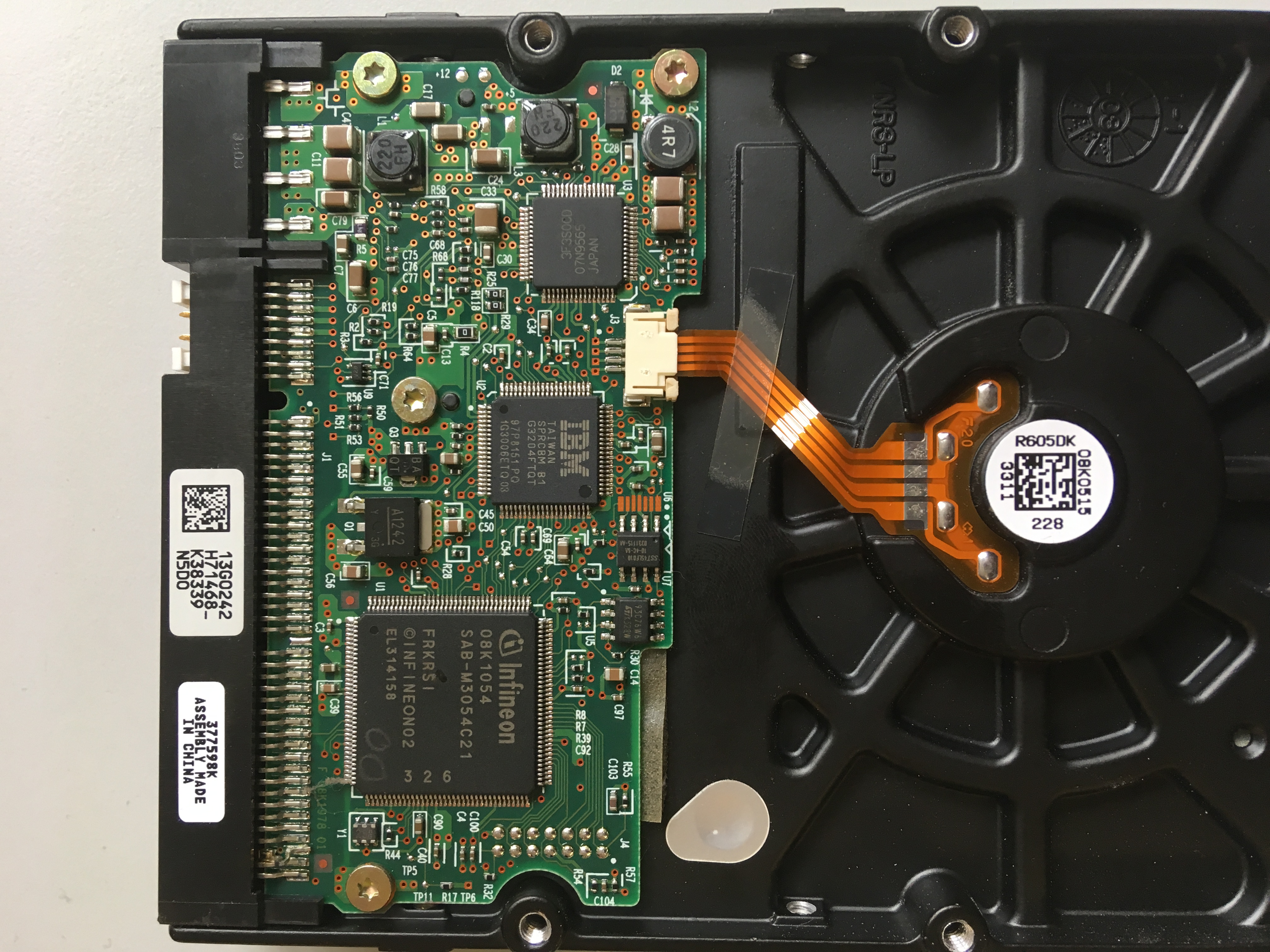

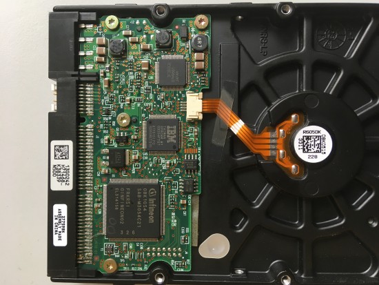

Hello everybody,
I have here a ExcelStor J680 which where the PCB is broken (IDE).
I already ordered a new PCB as donor.
My question is: What do I have to replace/switch so the new PCB works with the HDD?
thanks in advance

Others can answer if some pcb adaptation is necessary, but IMHO it would be easier/cheaper to just fix the connector.
 Post subject: Re: ExcelStor J680 PCB broken
PostPosted: May 4th, 2018, 15:23
Posts: 17232
It's a Hitachi, possibly HDS722580VLAT20.
    U7 = ROM
    U5 = NVRAM
PostPosted: May 7th, 2018, 5:34
Joined: April 4th, 2008, 1:46
Posts: 161
Location: Michigan, USA
That's exactly what this series is. IIRC they were made on retired or licensed tooling. Other Excelstor drives are IC35L040AVVA07 or IC35L080AVVA07 drives.
