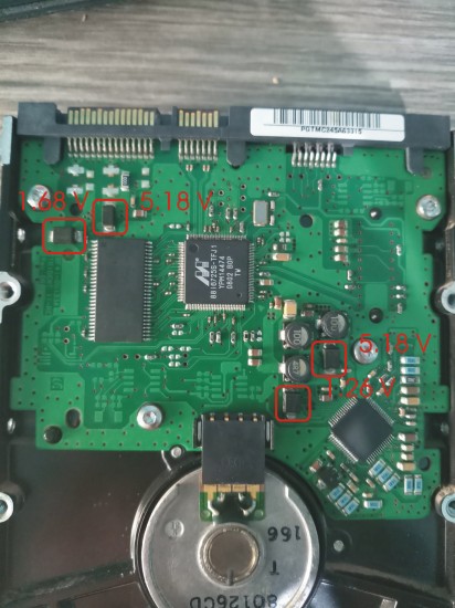

Hello there,

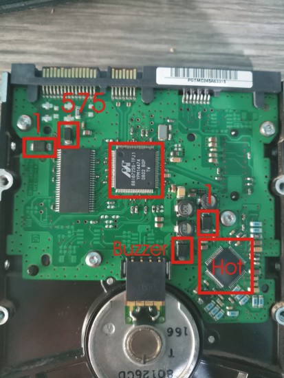

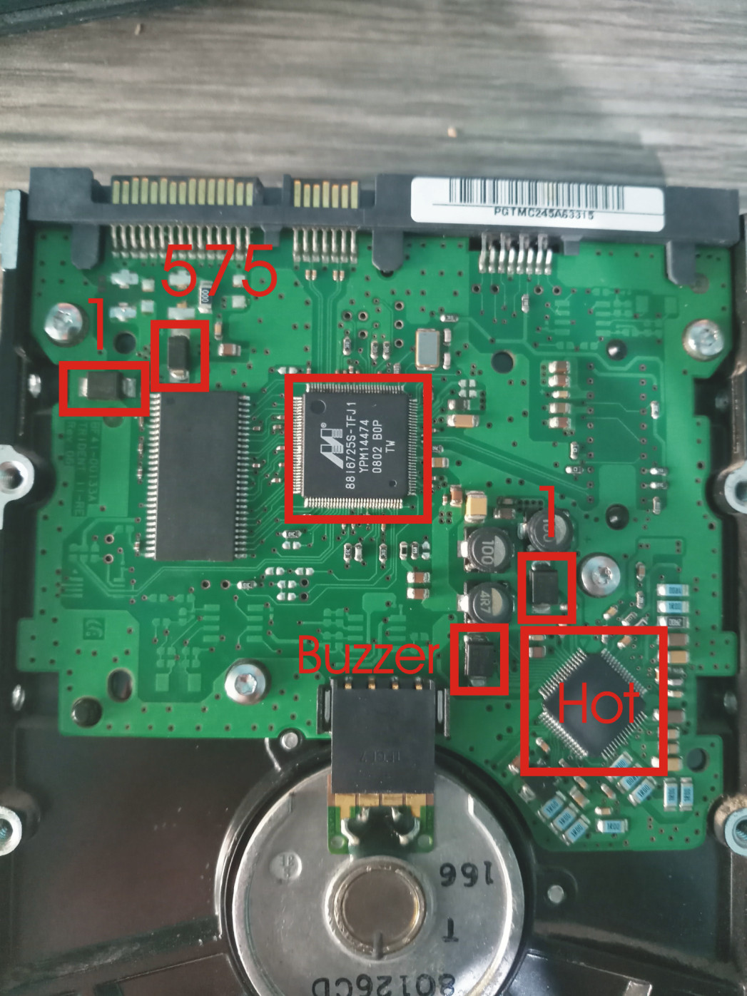

I have Samsung HD320KJ Hard Disk. It has Spinning problem. When put on the system, after some time PCB and Hard Disk get Heating, but not spinning at all. i attach pcb diode reading. Please help me. It has valuable data in it.

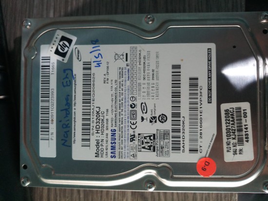

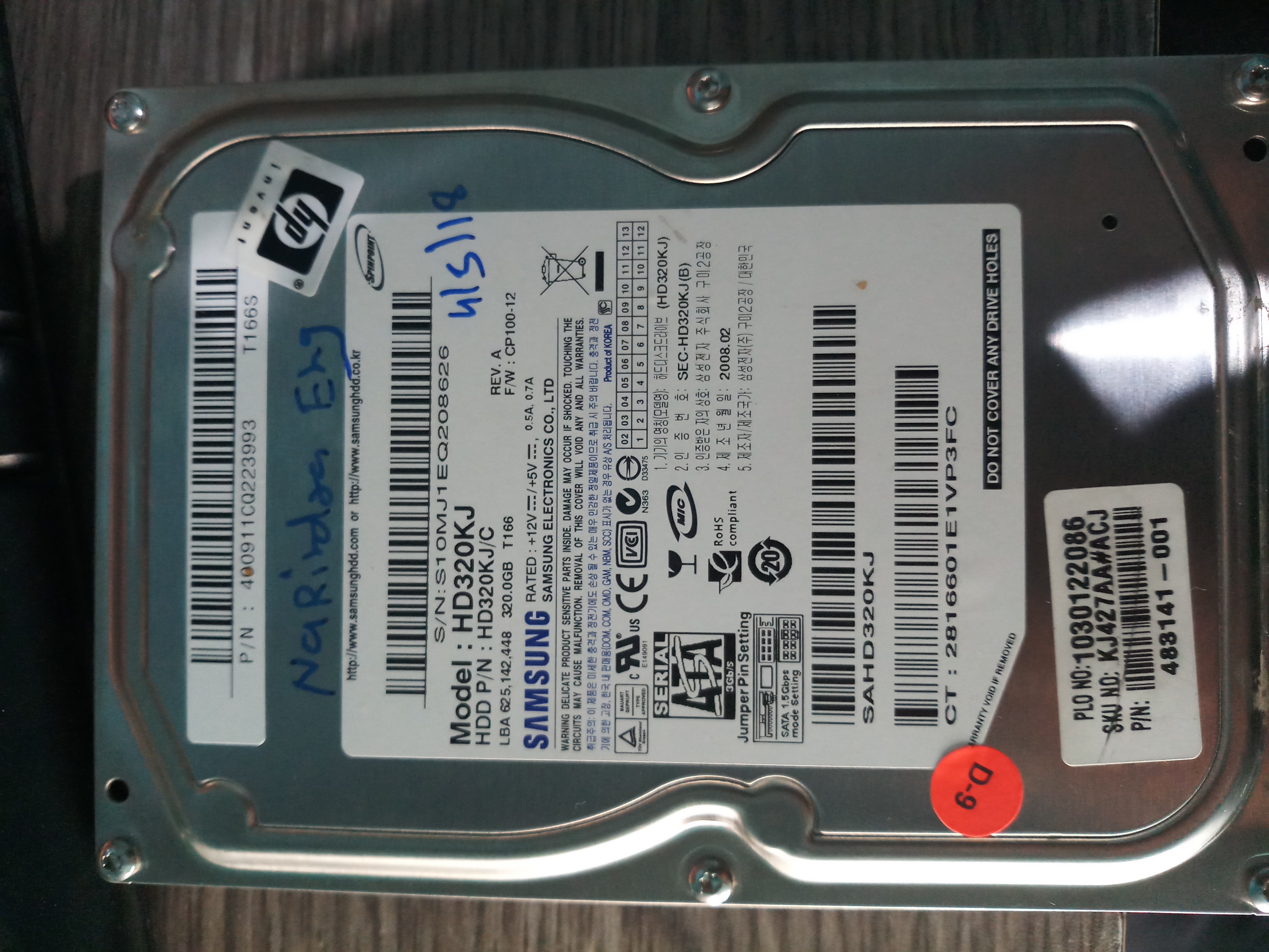

By the sticker in it, was it from an HP system ? How did the problem started ? Could be something PUIS-related, but waif for some other people to comment on that.
The readings on the diodes near the ram chip doesn´t make much sense. Please, measure continuity in them, both ways, with the hdd disconnected from power.
Also, does the motor controller gets hot ?

Thank you Sir for ur kind reply.
MCU and Motor Chip got Hot enough. but only motor is not running.

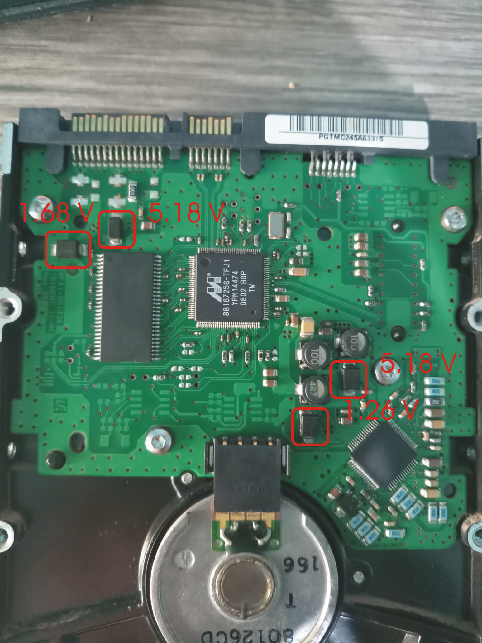

Attch pic of continuity measure.

The measurements still seem wrong. But if the motor controller is gettin hotter than normal, them possibly it is damaged.
You will probably need to find another board with the same code and preferrably the same firmware version. The code below the number "1" at the left side of your picture.

3 - If you can't ear any sound and if you can't get any terminal LOG just BUY a PCB from another drive of the exact same model with exact same firmware.
You do have firmware version on the LABEL so get a drive like yours - HD320KJ/C with firmware CP100-12 and you don't need to move any ROM or adapt any firmware overlay, just swap the PCB and you are done.

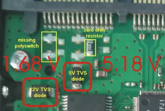

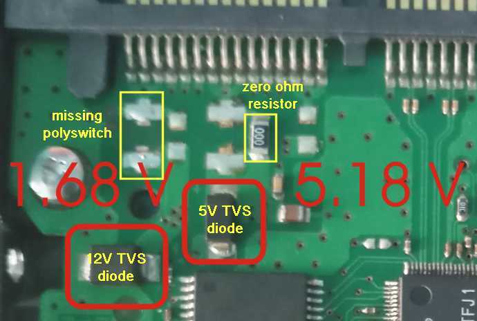

No 12V power is getting to the PCB. That's because there is a missing polyswitch. If the PCB is otherwise OK, just replace the polyswitch with a wire link (or picofuse).

The motor controller looks discoloured.
you are right fzabkar. i removed polyswitch because of it had a problem. with faulty polyswitch, system did not start. i removed polywitch and connect hdd system start but no vibration or any known sound output from hdd. if i replace this polyswitch with good one will hdd start in normally? and i want to tell that without polyswitch switch all chips on the hdd got hot.
Why would you think that an electronic device would continue to function after removing a fuse?

You removed the wrong component. Search this forum for TVS , and you will find a lot of information.
Basically, put back the poliswitch and replace the TVS diodes, after you have searched and read the other threads.
