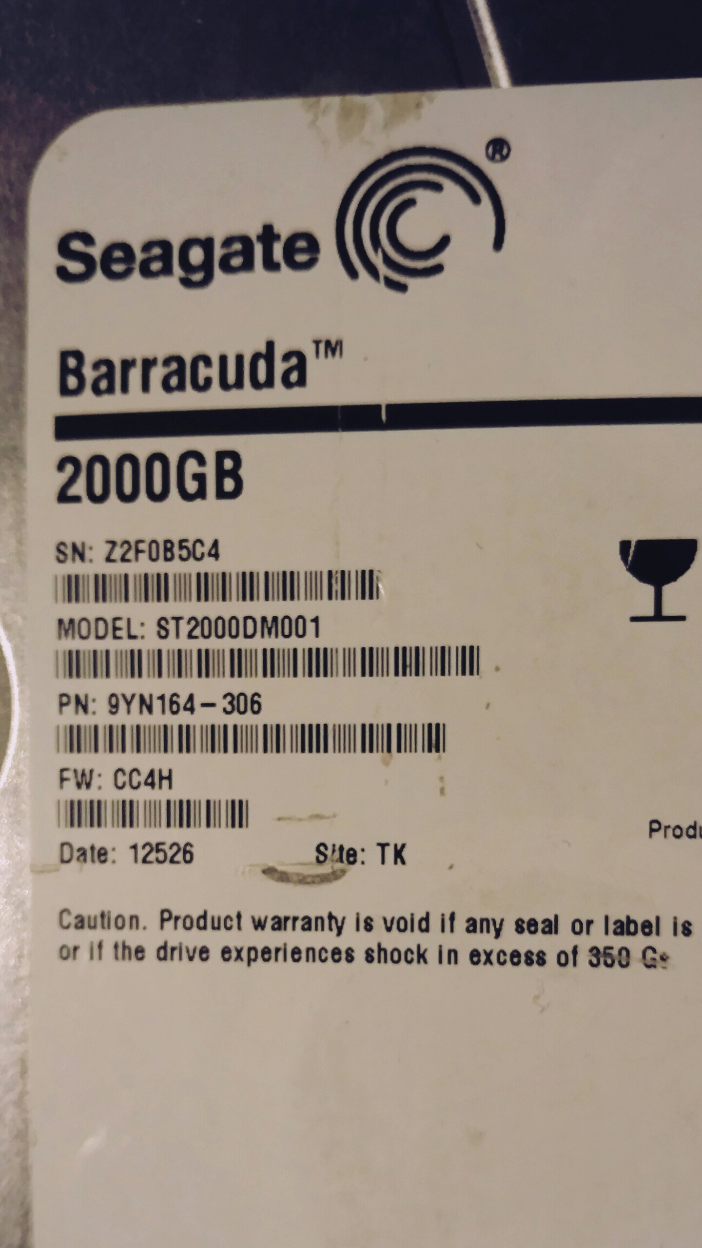

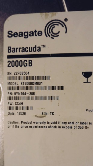

This is my patient hdd
File comment: Patient

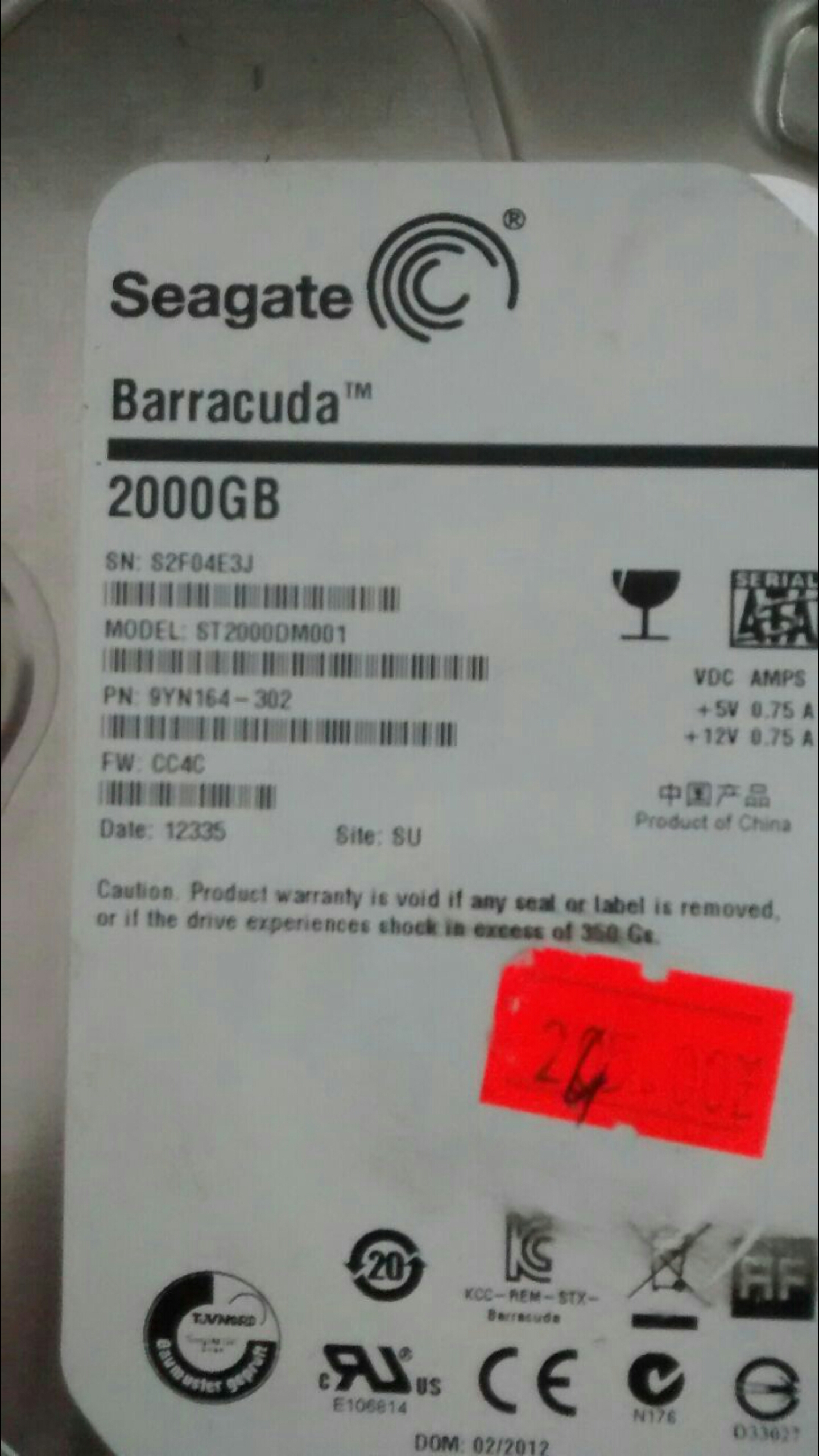

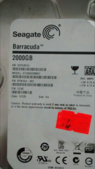

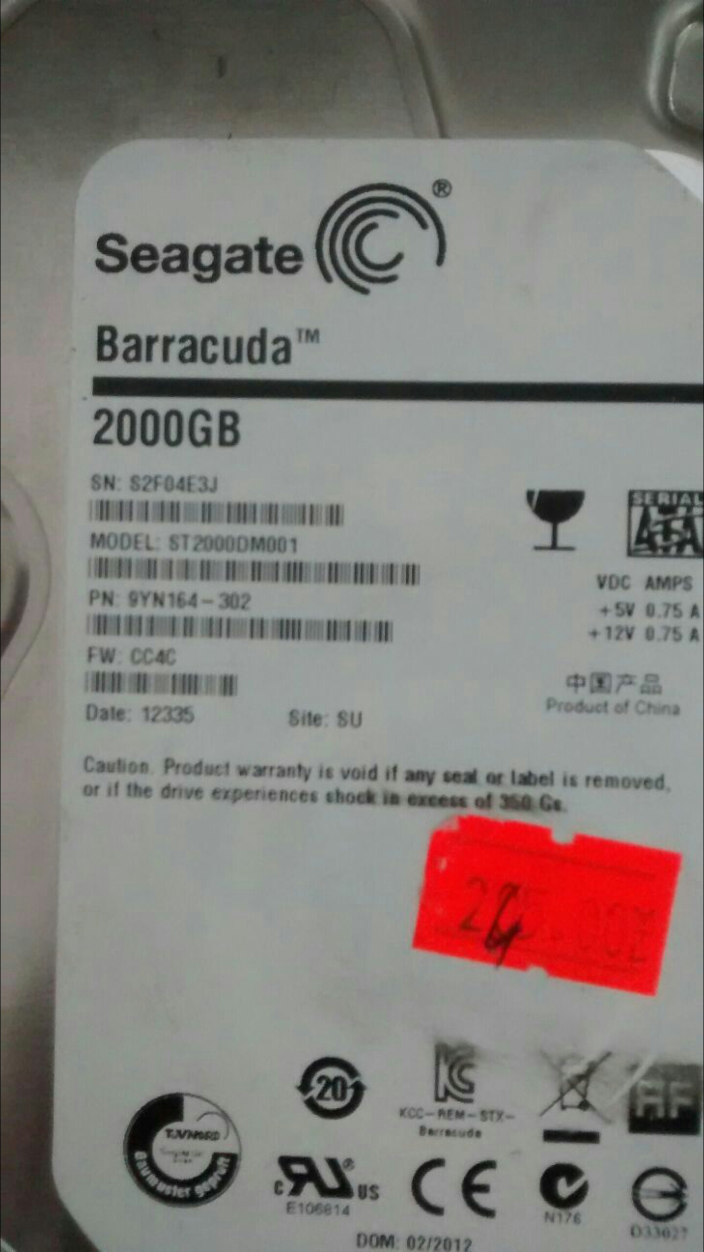

Thia what can i find for donor.
Model no match 2. and 3. number of S/N is match which means plates and heads number ok. Should i buy it? İs worth taking the risk.
 Post subject: Re: Seagate Part Number Description
PostPosted: February 6th, 2018, 10:33
Joined: February 5th, 2018, 8:13
Posts: 15
Location: Tel aviv
Donor HDD
File comment: Donor

this is definitely not compatible for donor.

SN of the patient drive : Z2F
I do not think that the models in the picture are compatible. Donor drive SN start as S2F
I do not think it will be the right choice for me.
am i wrong?

preamp vendor is different.

I've just worked on one of these. There was decent compatibility between S2F0 and Z2F0 drives. A good recovery was made. It was not necessary to import the head-adaptives into the the ROM.
The physical head map on these disks are 1,2,3,4,5.
For reference, the patient HDD was:
ST2000DM001
SN: S2F0....
9YN164-500
CC4B
SU
Donor was:
ST2000DM001
SN: Z2F0....
9YN164-302
CC4C
TK
I hope this helps.
