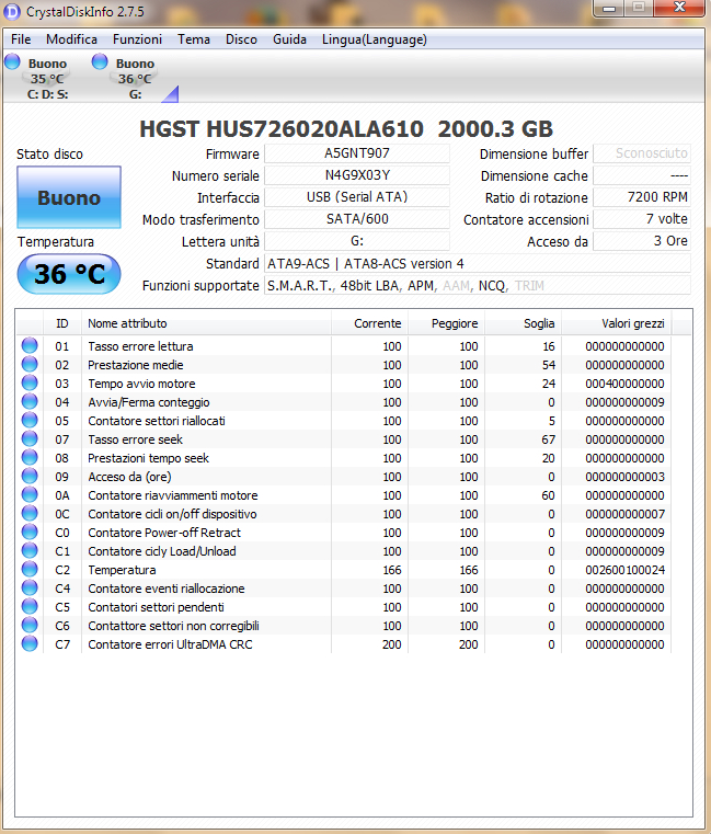

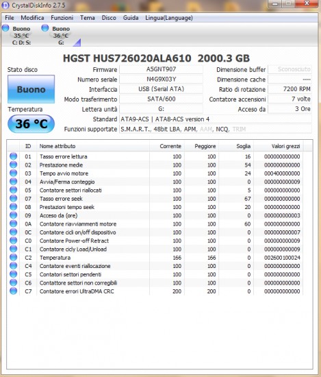

I bought this hard drive, brand new, HD Hitachi 2TB 3,5" SATA3 HUS726020ALA610 2.60 (Ultrastar)
It is mounted on a ext. case 3,5" LC-Power LC-35U3-Becrux, connected to the pc by 3.0 Usb port
Please help me to understand whether it is appropriate to open an RMA procedure. I got it from an online retailer. In that case I have to send it back.
Many thanks for the help!
Since the first ignition it has always made this suspicious noise - link to the video https://drive.google.com/file/d/1qvPRP3lb4aCFAyd4FgH6lk0LFoxFUXGF/view?usp=sharing please turn up the volume of the player
Explanation of the video: Up to the first 10 seconds, the hd is ON, the engine runs silent, but is not connected to the PC. Once connected to the PC, the reading operations begin: it is possible to hear a "dry blow" for 5 times alternating with a continuous "tc tc tc tc tc tc tc tc tc", or, "tr tr tr tr tr tr tr", as you prefer. In the last seconds of the video you can hear the solitary "tc tc tc tc tc ..."
It is precisely the continuous and infinite "tc tc tc tc tc tc tc ..." that worries me: the noise inside the HD from what it comes from?

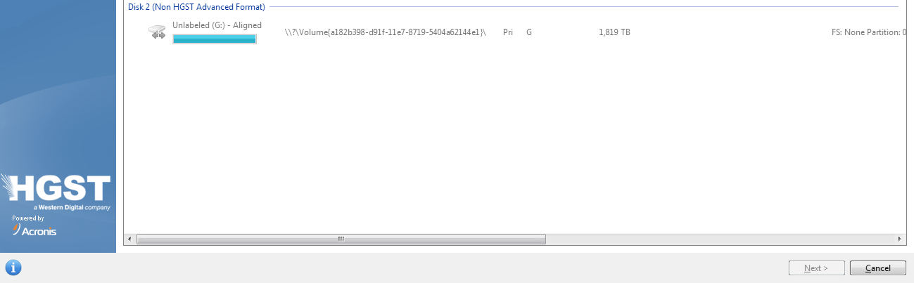

The dealer's assistance told me that it could be an alignment problem, but it is not reported by the software I used to diagnose (please, see attached images).
Thanks for your help
File comment: HGST/Acronis tool
File comment: Crystal Disk Info

Does it work ? Does it pass ok in the manufacturer´s utility test ?
If not, ask for a RMA. If it seems ok, keep using it and make backups.

I overlooked the part about it being in an usb enclosure. Since most of these and their power supplies are suspect of low quality, it really is better to connect the hdd directly to a sata port to do testing.
I prefer to use the OS to partition/format hdds, but that should not influence the behaviour of the hdd. It *may* be a case of the external enclosure not supplying enough energy to the drive.
For peace of mind, I think you should RMA it. And , if possible, as you have to use external disks, either get a NAS for storage, or a disk specifically made for usb connection ( like, those by name brands, like WD, even Toshiba I think has some ) . Not an aftermarket usb case.
