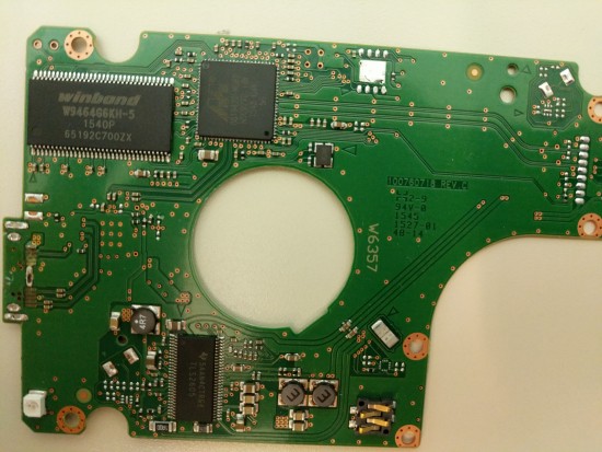

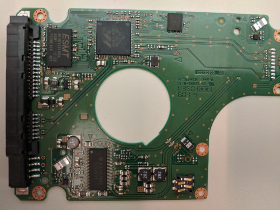

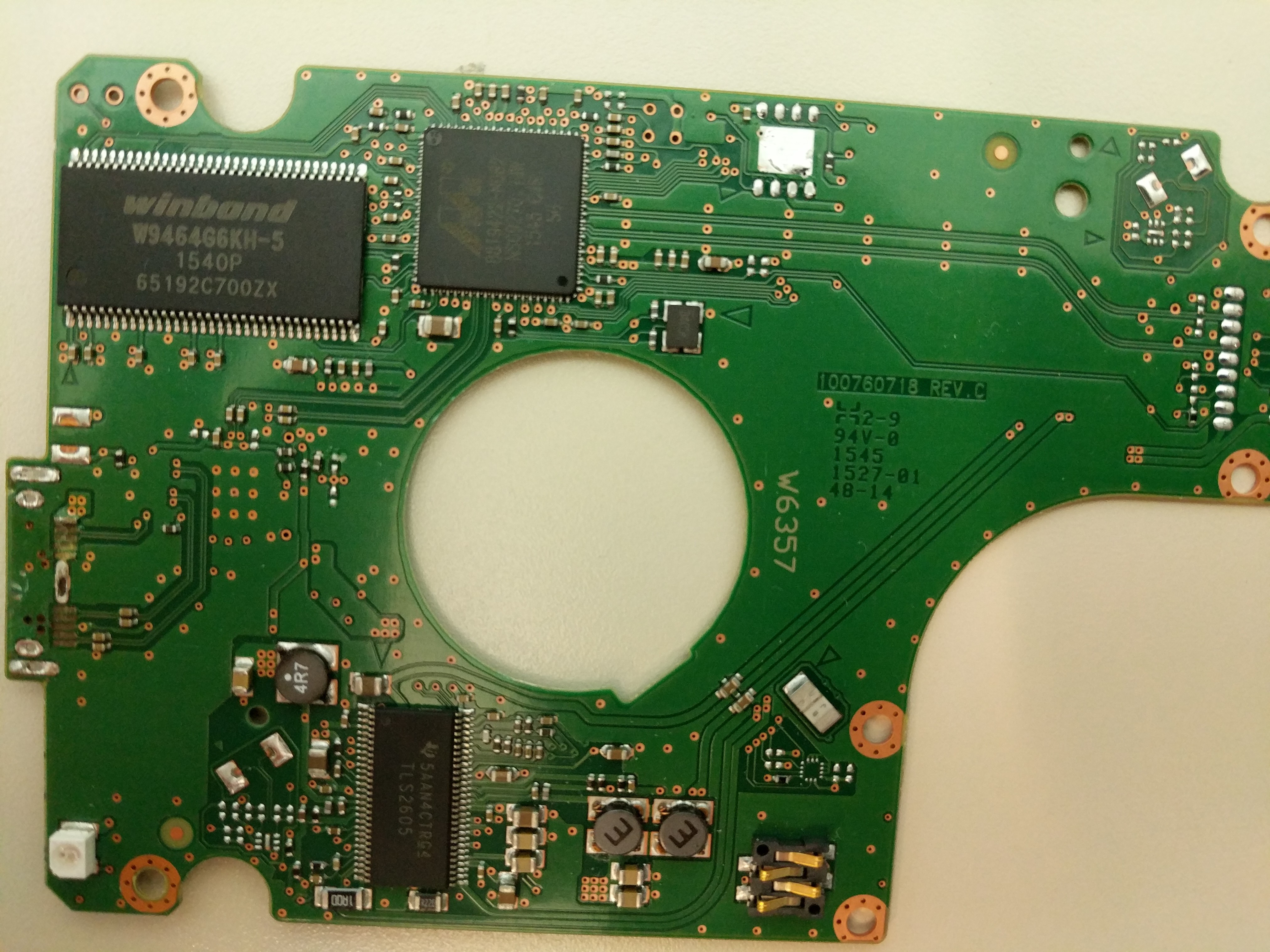

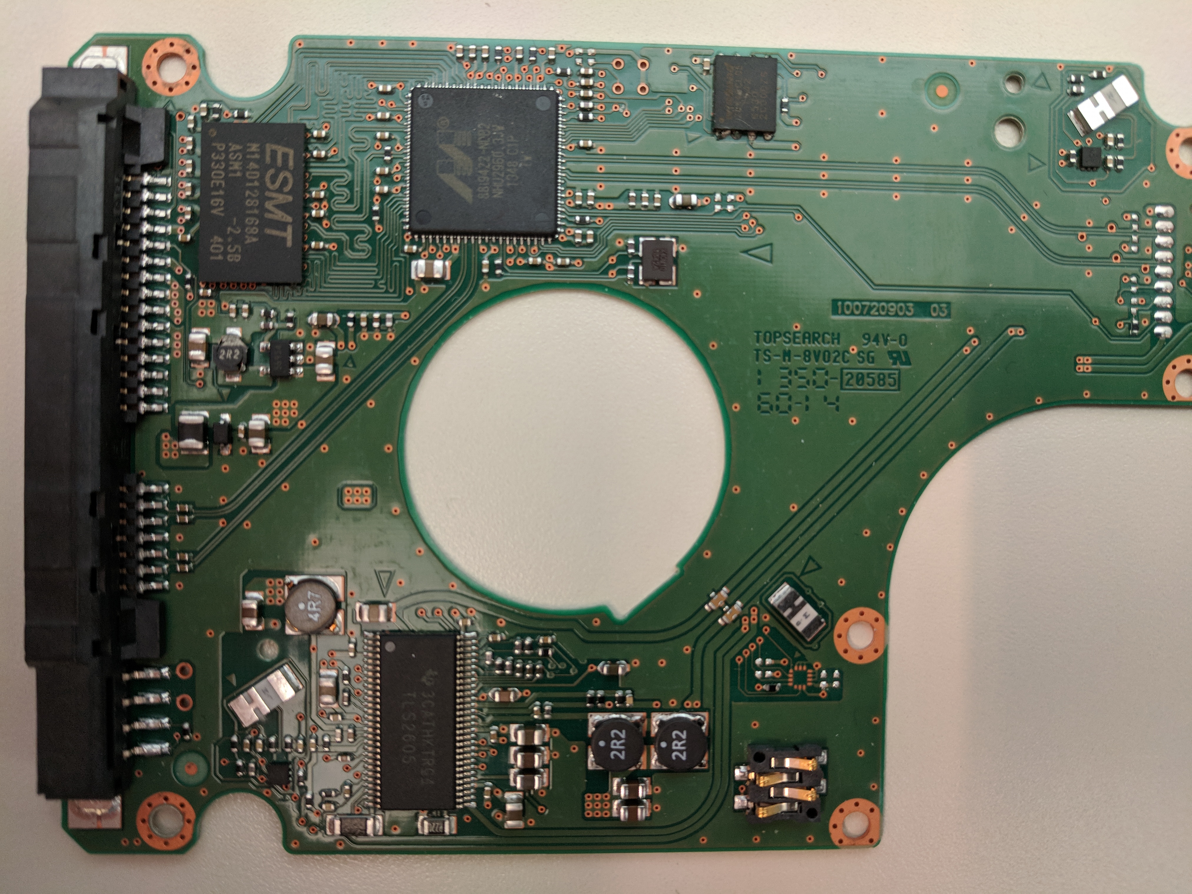

Hello, just need some help with a PCB board I am attempting to fix.
I have a 100760718 REV. C pcb that is from a student's hard drive where I work (Seagate ST1000LM025 / HN-M101ABB/ESA). The pcb usb 3.0 micro port was completely busted and now I had attempted at a donor pcb 100720903 03 and I have swapped the firmware chip but the drive doesn't spin at all. The main chip above firmware chip does get warm when I attempted to power the hard drive. I was hoping for assistance if possible on some further steps others with more experience would take.
Thank you very much.
File comment: pcb 100720903
File comment: pcb 100760718

That usb board is not difficult to repair. That could be a way to solve the problem.
Also, inspect again the soldering on the flash chip. That pin on the left seems shorted to its neighbour.

Thank you rogfanther, I had initially looked for the correct usb micro 3.0 connector but we had nothing locally available. I did have a donor board from a similar hdd available that is the pictured sata pcb. If you have any recommended sites to purchase the usb plug I can try that as well. Also, I will take a look at the solder on the chip again. Is it safe to take the chip on and off a few times? I don't want to fry it and this specific fix is new to me so I figured I'd ask the pros. Thank you.
 Post subject: Re: PCB 100760718 REV. C Help
PostPosted: May 15th, 2018, 11:37
Posts: 713
Location: Brazil
I think you can find it from Digkey or Mouser. Even ebay or Ali Express, if you prefer.
Also, you could solder an usb cable directly to the corresponding positions, as it is just for recovery.
As for the chip, try to avoid heating it too much or too much times. Or, at least, make a backup of it before soldering it, just in case it is damaged in the process.

@polykyle, can you tell us the markings on the two "ROM" chips? I have a suspicion that they may be powered from different voltages.
Notice the differences in the SDRAM specs:
M14D128168A-2.5B, ESMT, DDR II SDRAM, 128Mbit, 2M x 16 Bit x 4 Banks, 1.8V, 400MHz:
http://www.esmt.com.tw/DB/manager/upload/M14D128168A(2M).pdf
W9464G6KH-5, Winbond, DDR SDRAM, 64Mbit, 1M × 4 banks × 16 bits, 2.5V, 200MHz:
https://www.winbond.com/resource-files/da00-w9464g6khb1.pdf
Below M14D128168A is:
ASM1 -2.5B
P330E16V 401
Below W9464G6KH-5 is:
1540P
65192C700ZX
Thank you again for everyone's help.

I can see those markings. I need to know the markings on the 8-pin chips that you worked on. I'm wondering whether the SATA board (donor) uses a 1.8V serial flash memory, in which case your 2.5V (? patient) flash memory may not work on the donor PCB (no damage, though).

ROM chip from original PCB:
25X40CL05
1542
6530
2C000ZS
Donor ROM chip:
25X40CL 1(or I)G
1350
6335
OU6004(or Z it's scuffed)S
Thank you Fzabkar.
PostPosted: May 16th, 2018, 15:31
Posts: 17231
Both chips have a voltage rating of 2.3V - 3.6V, so that's not a problem. The 128Mbit SDRAM must be using its own 1.8V supply. Sorry for the distraction.
