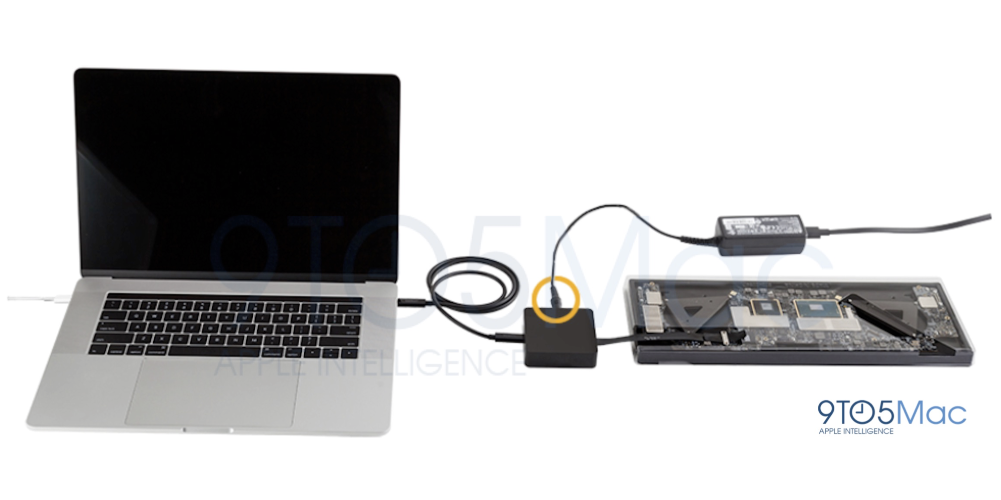

Apple tech has a special tool to recover data from Macbook Pro touch bar "non removable SSD" , anyone know where to get it or similar one?
https://9to5mac.com/2016/11/24/apple-sp ... r-repairs/

I believe it's made by Apple, so it should definitely work (if the SSD is good). It appears to just plug into the logic board on a special port and then connects via thunderbolt to another mac.
I may have to buy one of these myself and try it out.

Yes we did and it worked well.

There is couple of problems. No every mac can deal with it. I am guessing the ones with thunderbolt 4 only.

Looks like I am going to purchase one as well. But does not really look like it has been developed by Apple, at least when looking at the labels on the screenshots, it does not really look too authentic.
But if it works, it works.
DR-Kiev, do you mind sharing the models it has worked well with so far?
