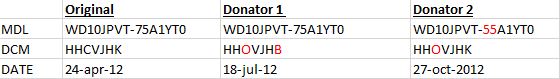

Need new heads for a drive but having trouble finding a perfect match.
Could anyone help me choose and perhaps tell the difference between these two donors?
Thanks!

both are good for me
Thanks for your input! :good:
Agree

my opinion donor 2 is better but however you can test with change adaptive setting module
