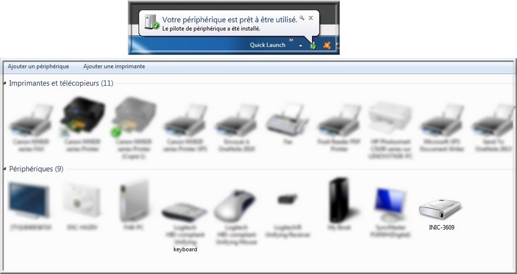

I tried to connect using my USB adapter.
At the beginning my Windows 7 install the driver, but then I don’t see it in the file explorer.
When I look in the devices, I can see it few seconds and then it disappear.
I also tried on other computers without any success.

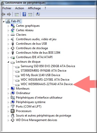

also visible in the device manager:

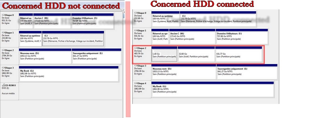

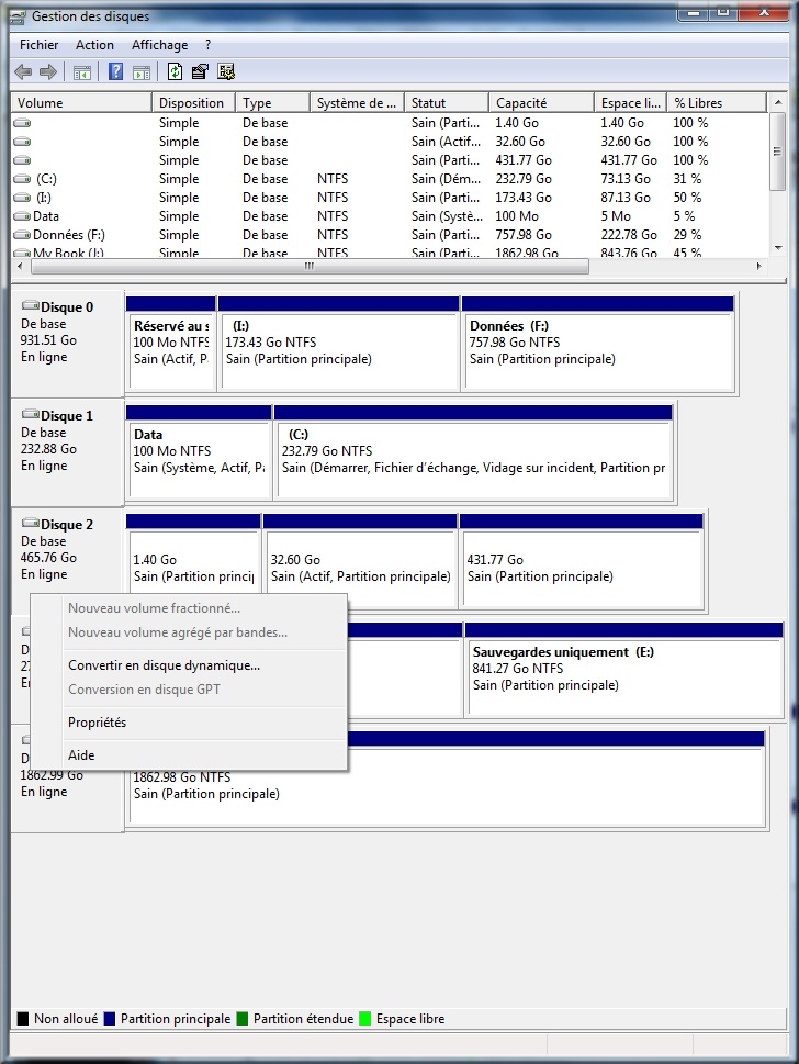

and in the disk management (but not with the correct size ??)

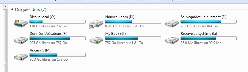

But still nothing in the File Manager:

You don't connect +12V and +3,3V.
USB Adapters can't have +12V and +3,3V and that's why you cant detect your drive via USB Bridge.

That usb cable is only for notebook drives.
If you absolutely need to connect the disk via usb, you will need an external enclosure, with its own power supply, designed for 3.5inch hdds.
The size of the hdd in disk manager is correct, and it is showing you the partitions. Depending on the way it was formatted/partitioned in the other computer, it may not show drive letters. Were you using linux or some other kind of OS ?

The usb adapter won't work with a 3.5 drive because the usb port you plug in to is unable to supply enough current to reliably power up the drive. Remember the usb port will typically supply 5v at between 0.5 and 1.0 amps which then has to be raised by the adapter to 12v to spin up the drive.
There is a simple solution which I use on a pc desktop system.
You need to buy in a sata extension cable. Modify the male end plastic connector to fit the adaptor. Then you need to connect the pc power connector to the drive with the modified sata cable. Plug the cable in to the usb adapter and then plug the adapter in to a usb port. Voila!

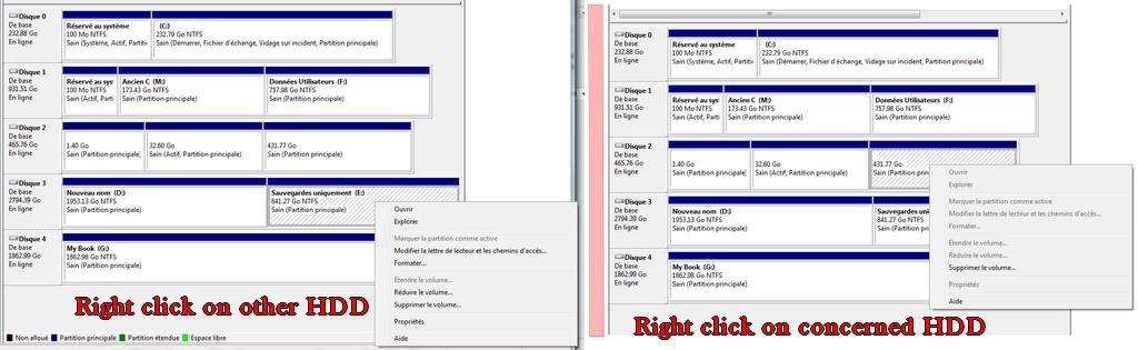

I tried.
I connected again my HDD in my computer and I can see again in the disk management
Unfortunately, when I right click on the largest partition, I don't have the option to assign a letter:

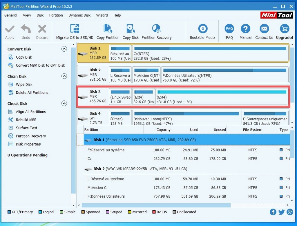

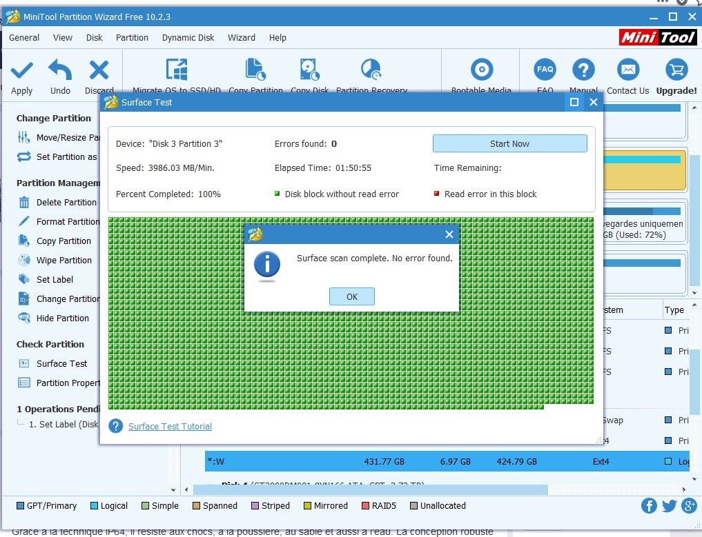

I installed the free version of MiniTools Partition Wizard.
There also, I can see my HDD

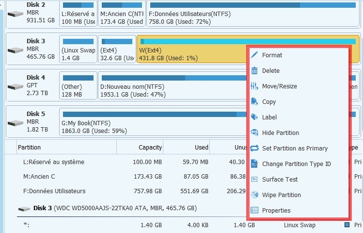

Then I performed a Surface test
There, I've been able to assign a drive letter to the main partition
but still not visible in File manager
Here are the other options of MiniTools Partition Wizard:
Any other thing I could do?

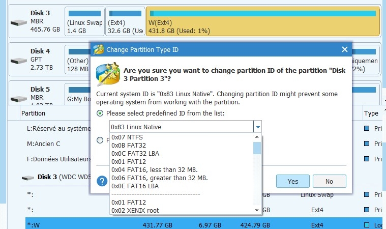

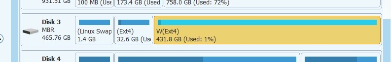

Not sure why, but seems that the partiton is Linux
Should I change it ?
Is there a risk to loose all the data's?
Fab

The drive is showing 3 partitions in windows disk management, but none of them are recognized by the type. This could be due to logical data corruption, the disk failing to read data due to bad health, the partitions are encrypted, or windows does not know how to read the type of partition (such as if the disk came from a mac computer). My vote is the drive came out of a mac (or maybe from a Linux installation), and windows just doesn't know how to read the partitions.

Was the drive originally in a Windows computer? If so, then at some point in time it would appear that someone installed Linux on it. Don't change the partition type. Don't do anything that would alter data on the drive at all. You will likely need to perform logical data recovery, and if you make any changes you will make your recovery chance less successful. I will let others that are more familiar with logical recovery software advise you further.

Seems like the drive used to be on a machine that was running some sort of Linux distro (likely), or the drive is coming out of some sort of NAS box.
It makes sense that Windows can't recognize the volumes, as Windows does not natively support Ext4 file system.
To access the files:
- need file recover software (e.g. R-Studio), or
- connect the drive to a Linux machine, or
- boot your a computer using a Linux bootable flash drive (e.g. Ubuntu) with this drive connected.

The MiniTool screenshot show it as a correct linux partition scheme ( swap plus two data partitions ). Understanding from where the hdd came can help to diagnose and eventually fix the problem.
