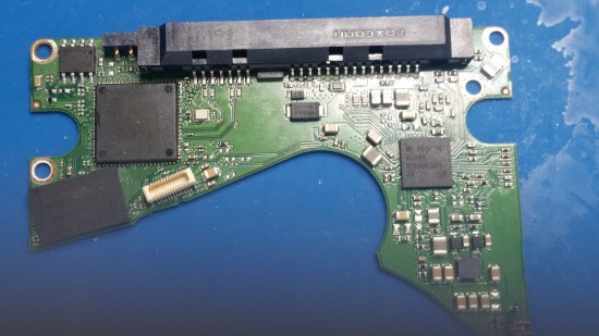

I have had a couple of these USB drives in recently where we have swapped the ROM over to a matching SATA board. Not an issue in itself, but I have recently had 2 SATA boards just stop responding after doing some work in PC3000 such as blocking SA, turning off heads etc. The 5v and 12v status lights come on, but the PHY and BSY, DRD & DSC lights do not light up and the drive no longer spins. I have re-written the ROM data back to the chip in a reader thinking it might be corruption, but get the same result. These SATA boards are either very hard to find or very expensive and I want to get to the bottom of the issue if possible.

Can you upload photos of both side sof both PCBs? I can help you test the voltages as well.

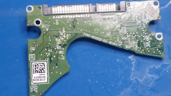

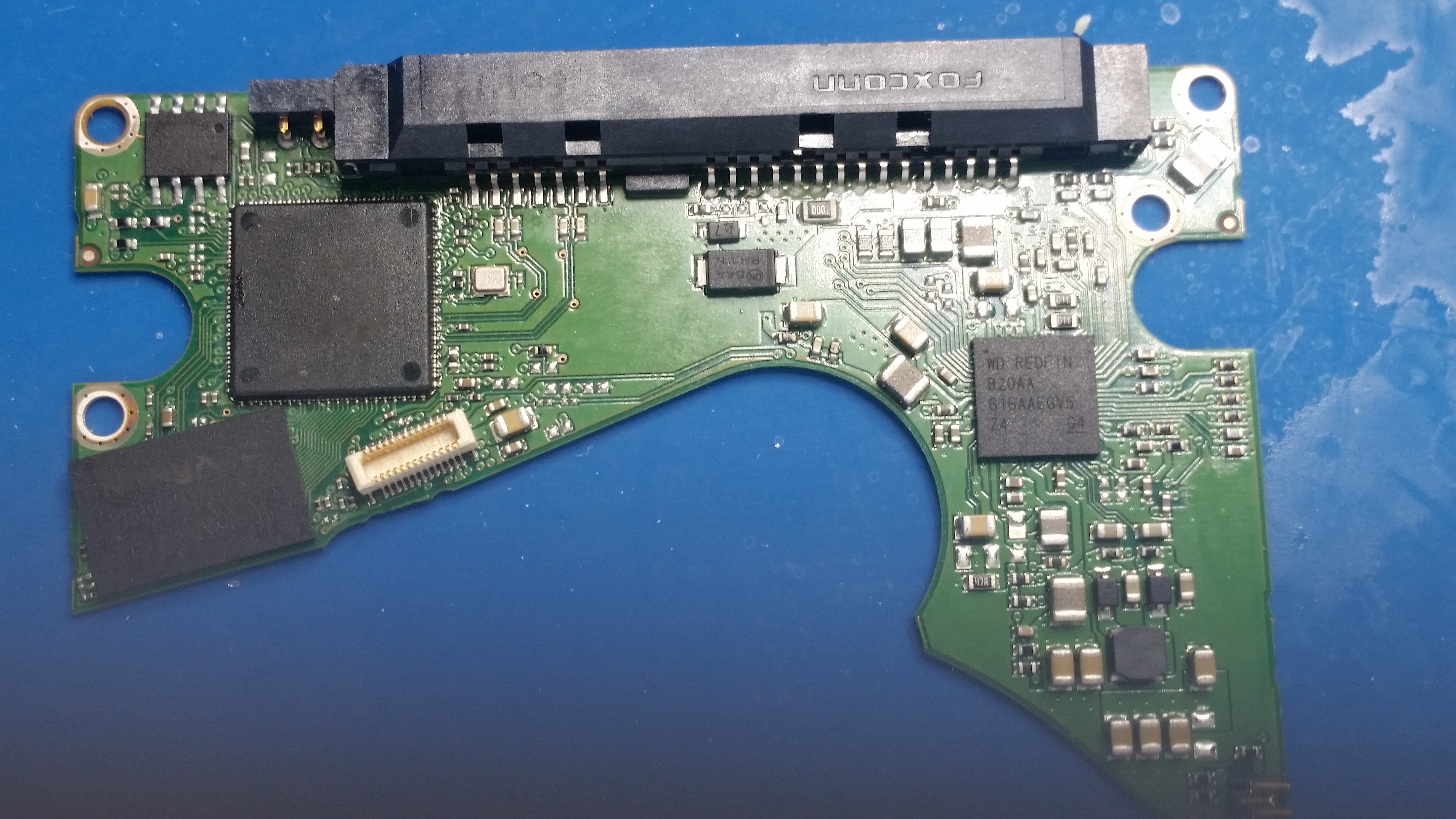

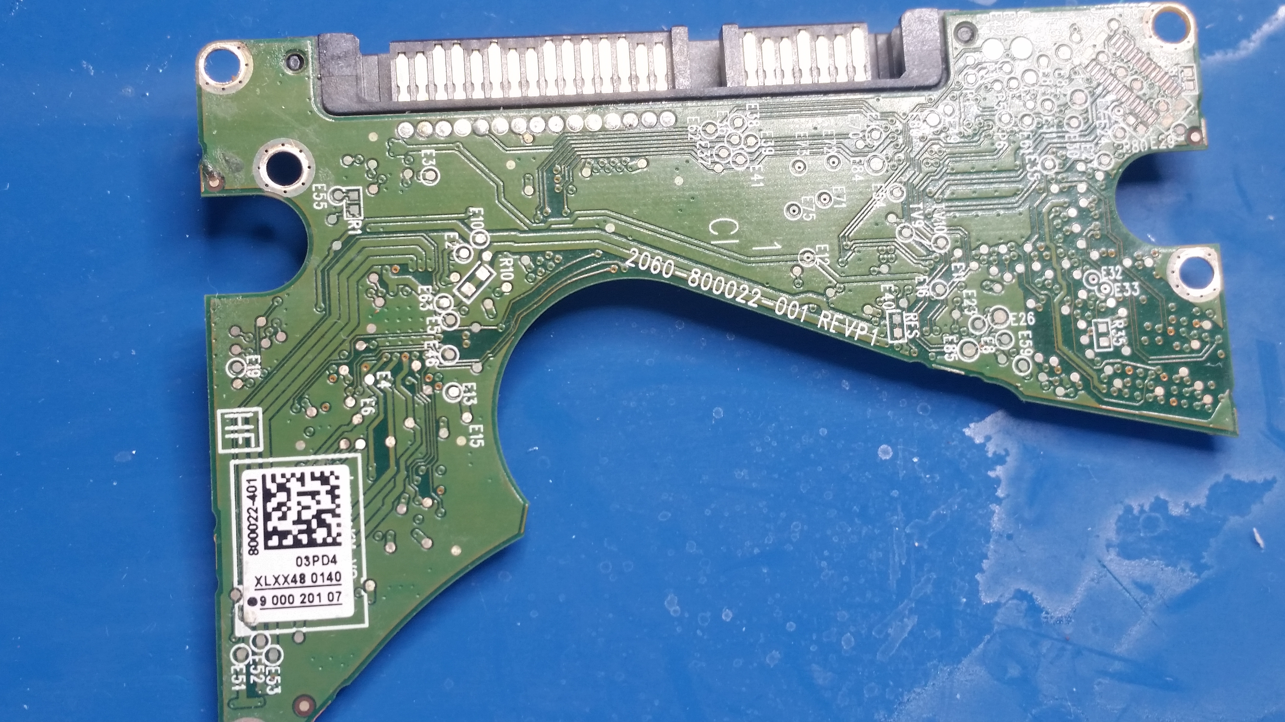

Can you upload photos of both sides of both PCBs? I can help you test the voltages as well.
Sure thing.
rogfanther wrote:
Which software do you use ? You could reprogram the rom in the board without needing to remove its chip
I have PC-3000. AFAIK there is no way to download the ROM from direct from this type of USB board (unless anyone knows different?)

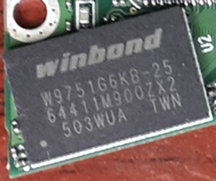

I wonder if it is a NAND memory problem?
Which chip would that be?
 Post subject: Re: WD40NMZW PCB Issues
PostPosted: March 28th, 2018, 14:12
Joined: June 8th, 2006, 19:44
Posts: 3144
Location: Atlanta, GA
The big rectangular one.
http://www.datasaversllc.com
PostPosted: March 28th, 2018, 16:11
Posts: 17324
Do you mean this big rectangle?
https://www.winbond.com/resource-files/da00-w9751g6kbg1.pdf
GENERAL DESCRIPTION. The W9751G6KB is a 512M bits DDR2 SDRAM, organized as 8,388,608 words × 4 banks × 16 bits.

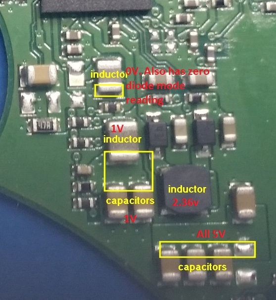

Posts: 17324

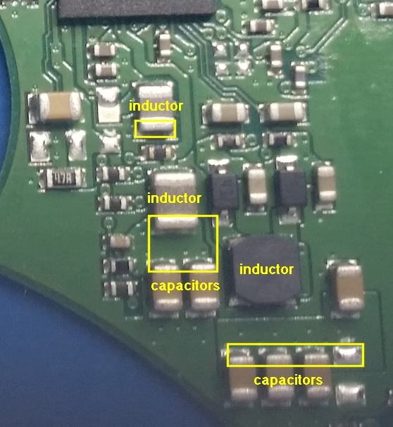

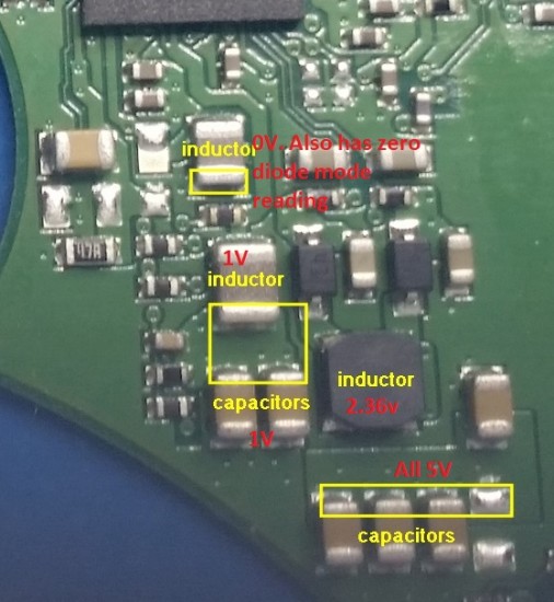

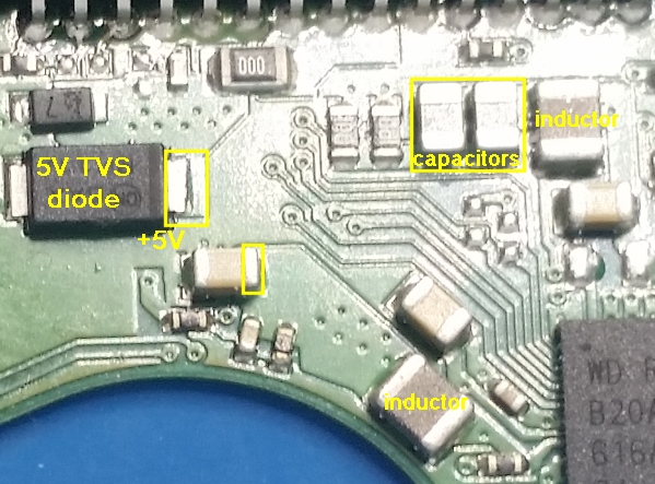

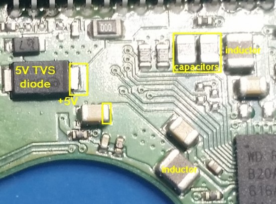

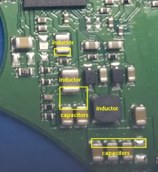

In the unlikely event that both boards have failed, I would measure the voltages at the inductors and/or capacitors.

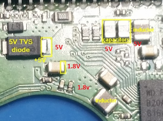

PostPosted: March 28th, 2018, 19:05
Posts: 1777
Location: Phoenix, AZ USA
Thanks for the help.

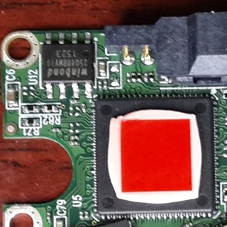

What is the code of the flash chip ? ( that would be the small, 8 legged one near the screw hole, right ? )
@jono-ats, can you get a dump ( by external programmer ) from the chip in a killed board ? And a dump of one chip from a working board ? Maybe comparing both we could discover something.
Also, in a damaged board to the OP, have you tried resoldering those components around the flash chip ?

Oh, could you post pictures for the identification of the original flash chip in the USB board, and the original flash chip in one of these Sata boards, if you still have them ?
PostPosted: March 28th, 2018, 20:15
Posts: 17324
@rogfanther, here are better photos:
2060-800041-000 REV P1 USB-to-SATA conversion:
http://i.imgur.com/LdT6YM8.jpg
http://forum.acelaboratory.com/viewtopic.php?t=9615
PostPosted: March 28th, 2018, 20:37
Posts: 713
Location: Brazil
Thanks Frank, would you have one from a SATA board with its original flash chip ? :)
PostPosted: March 28th, 2018, 21:29
Posts: 17324
This is the only photo (original resolution):
