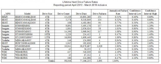

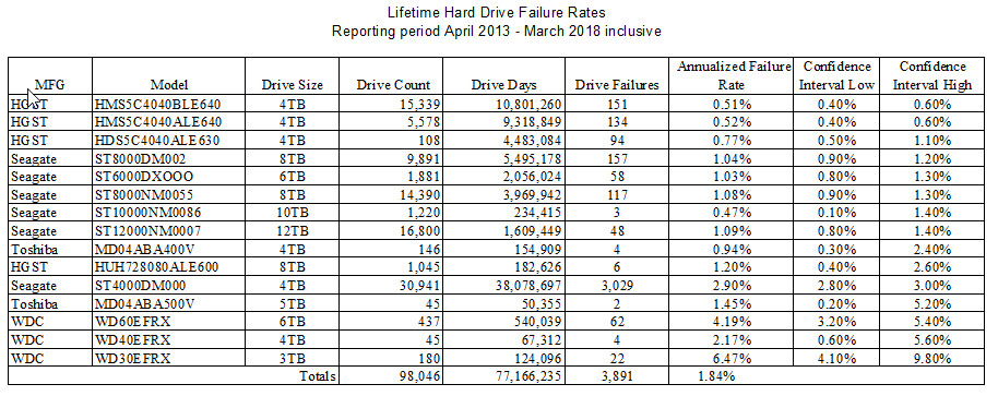

lorca wrote:
What is the overall opinion on the reliability of WD10EZEX? From time to time I read some complaints about them...
I don't know about that particular model but BackBlaze's 2018-Q1 report on reliability gives reason to be concerned. Here are the lifetime reliability stats sorted by confidence interval-high. Most reliable drives are at the top of the list.

@LarrySabo
It should be noted that the operating conditions for HDD used in the intensive environment of storage “pods” by an online backup provider are vastly different from those of drives used in a regular consumer environment, inside a computer case or an external enclosure. From what I could gather, normally such providers should use industrial grade models, but they opt for cheap consumer grade models instead so as to reduce the overall cost of operation, and so those drives may be stressed beyond their specifications, thus making those figures irrelevant (although it's still good to know that a particular model can withstand those heavy-duty conditions with a very good degree of reliability).
And it's also worth noting that Seagate drives, which have an abysmally bad reputation on this forum, have quite good failure rates this time (I've seen older Backblaze reports where the figures were reversed : Seagate drives had generally higher failure rates, up to 5-10% on some models, while WDC drives were all within 1-2%).
